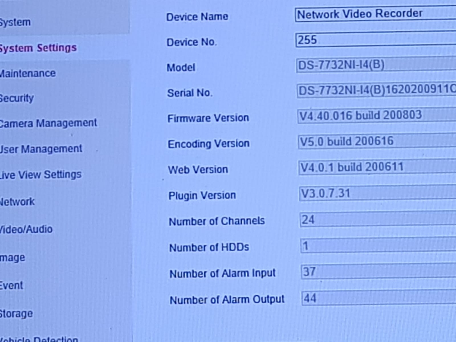

I ran into a problem with my 32 Channel Hikvision NVR that I wanted to see if someone could point me in the right direction.
I have a DS-773NI-I4(B)
However you can see in the picture that the Number of channels is 24.
When I tried to add an additional camera I am not able to and tells me I have maxed out my channels as I am at 24 cameras at the moment.
However this is a 32 channel NVR and that's what I purchased from my supplier.
Thank you.
I will also send an email to my supplier to see what they have to say.
I have never ran into the problem before.

I have a similar NVR but with POE ports DS-7732NI-I4/16P(B)
I checked the same system/system settings page on mine... it shows number of channels 11... I have 11 cameras connected so that setting must be showing the number 24 you have connected not the max number of cameras 32
That doesn't explain why you can't connect another camera though...
I'm pretty sure it has nothing to do with the issue you are having adding more than 24 cameras but the NVR firmware V4.40.16 build 200803 is a bit old.
The latest versions are V4.60.000 and V4.60.005 but I have had some problems with those so I have V.4.51.025 Build 210927 installed and all is good.
However, I wouldn't recommend changing the firmware without checking with your supplier and/or one of the experienced admins here...
Just to update everyone.
I spoke to my suppliers tech team and they told me to update the firmware.
This fixed the problem and I can now add more cameras.
So if anyone has issues loading cameras onto this type of NVR make sure to update the firmware to avoid this problem.
Thanks @johnfitzy for the info above also.
