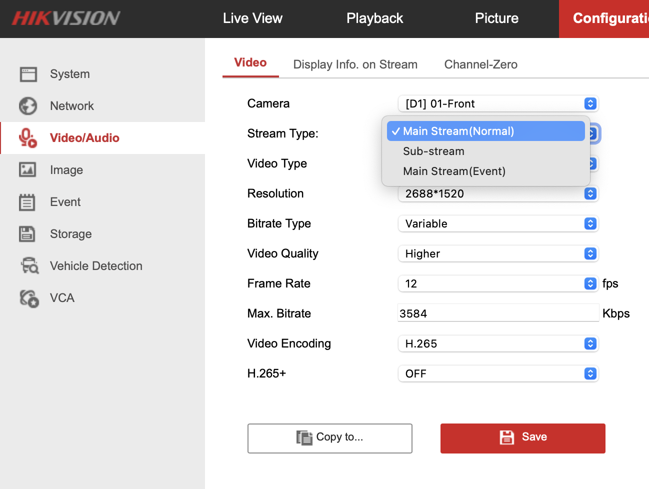

On the NVR in the recording settings there are Main Stream Normal and Main Stream Event - it's important that they match. If you go to Video Parameters and click the drop down you can see it. Select Main Stream (Event) and make sure the settings are the same as what they are when Main Stream (Normal) is displayed. It doesn't matter which you leave selected when you come out of the page as the settings are view only once saved. The below is a K series but the settings should look similar:

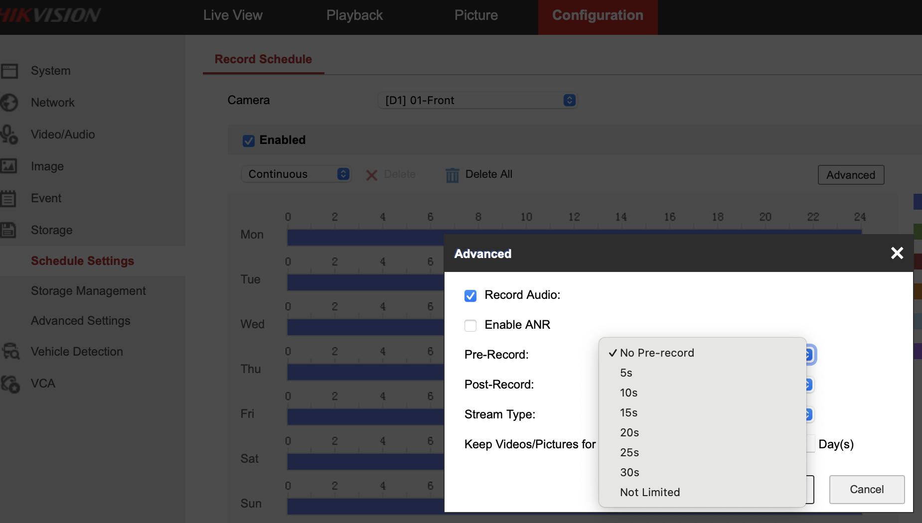

Set the 5 seconds pre record to 0 seconds click save, then copy to all cameras and save again. Pre record is unnecessary if you're recording 24/7 continuous. I've not see the issue you're having for some time but when I did, altering those settings resolved it. I'm not sure exactly why, possibly some additional recording being buffered. Never seen it on the M model so can only assume it's performance related.

5 seconds is the minimum for post event but it's usually 0 or 'no pre record' for pre record:

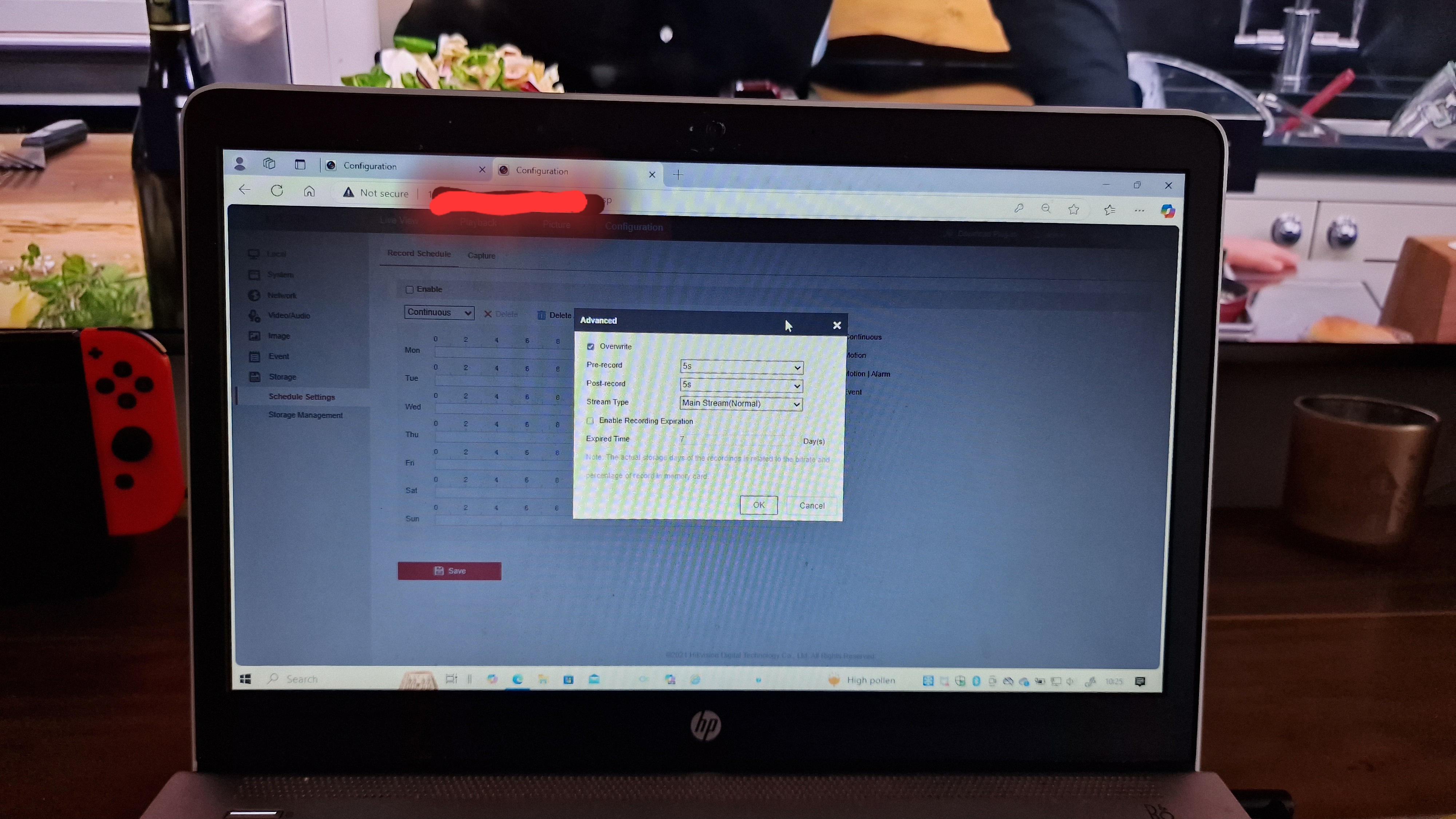

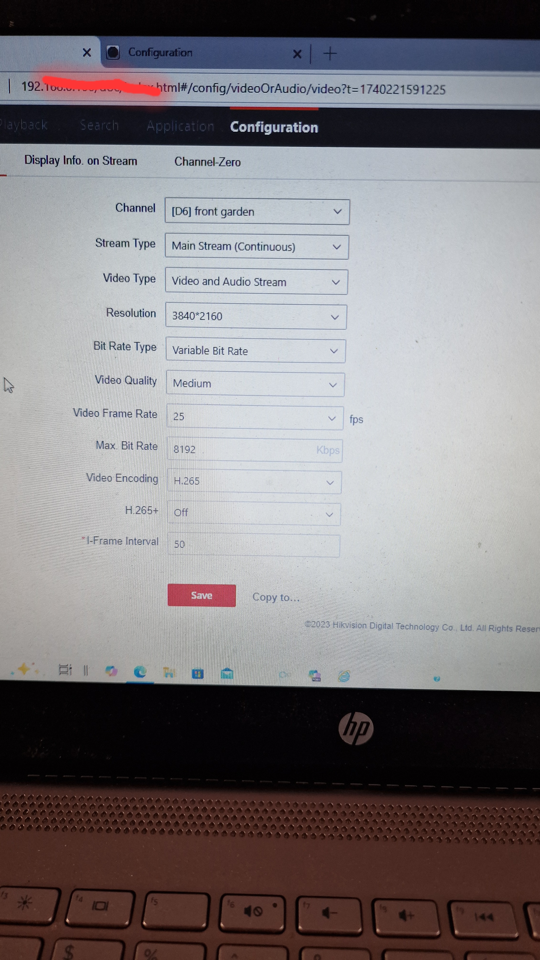

See attached. Can not drop below 5 secs as no option. Settings all look the same.
It doesn't look right to me, I think it's set up incorrectly.
You should have Main Stream(normal) and Main Stream (event) but you have Main Stream (continuous)? Your 24/7 recording schedule is not enabled. That box that's showing behind the pre event/post event popup should have the box ticked for enable and should be a solid block of blue for 24/7. It should be like that for all cameras on the system. To me it looks as though there is no recording schedule setup and you've started 24/7 manual recording.

What I'm saying is that it looks like you're recording continuously manually rather than scheduled. The image you posted is that it's not scheduled to be continuous as theres no tick in the box - selecting continuous on the drop down has zero effect unless it's ticked.
So i changed the main stream to event on laptop but when I went back it had reverted to continuous. Is that cause on the nvr it's self it's continuous? Does it need to be changed on that?
As I explained further up, the drop down on the browser UI does not change anything - it just displays the settings for that mode allowing you to alter them and save them for that mode, so nothing changed and nothing reverted back. 24/7 continuous recording should be set be enabled (with the tick in the enable box) and that continuous schedule will be painted solid blue. In your image the 'enable' box is clearly not ticked and the schedule is clearly empty.
