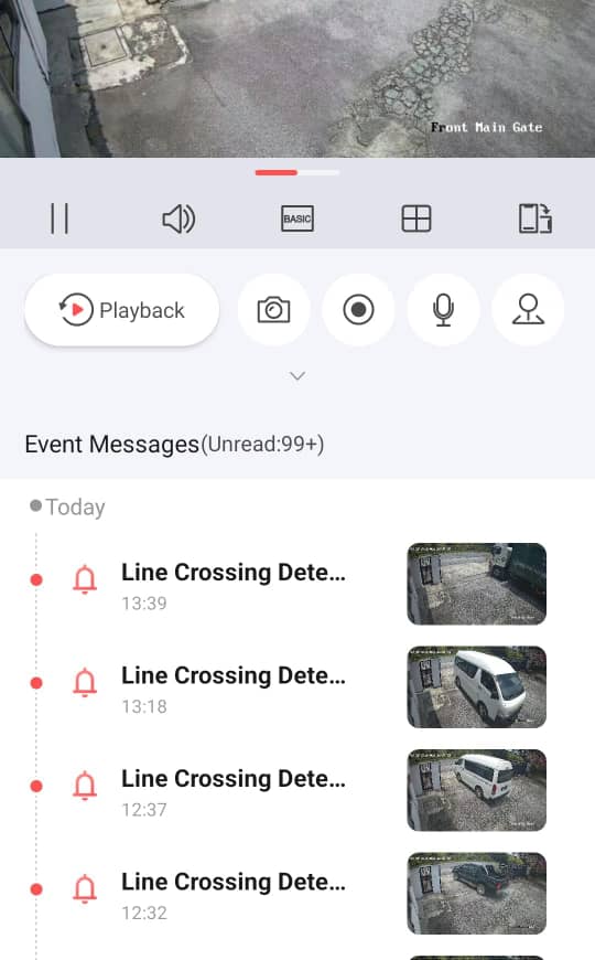

Hi, currently I'm using iDS-7216HQHI-M2 NVR with DS-2CD2043G2-LI but couldn't set up the features (line crossing detection with notification as shown in attached image) at the NVR. Please advise on this. Thanks.

The iDS-7216HQHI-M2 is a DVR not an NVR. It will allow IP cameras to be added but the camera won't necessarily be fully operable via the DVR (DVRs are primarily used with analogue cameras via coaxial cabling). On a DVR, the line crossing for analogue cameras is programmed on the DVR; as the camera is only sending a video stream, the DVR has to do all of the processing. With an NVR, the line crossing is (usually not always) done on the camera, with the camera doing the processing and sending alarm information back along with the video.
If the DVR won't let you apply line crossing to the camera, just login to the camera directly and program it on the camera. Similarly for notifications from that camera; if they're not triggering via the NVR, just add the camera directly to Hik-Connect.
