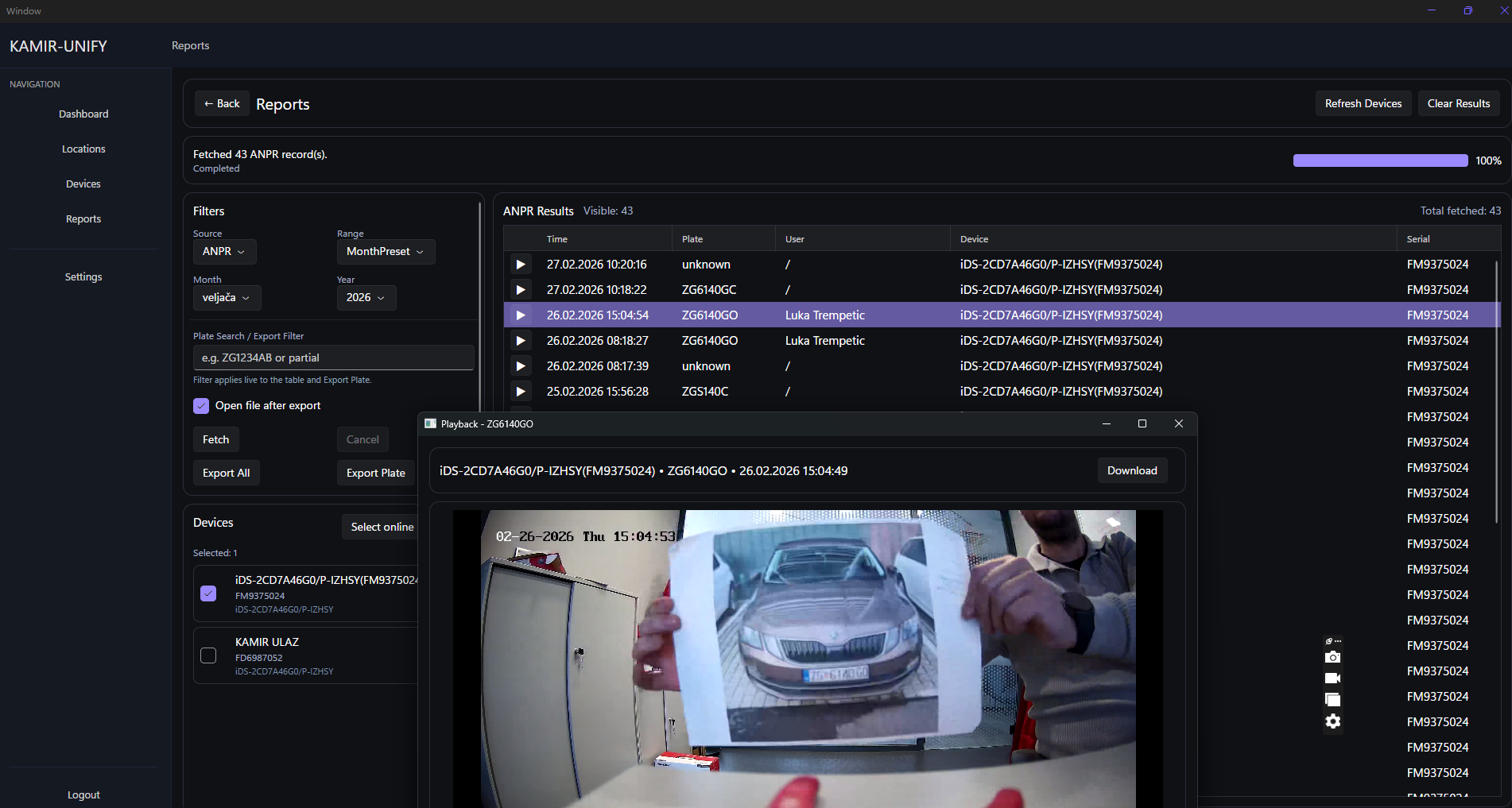

2. This model worked fine, i have attached raw output from data i received

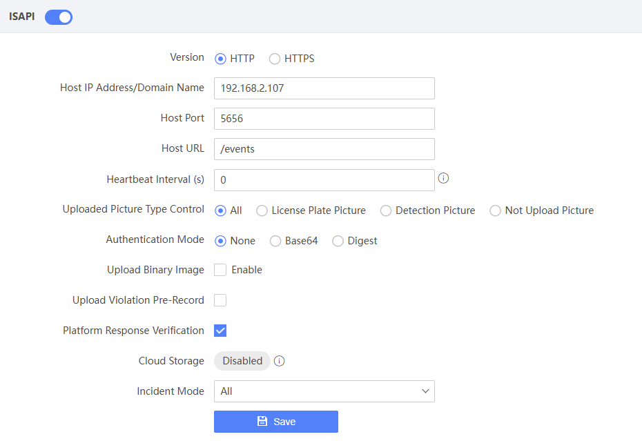

Configuration:

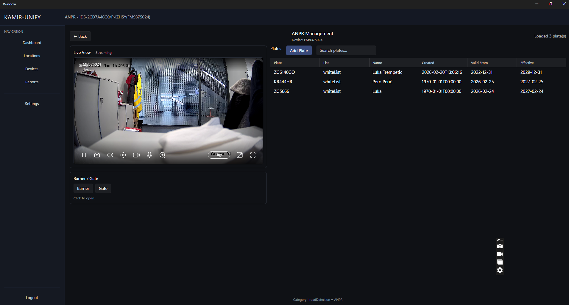

@trempa92 That Image you submitted looks like the interface on a TCM? I will need your help with my iDS-TCM403-BI

Yes that was my local ip for testing purposes
Image i submitted is indeed web interface of TCM camera. Unfortunately i do not recall on what firmware test was done. But it as newest during that time and i tested it this year January.
Perhaps RequestCatcher is not sending respond bytes to camera, hence no flow. If ANR is enabled, the data will loop until you send respond 200Ok(). Cant really speak as i never used that myself. I have my own server and local testing enviroment set. So i dont need such tools.

This is cloud solution by polling, So app can be anywhere and device doesnt need port forawarding. Simply connect to HikConnect or HikPartnerPro and thats it. I use both Hik cloud SDK's
