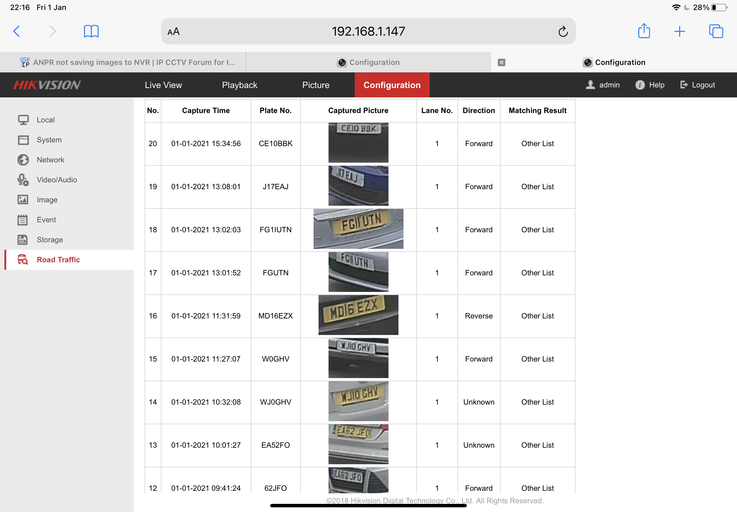

The ANPR is correctly configured and working and is capturing the number plate registrations as it is listed when I go to the camera web browser and click on the Configuration --> Road Traffic --> Real-time LPR Result and the max. 20 records are listed.
My issue is that the NVR is the saving the number plate images to the NVR as if I go to Picture --> Search then it says no pictures found.

The NVR I have (DS-7604NI-K1 / B) does not have the Vehicle Detection option under Configuration. This is where the problem is I think so now going to ask to change it to DS-7608NI-I2 / 8P.
