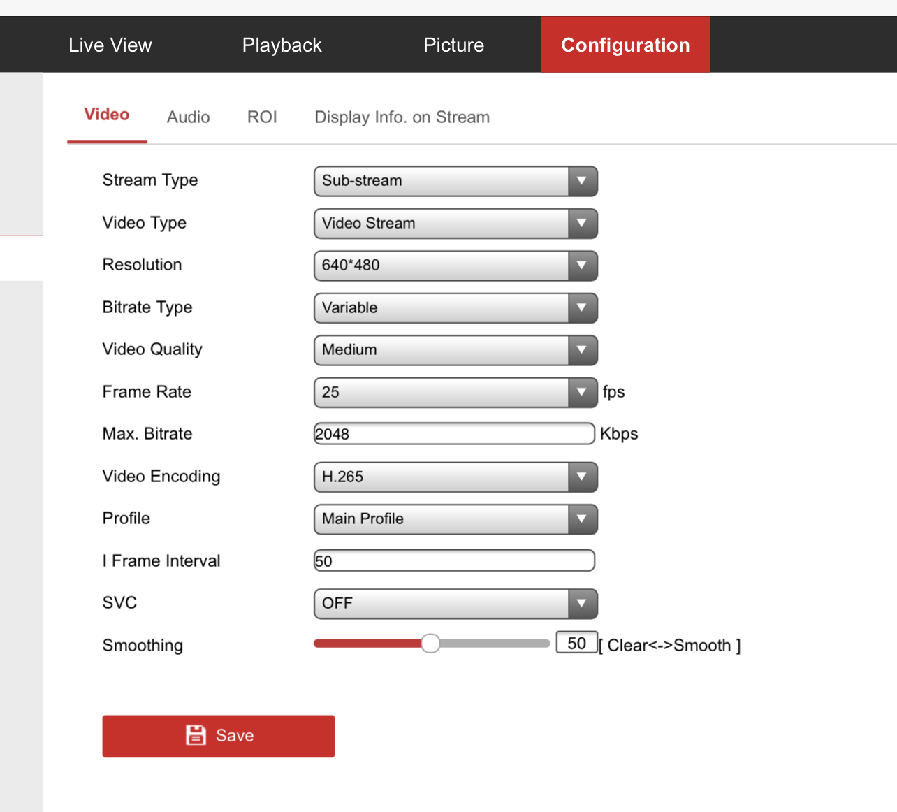

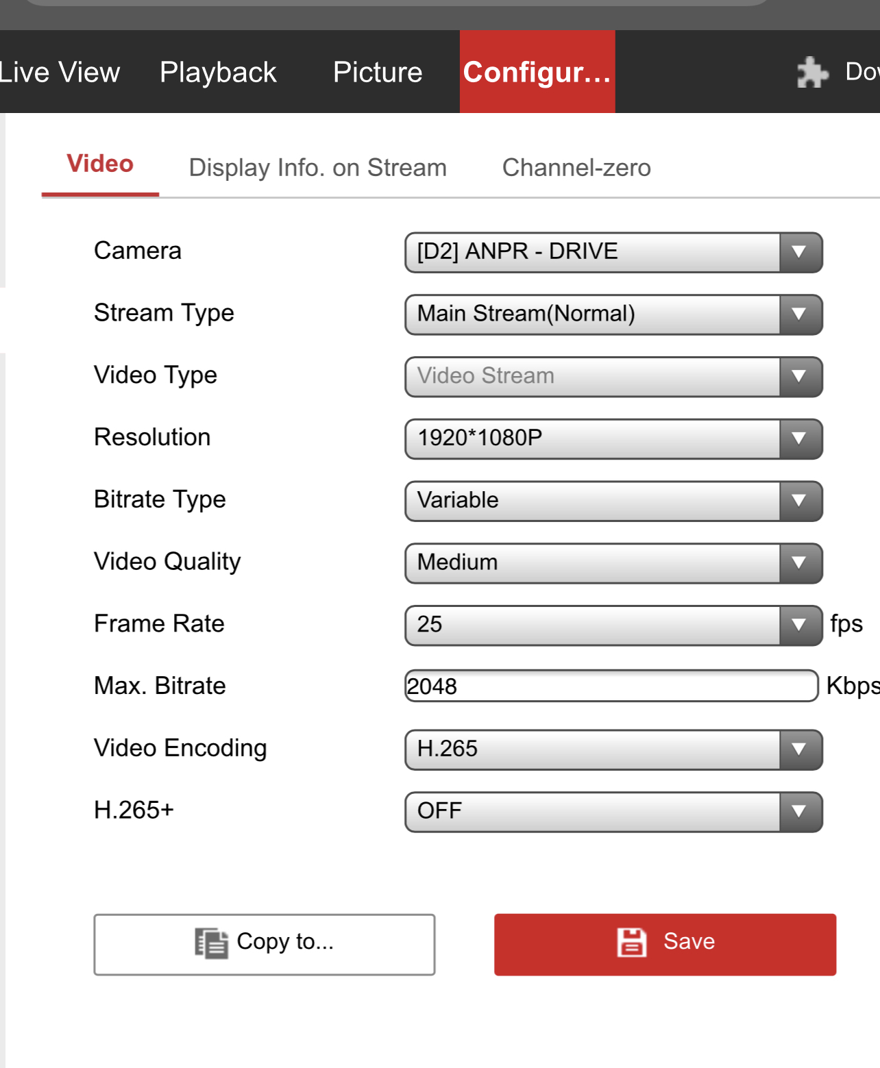

I have the following system recently installed and when viewing live footage on iphone, everything works perfect on home WiFi (virgin media) but I was getting unstable network connection messages when using my mobile date (Vodafone unlimited max).
After reading old topics on this forum I managed to tweak some setting and I don’t get the message but still sometimes get lags so just wanted to know if the following settings are ok for my cameras as shown in the screenshots taken from my NVR settings. The settings are also similar setup directly on the camera config aswell.
INVR model DS-7604NI-K1 / 4P(B) - firmware V4.30.010 build 200715
5MP Bullet camera model DS-2CD2685G0-IZS - firmware V5.6.2 build 190701
2MP ANPR camera model DS-2CD7A26G0/P-IZS - firmware V5.6.10 build 200703
I have turned off the H265+ on both cameras.
The attached screenshots show the mainstream and substream settings for each camera.
Appreciate your advice.

Hi @kmb786
Those settings are fine, but there should also not be an issue with running these 2 cameras at max. settings using H.265+ and still getting live view/playback in the Hik-Connect app. Often the reason people are seeing issues on mobile data is because of the way they added the devices to Hik-Connect, did you add the NVR with the IP address/QR code or did you add it with a port forwarded IP address or P2P/Platform access?
I should also point out that the bullet camera you have is actually an 8MP/4K camera and not 5MP, also it is running slightly old firmware so you may want to update that to the latest v5.6.5 firmware
(if the cameras are directly connected to the PoE ports on the NVR you will need to enable Virtual Host to access the cameras directly and update the firmware)

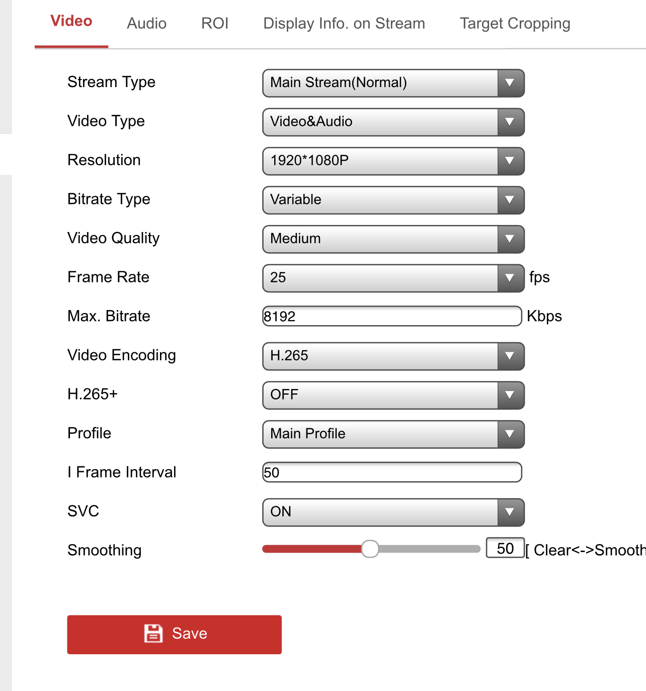

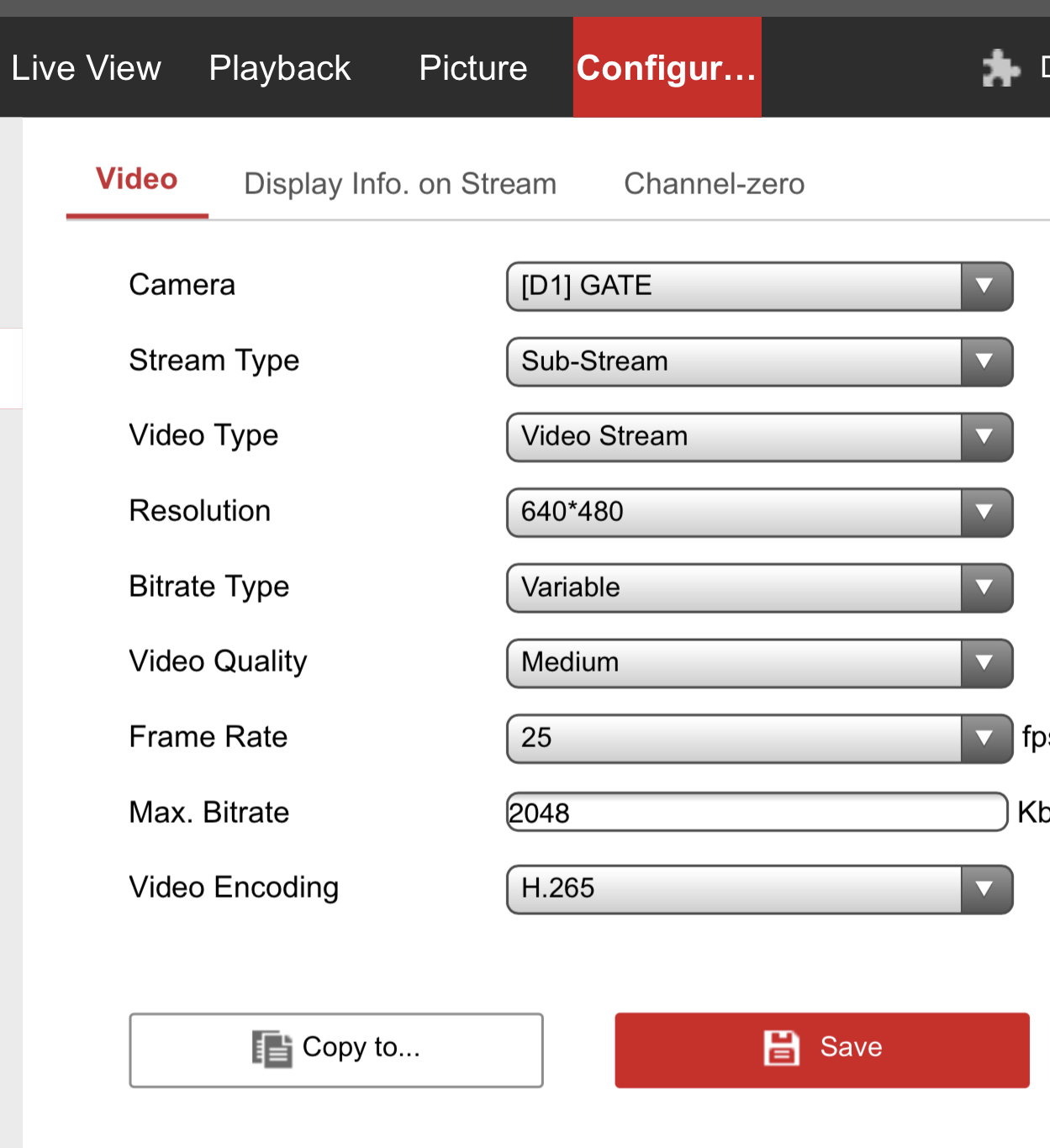

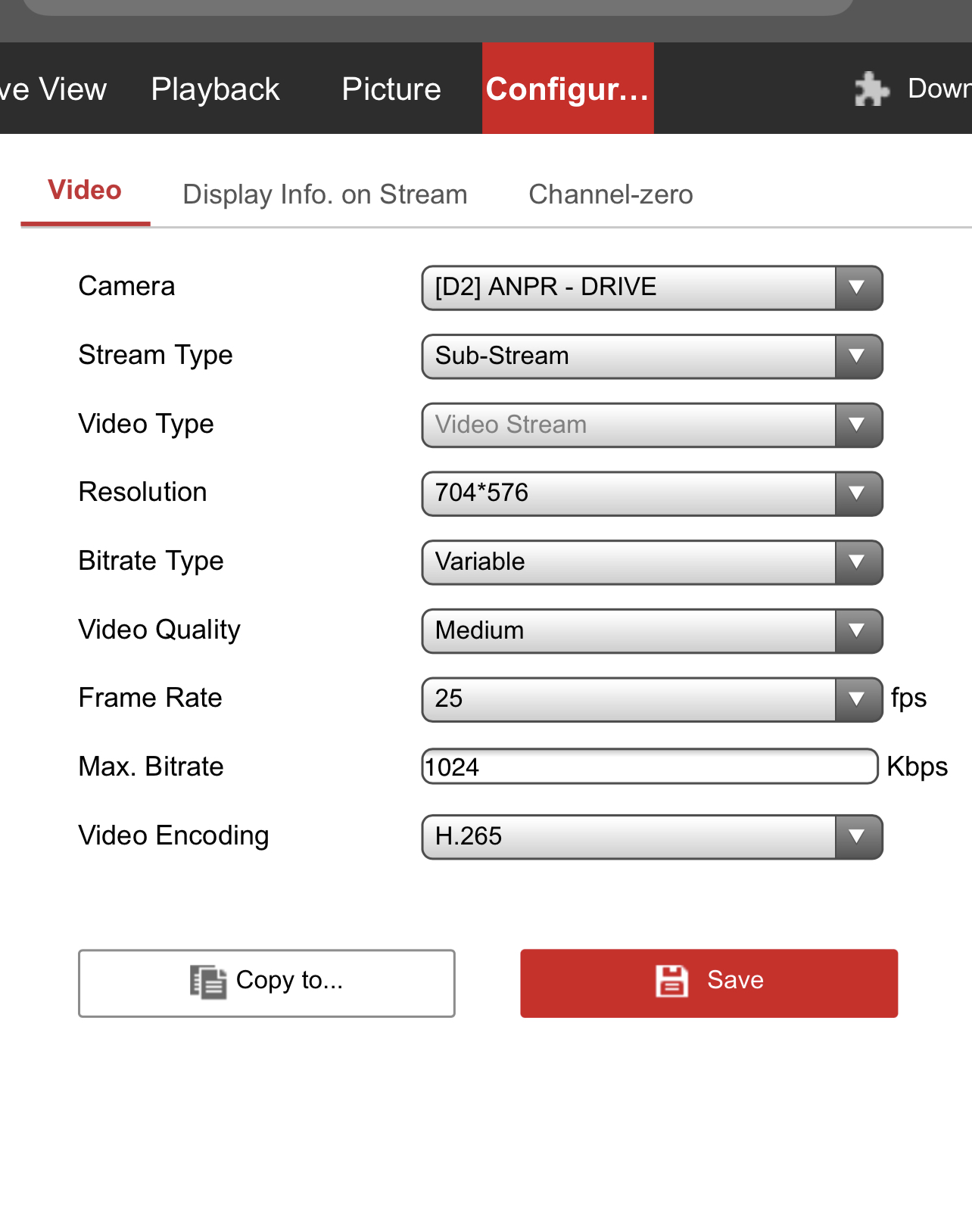

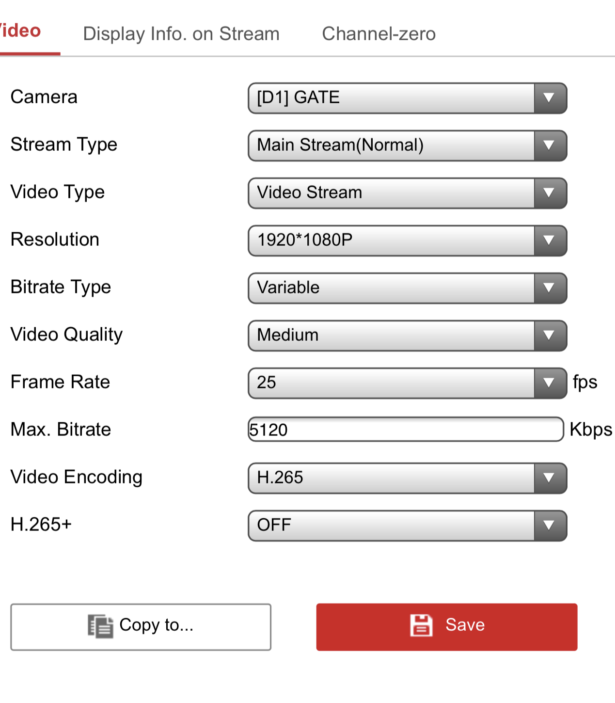

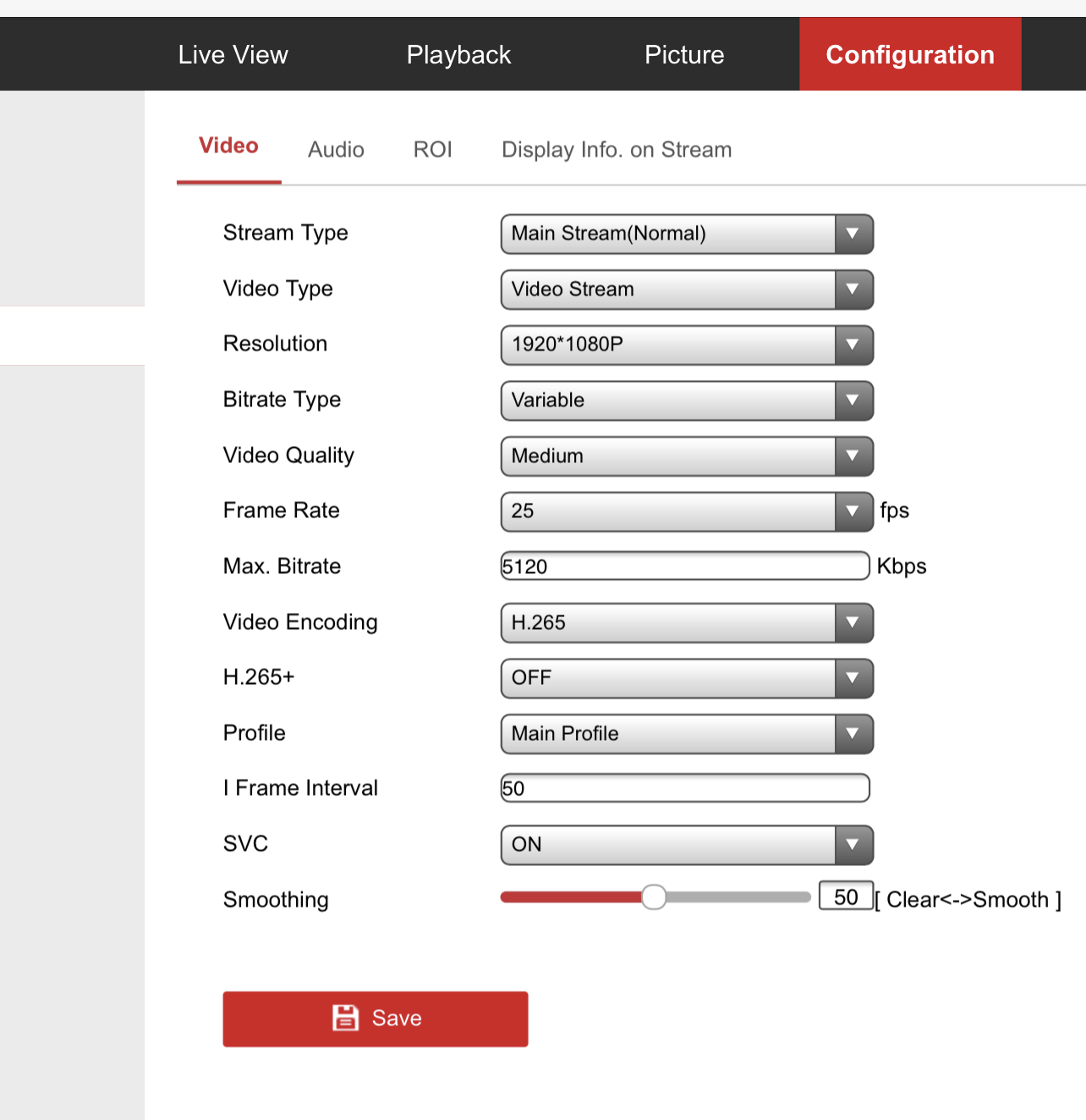

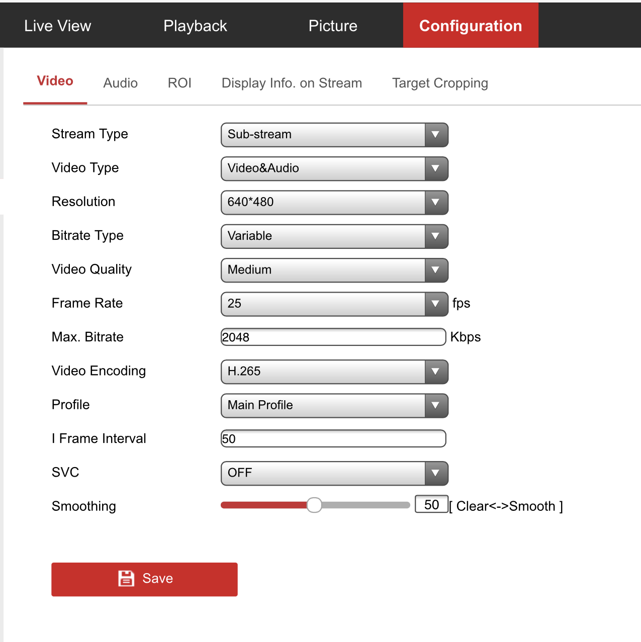

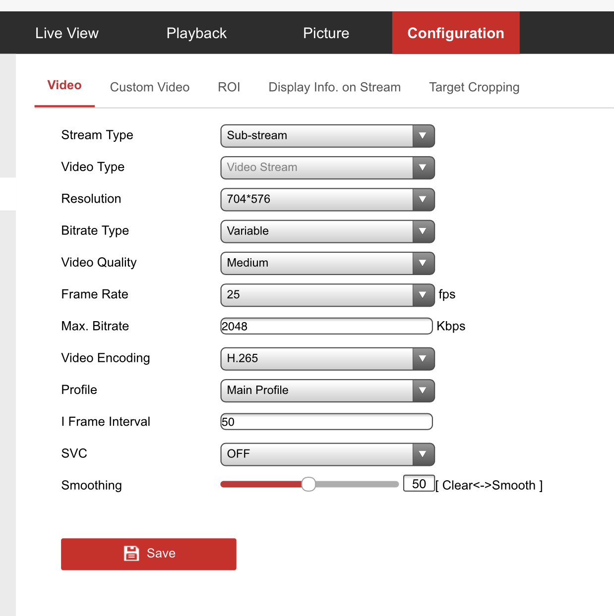

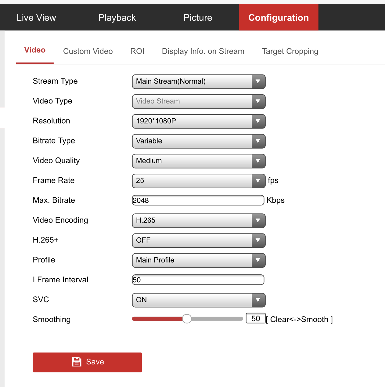

Sorry to come back again on this topic - I've been trying out all sorts of settings but still have the same problem with live view lags on my phone.
Basically, viewing live footage using home wifi is fine but when using my iphones mobile data, it is still lagging in the footage and pixilation occurring. If I change the mode from HD to Basic in the Hik-Connect iPhone app then the footage in liveview is fine but then the picture is not that clear so I rather have it on HD mode but then the lags occur.
I have attached the current screenshots of the video setting of my three cameras I have connected to my NVR so can someone please, once again, advise what settings I should really be tweaking to try and get rid of the lags when viewing liveview using mobile data.
Also,
1. Is there any difference in choosing "Higher" or "Medium" for the Mainstream Video Quality as I do not want to loose too much video quality for the recorded footage on the NVR.
2. Resolution - this is currently set to 1920 x 1080P on all cameras as if I choose a higher setting, the the lagging/pixilation gets worse when using mobile data
3. I have updated the Hik-Connection app to the latest version
4. Below is the current models and firmware versions of my system and the NVR will at some point in the next couple of months be replaced with a DS-7608NI-I2 /8P due to the current model not supporting VCA (saving license plate images) to the NVR.
NVR - DS-7604NI-K1 / 4P(B) - V4.30.055 build 201111
ANPR camera - DS-2CD7A26G0/P-IZS - V5.6.10 build 200703
8MP Bullet - DS-2CD2685G0-IZS - V5.6.5 build 200316
4MP ColorVu Turret - DS-2CD2347G2-LU - V5.5.134 build 200430
I appreciate everyone's advice.
Thank you

Hi @kmb786
I would recommend that you put the 8MP bullet and 4Mp ColorVu cameras up to H.265+, Highest video quality, and max. resolution. H.265+ massively reduces the bandwidth used by the cameras and the 8MP cameras & ColorVu at night are very bandwidth hungry.
For the Hik-Connect remote streaming issue, I would unbind the NVR from Hik-Connect and re-add the NVR to Hik-Connect by logging into the online Hik-Connect portal and use the NVRs serial number. We have seen before that adding via the QR code does not always work outside your local network as it is not properly connected to the Hik-Connect cloud servers which allow for remote access.

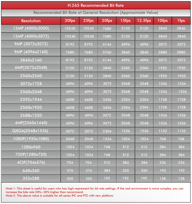

2) The below table shows you the recommended bitrates for different resolutions/frame rates
Hi @kmb786
We would not recommend using iVMS-4500, it is old and will not support the full functionality of some of the newer models you have. Stick with Hik-Connect and make sure you have checked the Hikvision App Store for the latest version of the app.
Have you tried unbinding the NVR and re-adding to the Hik-Connect web portal as I described in my earlier post? if using Hik-Connect you should not need to enable DDNS
In answer to your other questions:
1) Yes, H.265+ will limit the smart events you can use, if smart events are crucial you should use H.265 instead.
