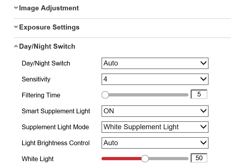

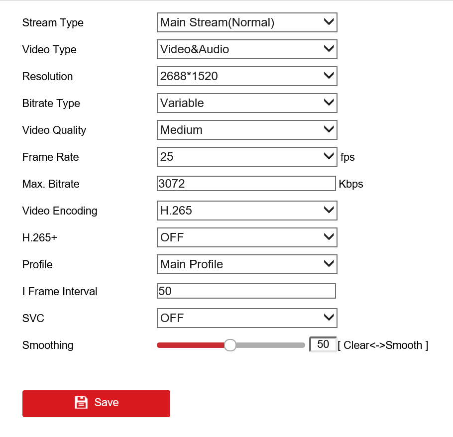

Can you please post to this thread screenshots of your camera's video settings and image settings (especially the Day/Night switch settings)?
Here are the pictures of the settings (the scene is also in Normal mode). I left everything to default other than turning on the white supplement light for that camera. I also successfully updated one of the cameras, I could wait and see if that fixes it before upgrading the NVR and the other camera, to see if it really was the camera's firmware

Update, I checked the second camera that this occurred on and it seems the white supplemental light turned on (but for this camera at 1:42 am) and that made the quality worse. I will try turning the "Supplement Light Mode" to OFF on this second camera and see if the same thing occurs.

One other thing to try would be to change 'Day/Night Switch' setting from 'Auto' to 'Day' which will force the camera to stay in Day mode all the time.
From the footage you sent, I can see there is a couple of minutes of recording missing when the image quality changes and when it does go completely dark it looks like the camera's white light is reflecting off the white soffit next to the camera. this would suggest that although the image looks good the camera's sensor thinks it is too dark and is switching the camera into Night/white light mode, if you force it into Day mode you should keep that bright image all night.
I would point out one thing though, I assume to achieve such an incredibly bright image at 1am you must have the camera's Exposure Time set to 1/12 (or possibly even 1/6) which does appear to make the image very clear but if you walk through that scene when it is pitch black at night it is very like the motion recorded will be very blurry/distorted because a slow exposure time increases motion blur.
I would test this and if you are getting motion blur you will want to increase the exposure time to something like 1/25, this may make the scene darker and if it is looking dark at this kind midnight/1am time you might have to angle the camera away from the wall and re-enable the auto day/night switch so that the White light can come on to help illuminate the scene during these hours (without reflecting off the soffit).

Oh whoops, seems I somehow cropped the video the wrong way. I will try that day mode instead on the second camera.
And you're right, by default the Exposure Time set is 1/12. There isn't any additional light near this camera which I assume makes the motion worse. I will try 1/25 and maybe try changing the scene mode, thank you so much for everything you do on here!
