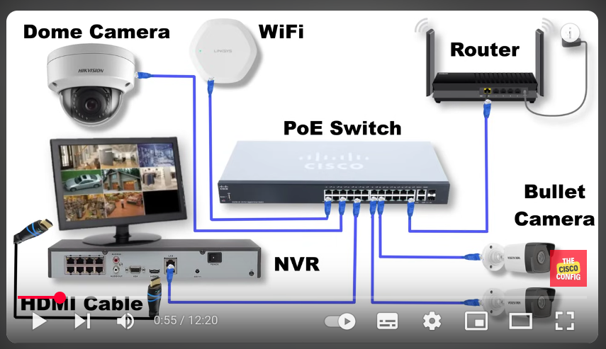

Here is an image of a similar setup, am just not using a router.

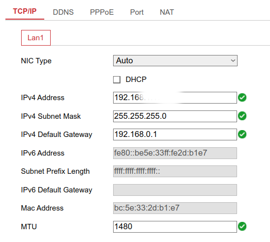

NVR Settings, I see it can do DHCP, would it be better to turn this
feature on or would this result in IP addresses in a range that the
rest of the network can't access.
it is ok to publish the IPv4 address of the NVR, could you post a screenshot of the router network setup and NVR camera management page?
leave NVR DHCP as it is for now, did you say you could access the NVR and see video from the cameras?
