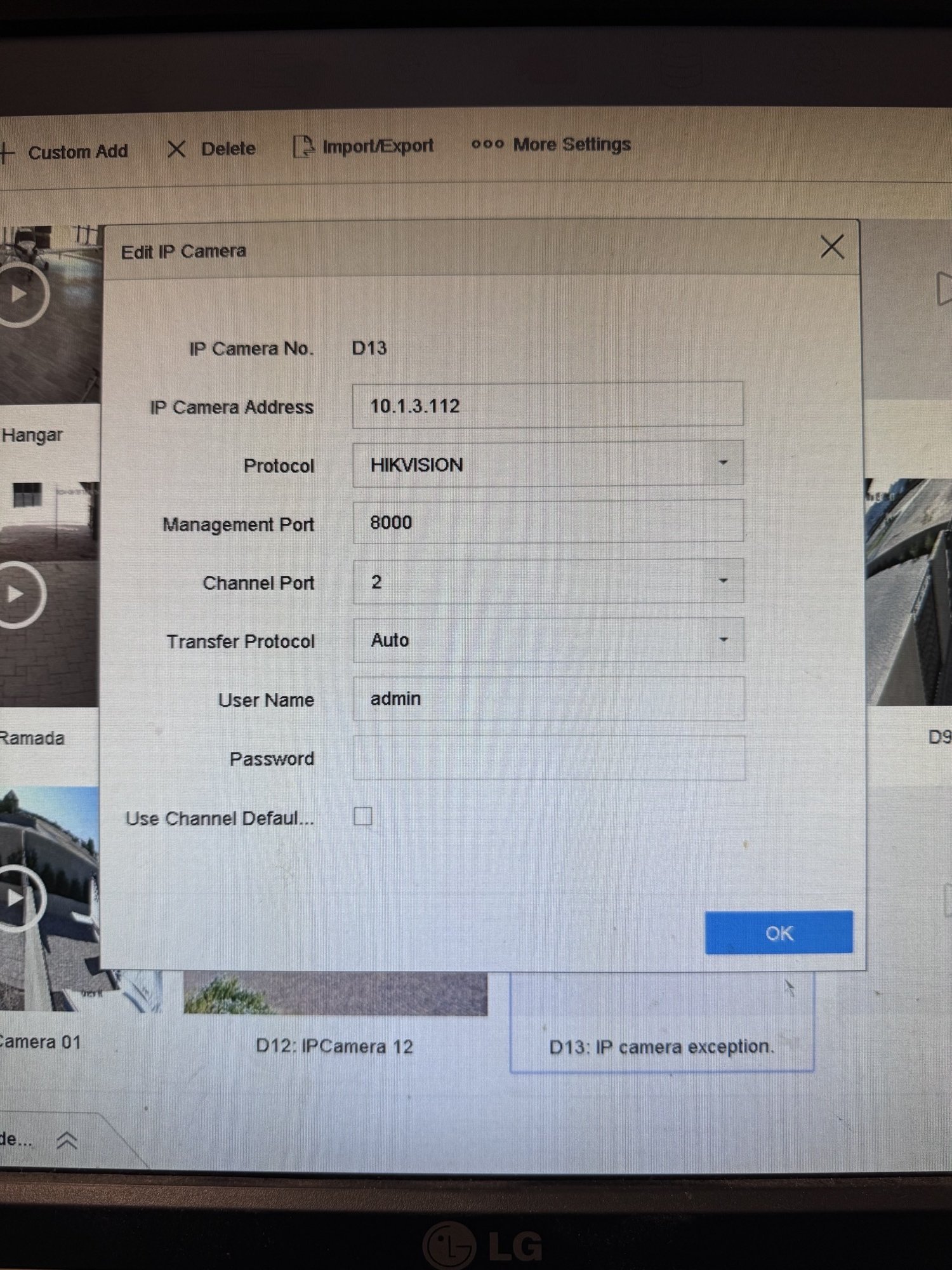

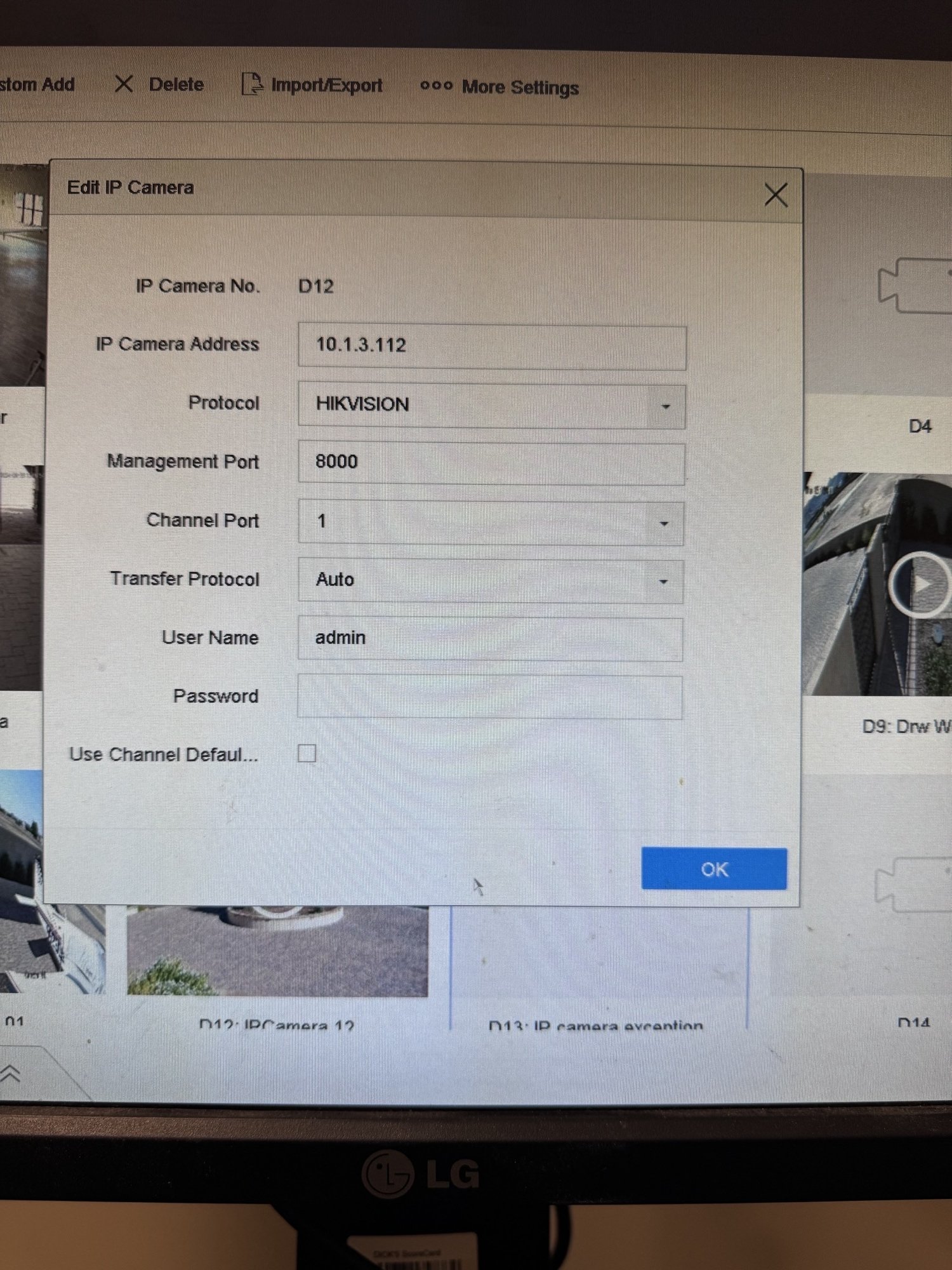

I would appreciate any suggestions on what I am doing wrong. I have the Tandemvu camera with two channels - Panorama and PTZ. When the device was initially added, it only added the PTZ channel. It didn't ask to select multiple Channel Ports, it just added PTZ like it's a single-channel camera. When I try to add the camera manually, entering the IP address and selecting a second Channel-Port - it adds the camera and briefly shows the video but stops after a second or two and says IP Camera Exception. Why is this happening to me?

Which model NVR please?
And what firmware version is it running?
This thread covers how the same issue was resolved on NVRs with V5 firmware:
It looks like your is on the V4 firmware, but I'd try disabling POE / Plug & Play on one of the channels to see if that fixes it (after making sure all the firmware is up to date).
Also, make sure you have DHCP off on the camera and NVR as mentioned in the last commend on the above post.

NVR model is: iDS-9632NXI-I8 / 16S
NVR Firmware: V4.1.25 build 181028
Camera model is: DS-2SE7C432MWG-EB/26
Camera firmware: V5.8.0 build 230321

I am on v4 firmware, and my NVR doesn't have any PoE ports, so I am using a PoE switch. My switch can only supply up to 30W per port, and because of that, this camera was not working properly, so I bought a single-port 60W PoE injector. The camera started to work. Because of that, I don't think I would be able to control Plug&Play capability on a per-port basis. And I do have the DHCP disabled on the camera

I apologize for the delayed response. I accepted my fate and stopped looking for a solution for a while. After the upgrade, I deleted all the cameras and re-added them. The camera enrollment works fine, with two channels showing. The PTZ channel always works fine, but the Panorama channel never works on the NVR side and is not being recorded. Interestingly, after re-adding all the cameras on the NVR, the Hikvision keyboard DS-1600KI(B) started showing both channels correctly.
Just a sad update for anyone struggling with the same issue. I spoke with Hikvision support and they told me that "this specific camera is not compatible with my NVR iDS-9632NXI-I8 / 16S and it's better to call them each time before buying "specialized" cameras so they can check the compatibility"... They showed me the list of compatible NVRs and it was very short, like two models listed...
