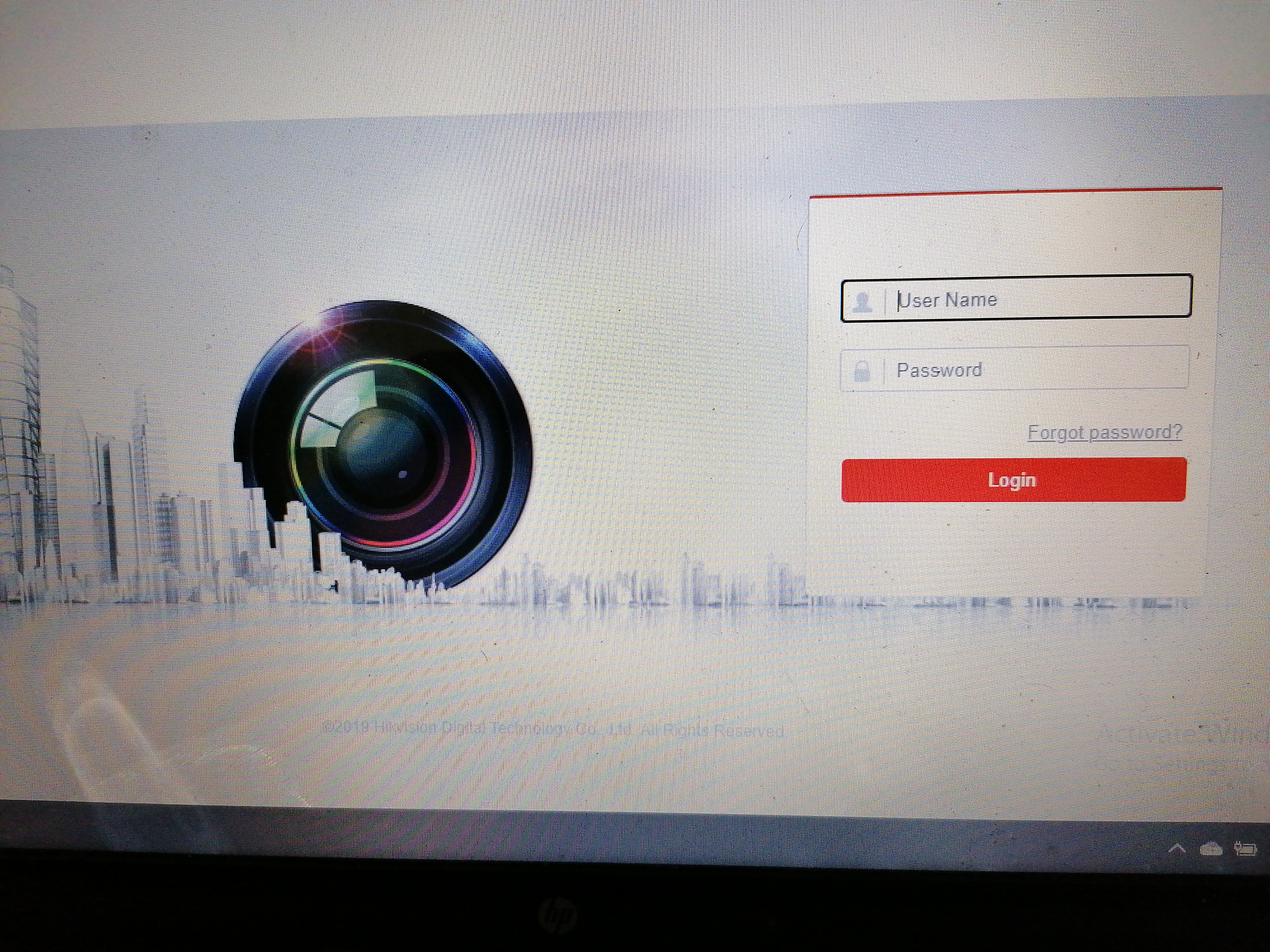

How do you log into
Open a browser (Internet Explorer works best), enter the IP address displayed in SADP (192.168.0.16), and then enter the username and password you set the NVR up with when you first installed it. If you don't know this password you will need to contact your original seller/installer to get them to process a password reset for you.
Don't no the username as I did not set it up where can I find this
Hi thank you finally found the username and password what the put on. I got into the settings and managed to turn on the microphone thanks for all your help cheers jason
