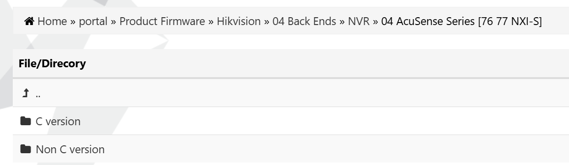

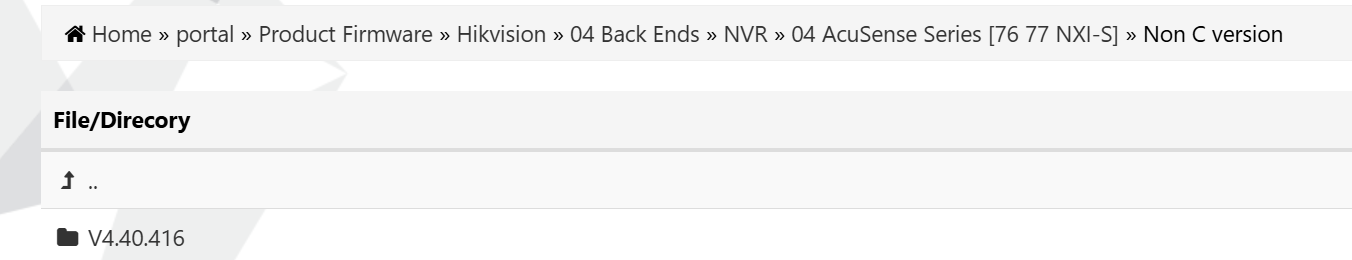

I took a look at the UK Portal for DS-7608NXI-I2/8P/S... there are 2 versions listed there... C and non-C:
The version you currently have is only listed under the non-C so you must have the non-C version and the firmware you are running is probably the latest already:

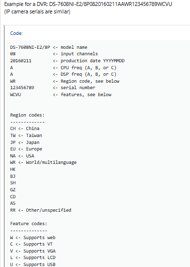

That CC does not mean it is a C version... here's how to interpret the serial number:

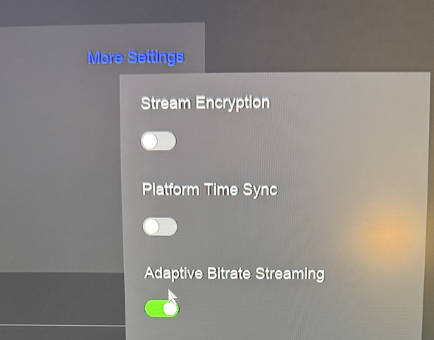

I had the same problem a while back and it was @JB1970 who advised me to turn off "Adaptive Bitrate Streaming"... but I can't seem to find the thread, and I don't know what NVR/firmware I was using at the time...
I do remember it was only the sub-stream resolution/bitrate that was changed with this setting on... each time I would view the "Basic" stream in Hik-connect, the sub-stream downgraded... very annoying...

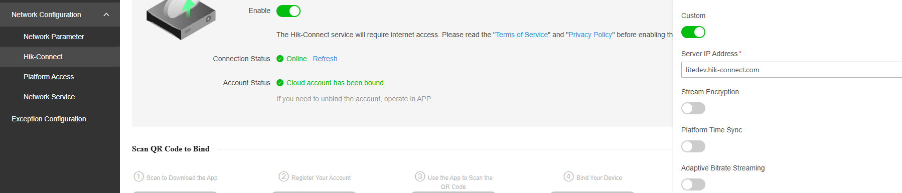

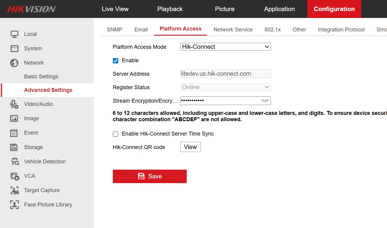

Here's the setting on a fairly recent M series running V5 firmware...
Maybe @JB1970 knows more?
Adaptive bitrate streaming is also an option in V4 firmwares. I can’t recall whether it’s in the Platform Access page or elsewhere but it’ll be turned on by default and should be switched off.
