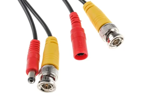

Hi, I don't know much about cabling and CCTV etc. I was trying to install a camera (hikvison DH) using a CCTV cable (see attached) to a DVR
I was able to connect the camera easily to the connectors, and also to connect the BNC to DVR
However I'm not sure how to connect the DC connection to the DVR
Any recommendation? Do I need an adapter perhaps?

The DVR will only power your analogue cameras if both are Power over Co-ax (PoC) compatible, otherwise you will need separate power supplies to suit the cameras (for example 12 volt DC PSUs).
