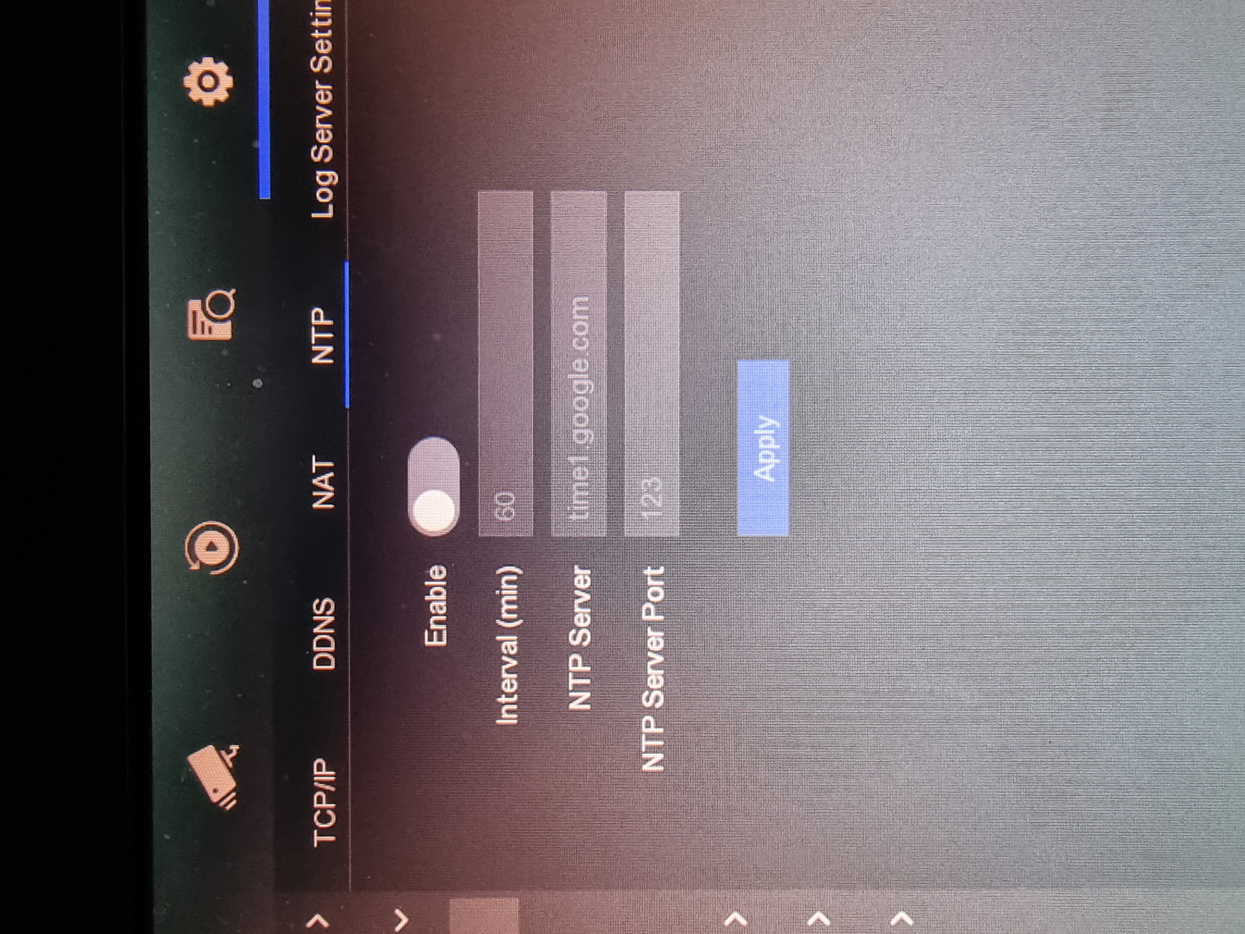

So I just click enable and that will update the time on all cameras?
Check the other things first (time zone and daylight savings) If the time zone was incorrect once you set to GMT London Dublin you’ll need to correct the time. Then for the NTP, yes, enable and apply. You can leave the server as the one Hikvision have entered or change it up.pool.ntp.org
The NTP just periodically checks the MVR time against the server and synchronises it if it drifts. The NVR should then keep all of the cameras synchronised to it’s time, if the cameras are connected to the PoE ports of the NVR and they were connected using plug and play.

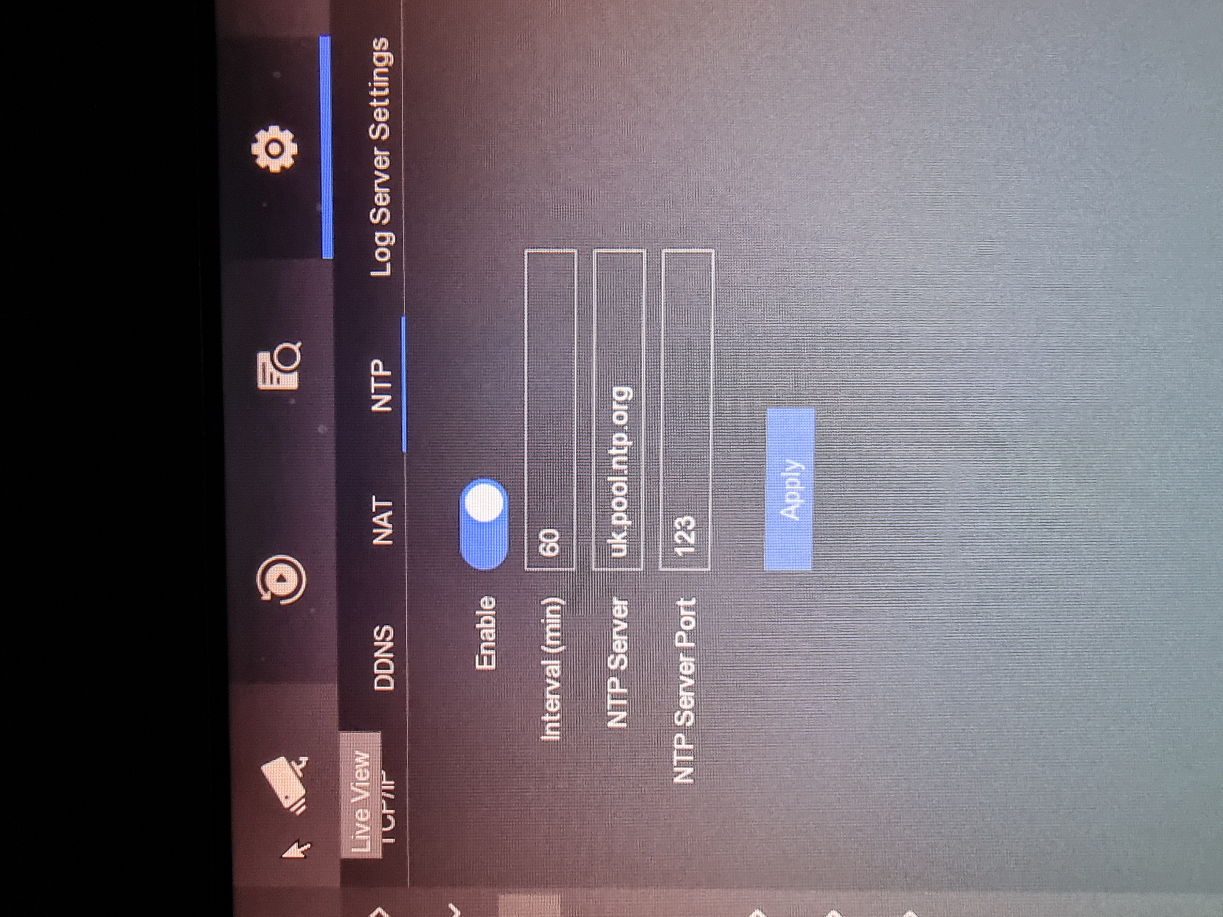

Not sure what to try next

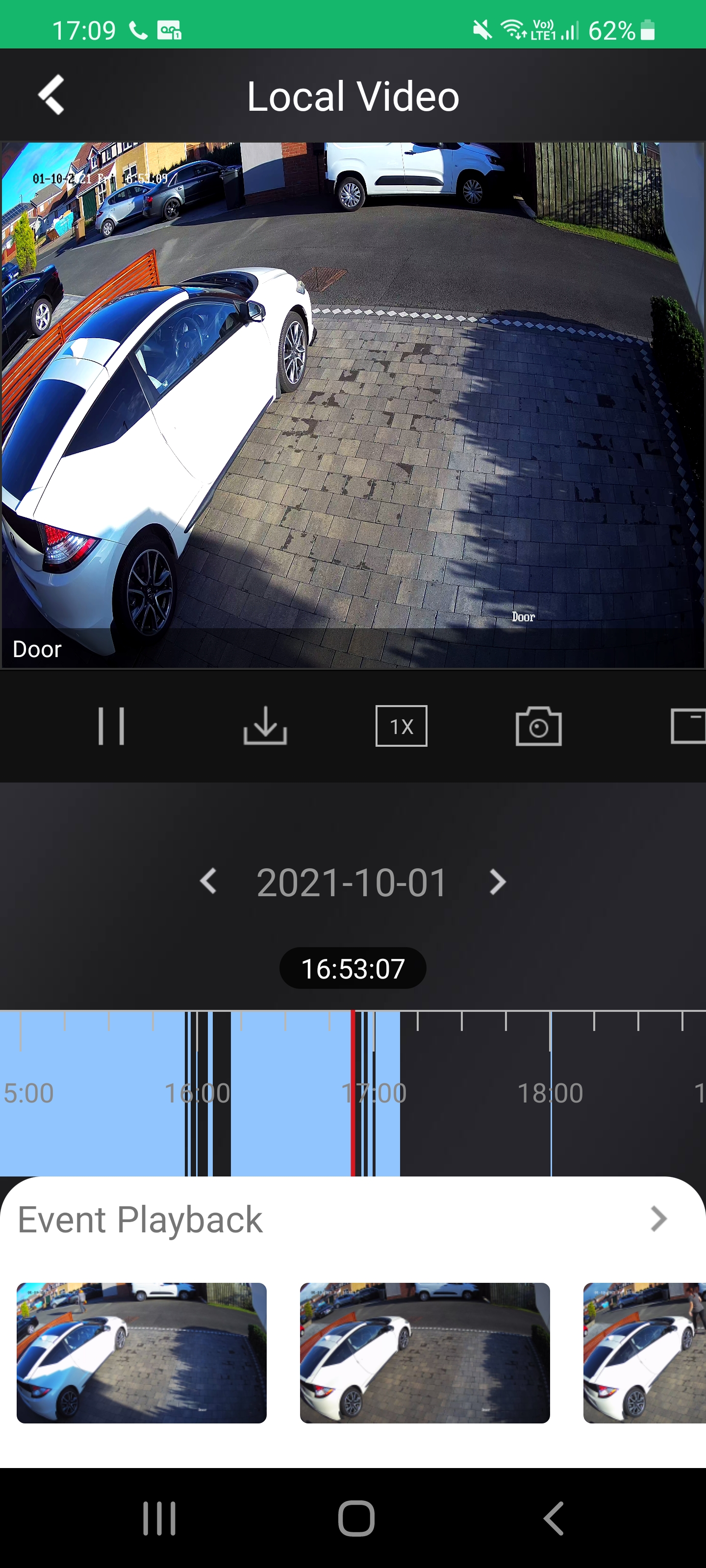

Hmmm it's totally messed up my time and caused the NVR to crash
