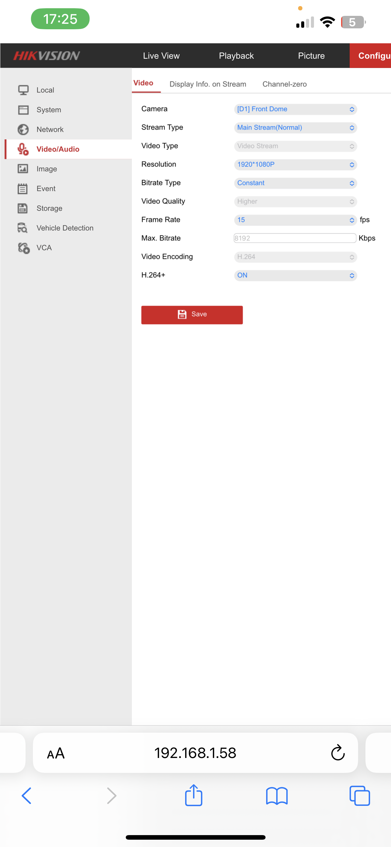

I have a Hikvision DS-7604NI-K1 / 4P with a couple of cameras. I have a new DS-2CD2387G2-LSU/SL camera which is really choppy. Ive tried to change some settings but seem to have made it worse.

No my other cameras are only 4mp, not the best. I have tried to turn some settings down and slightly improved now but thinking I could be as you say running out bitrate
The choppy footage occurs on both live and recorded no matter what I’m watching on whether that be the app or directly on the NVR

You may be OK with those cameras - I'd try adjusting the following settings first:
Bitrate Type - change to "Variable"
(See if this resolves things before adjusting the below)
Video quality - try "Higher" or "Medium"
Frame Rate - try reducing this gradually
Max Bitrate - drop to 6144 Kbps
H.265+ - "OFF"

Brilliant news, thanks although I don’t think my NVR quite supports the full features of my main camera?
The firmware I am on is V3.4.98 build 171121
Have tried to upgrade to V3.4.103 but wouldn’t work. Shame that it’s not compatible with the latest V4 firmware
