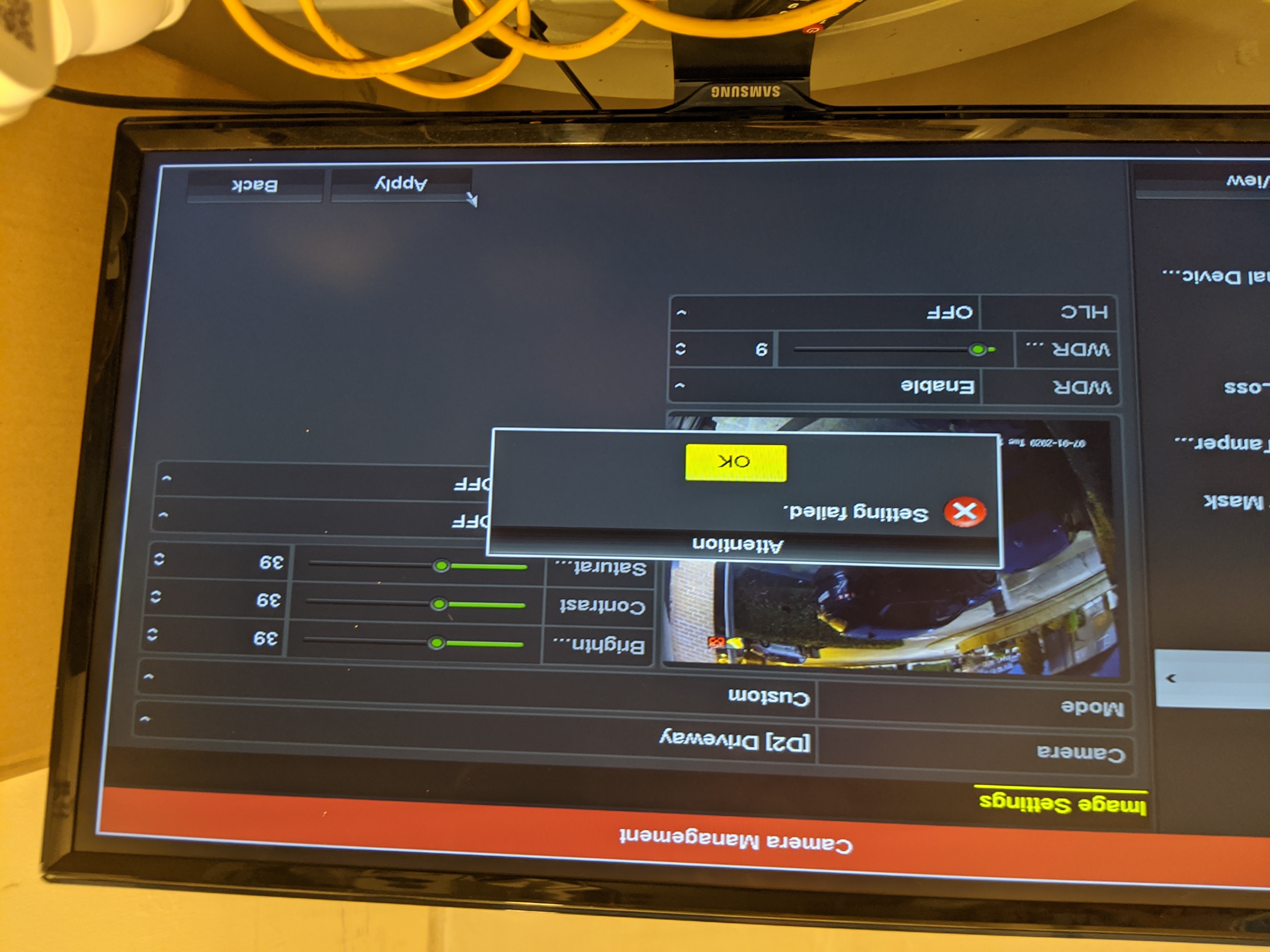

I'm setting up two new cameras and an NVR and am having trouble with one of them (the colorvu DS-2CD2347G1-LU)
The D2345 works just fine and the NVR (DS-7604NI-K1) looks to be good too.
On the colorvu though, every time I try to enable WDR or HLC I get an error message "setting failed". Its fine on the D2345.
I've been through the manual and searched but can't see any particular setting that I've missed so as to allow WDR or HLC
Any suggestions on where to start folks?
The camera datasheet says it's good for 120dB WDR, so it should allow that to be enabled,, no?

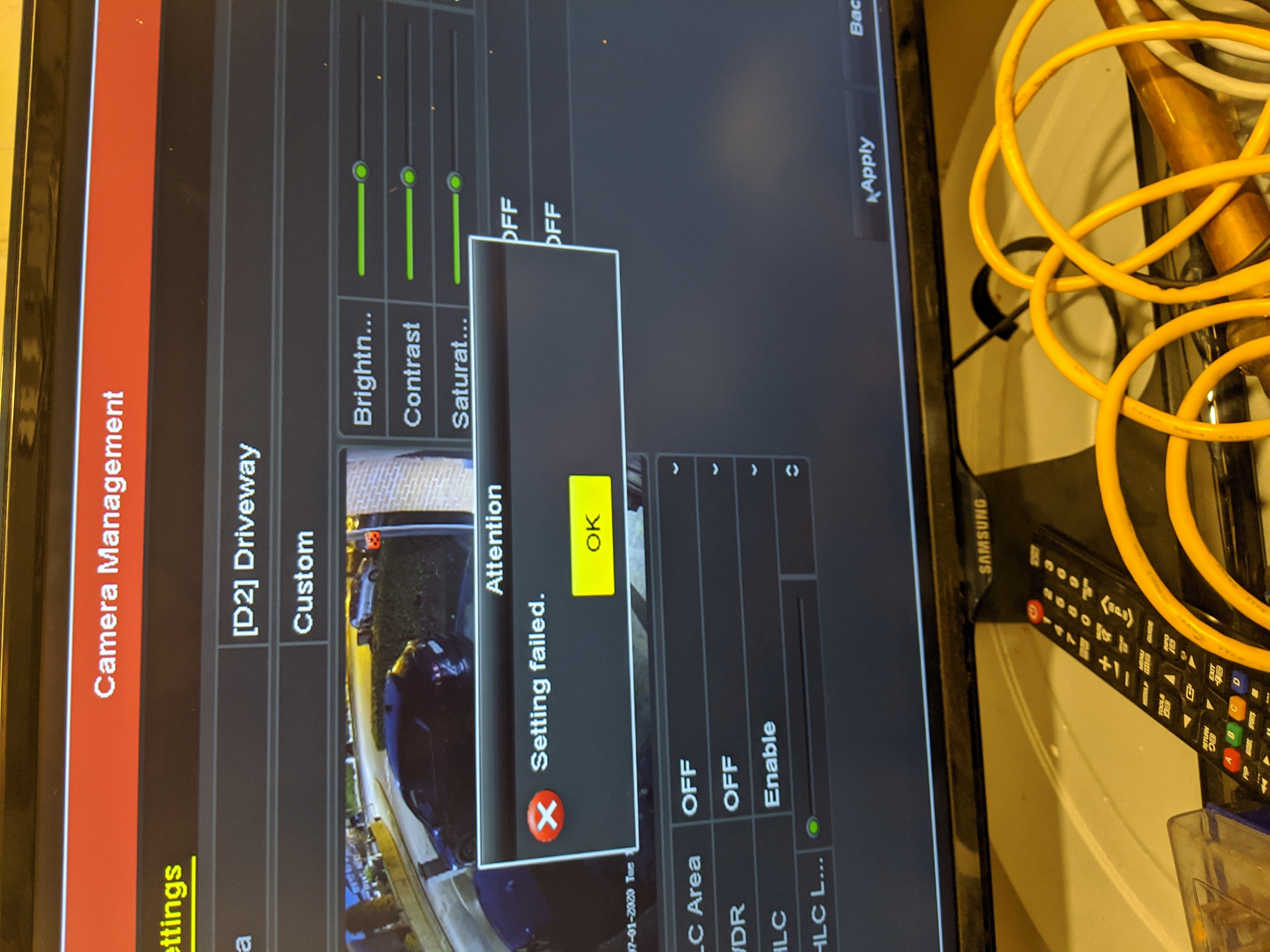

Are you able to post a screenshot of what you are seeing on the image settings please (including the error message if possible) as we may need to point this in the direction of Hik support to see if they are aware of the problem.
Apols about the rotation!

I had a similar issue where the Enhanced SDK Service Port (8443) on the camera was acting as the default management port and prevented the NVR from making changes. I had to disable the service on the camera in order for the NVR to save the settings via the default management port (8000). Not sure this is your issue but might be a lead. I was surprised to see the SADP tool reporting the camera defaulting to 8443 (which is encrypted) - wonder if this is standard on the newer firmware?
