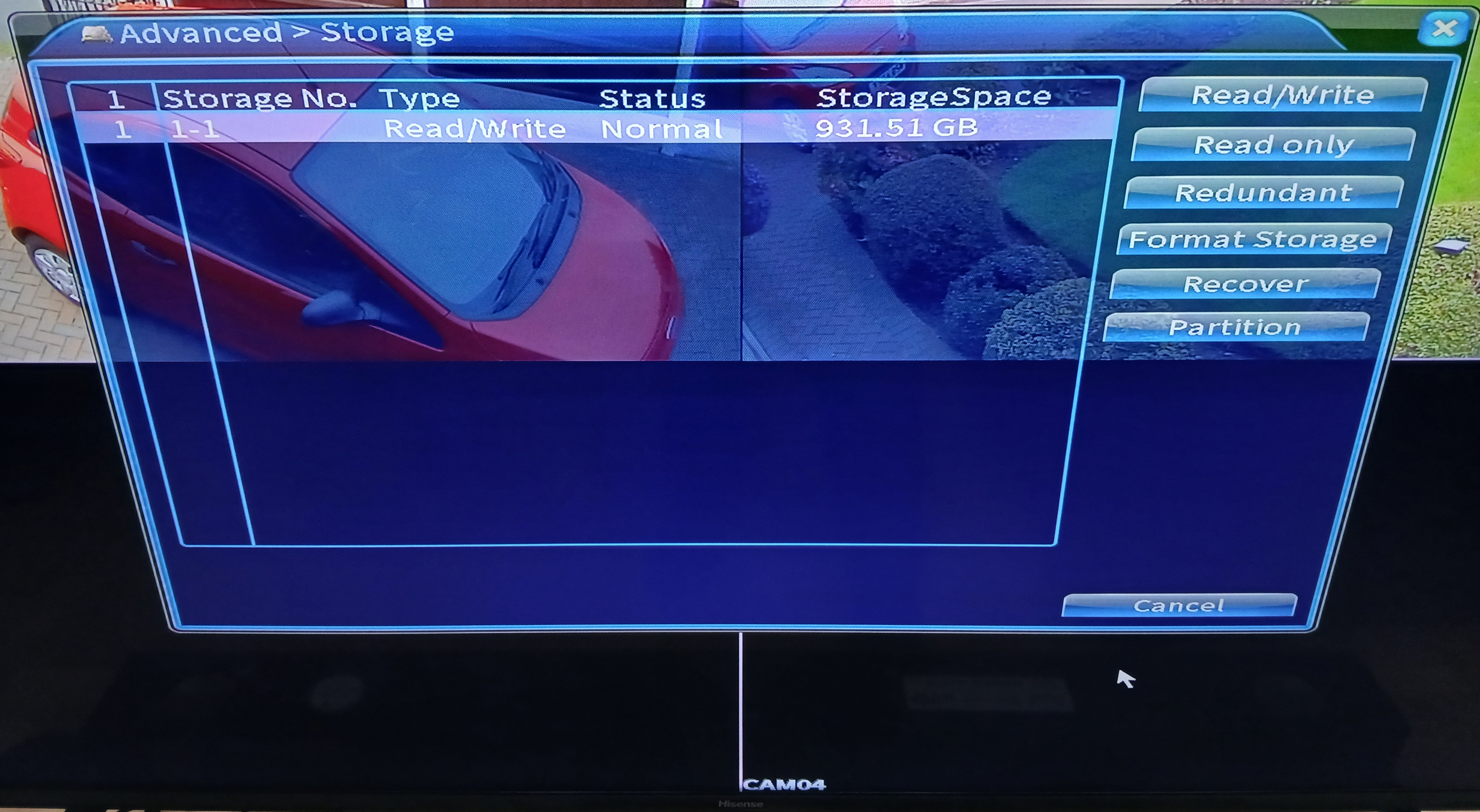

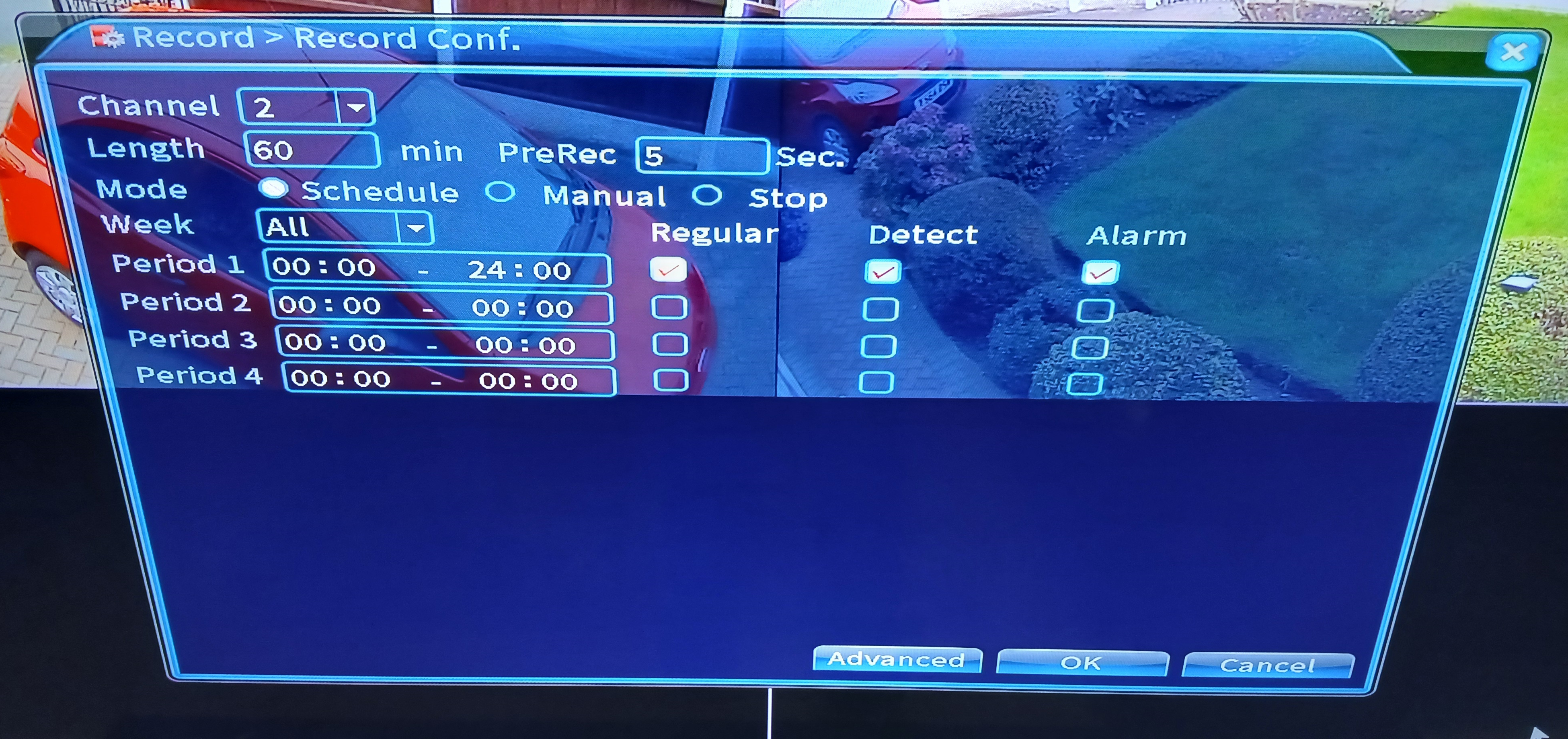

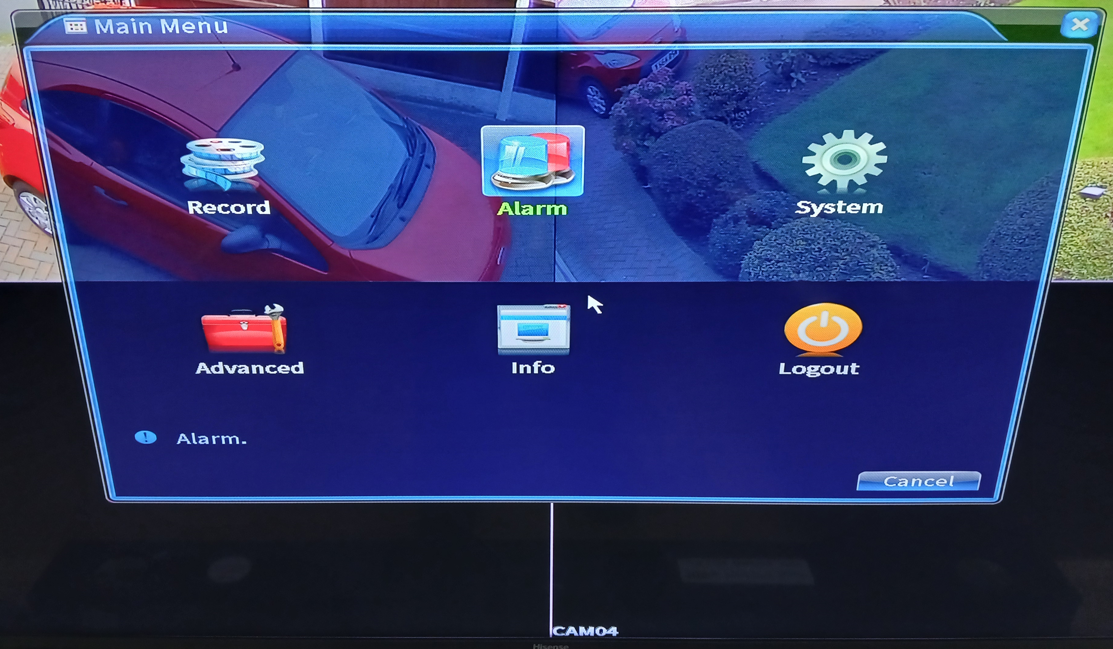

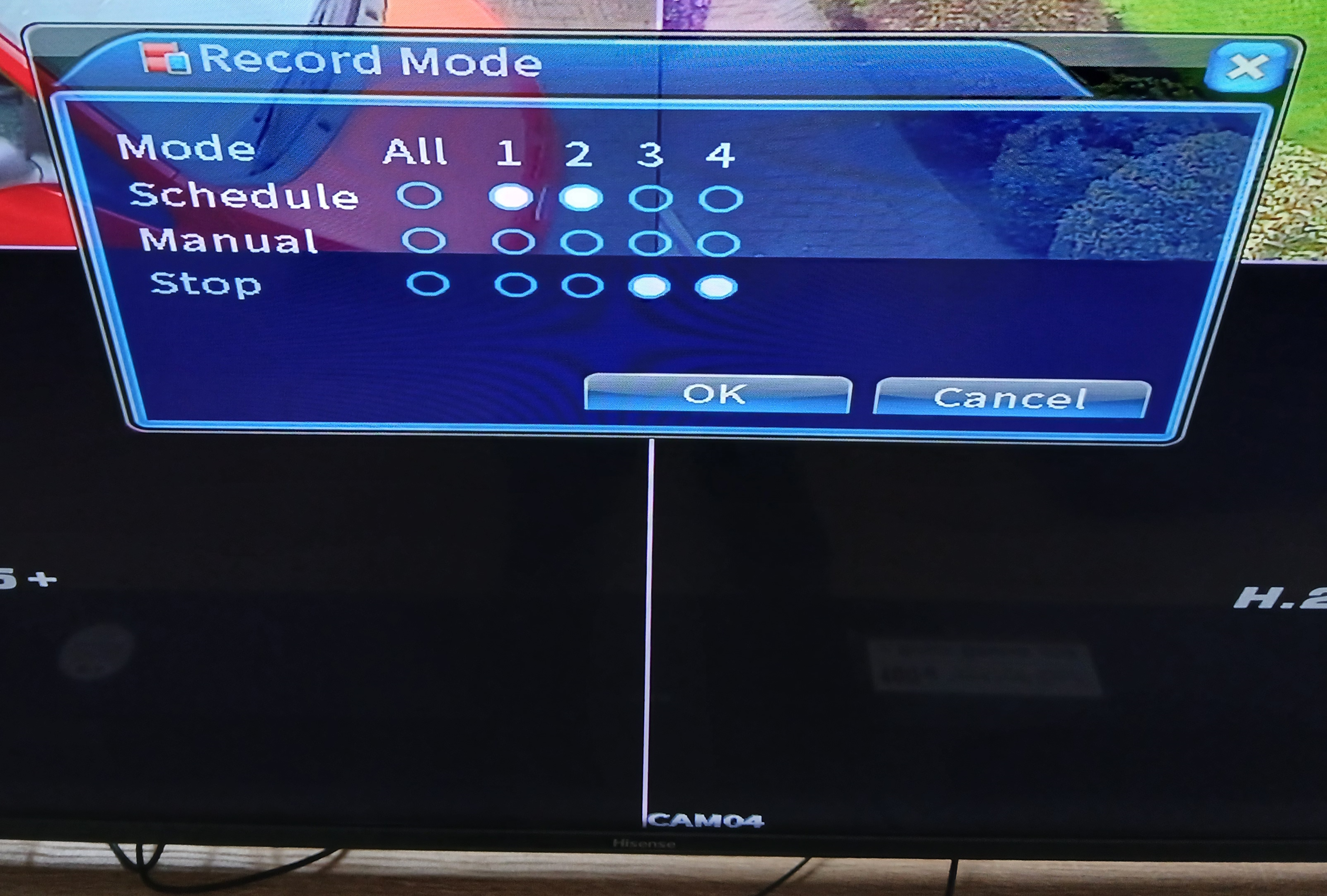

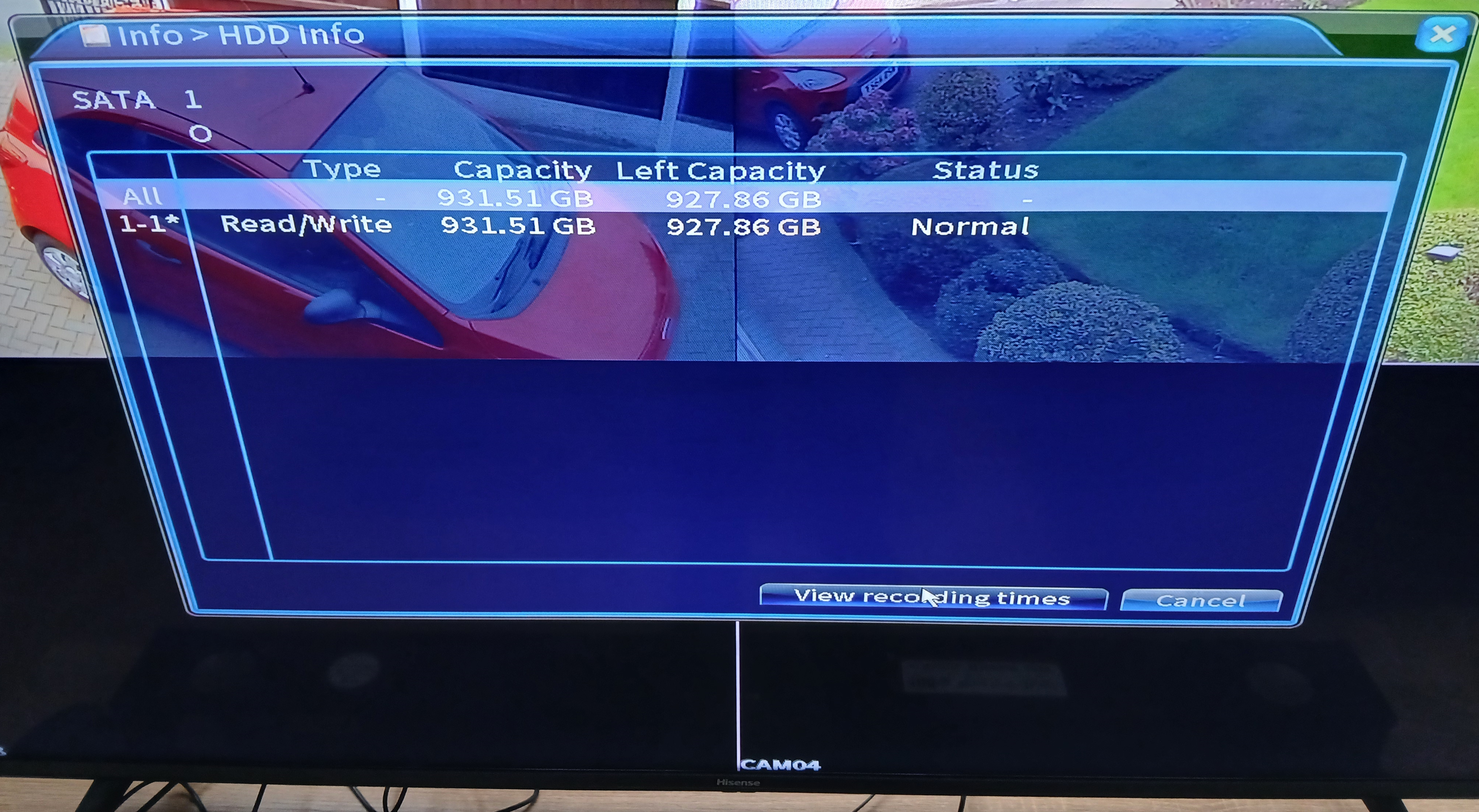

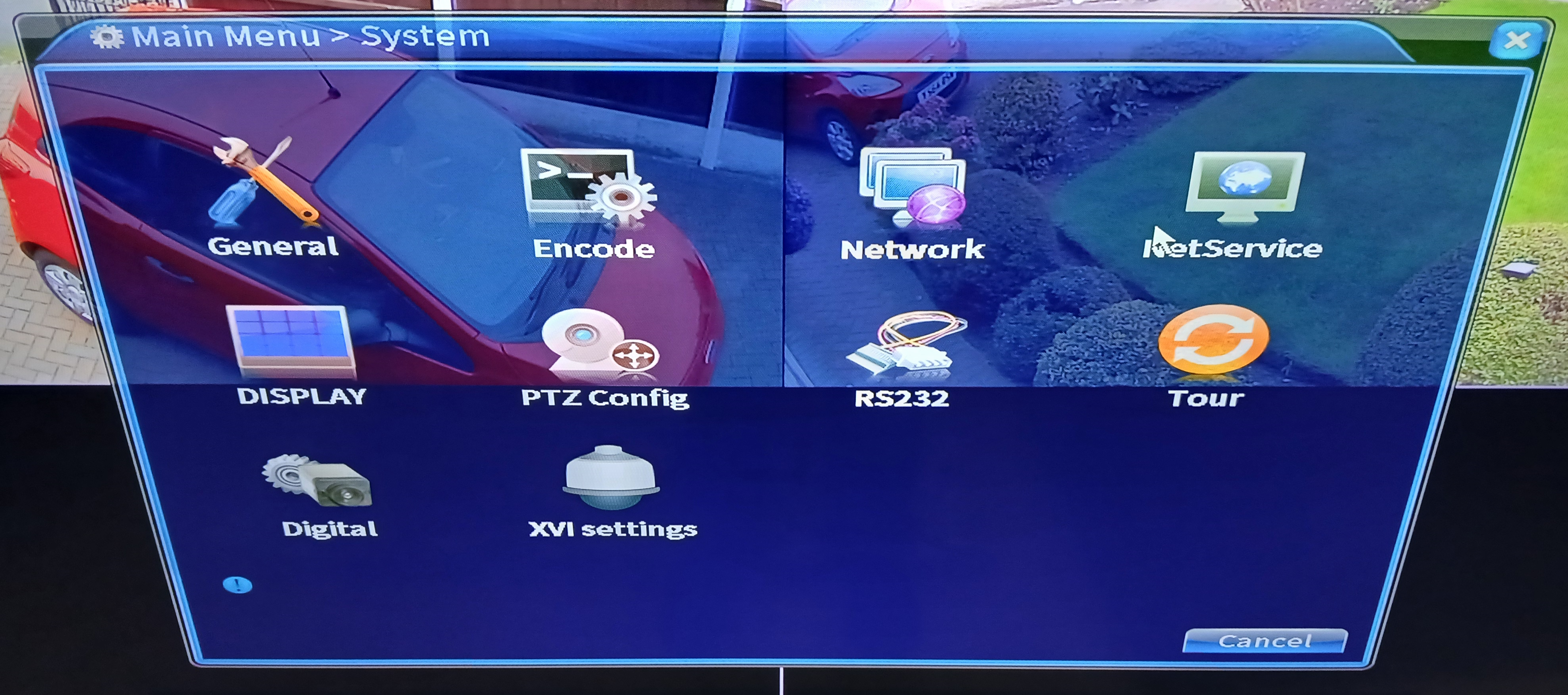

Here are a couple of screenshots showing the menu screens and the options I have chosen.
On the 'Record>Record Config' - I have chosen 2 channels (as I only have 2 cameras)
The length and prerec times have been left as default
I have left the Mode as 'Schedule'
Period 1 has been set as 24 (to record 24hrs)
Any advice is greatly appriciated.
Kind Regards,
GingerOverlord

Thanks @GingerOverlord
These are some very odd, non-standard recording settings.
Do the instructions/manual you have mention anything about the 'Length' box in the first screenshot that is currently set to 60 minutes?
To me, that looks almost like a max. recording duration, have you tried setting this to 120 or 180 minutes to see if that extends your maximum recording duration?
Have you tried setting it to 0 minutes? That might remove the duration cap entirely so that it just records until the HDD is full.
It's very strange because I can't see anything significantly wrong with how you currently have the recording configured.
Are the cameras connected to the NVR set to 2MP/1080p resolution?
What options are given to you in the 'Advanced' sub-menu in the record settings?
Have you tried just setting the record schedule to 'Regular' and unticking 'Detect' and 'Alarm'?
