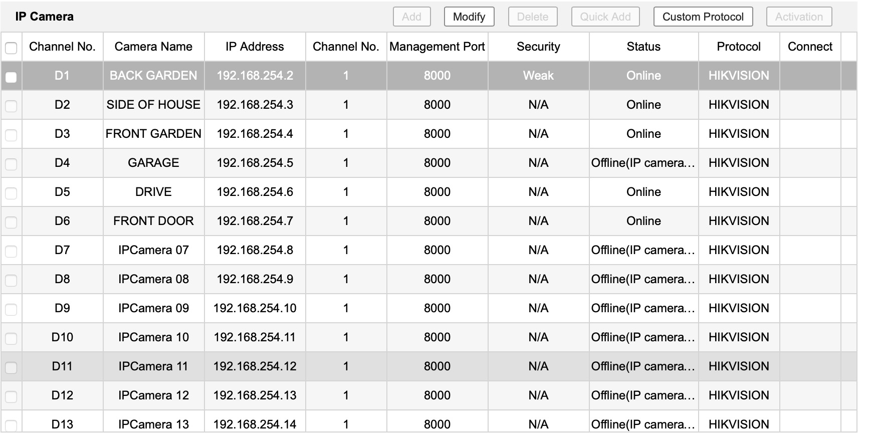

Hi guys,
I have the following cameras and NVR
DS-2CD2342WD-I
DS-2CD2142FWD-IS
DS-7716NI-E4 / 16P
I reset my 7716NI-E4 to factory default settings and now I can't access each camera individually using the URL links when you log in via browser? (usually it says connect under the connect tab). I've setup the IP address/gateway and dns exactly the same as it was.
Any help would be appreciated
Hi @Brocky120
Have you enabled Virtual Host? You should find the setting under Configuration > Network > Advanced Settings > Other
Hi @Brocky120
Absolute legend. I knew it would be something simple in the end. I just don't remember enabling this previously! If anyone comes across this check Dan's reply out.
