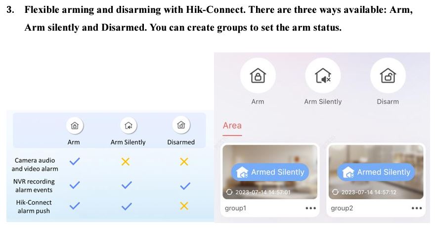

Yeah that’s pretty much how it should work but as described earlier in post 31 ‘Disarmed’ disables alarm events (no clips available in app). Also it would be better if ‘Arm silently’ disabled Hik-Connect alarm push. That would mean the event clips were available in the app but there would be no audible push notifications. As it stands, if you stop the audible push notifications (‘Disarm’) you’ve also lost the event clips on the app.
I’ll just accept it as a feature that doesn’t work for now.
