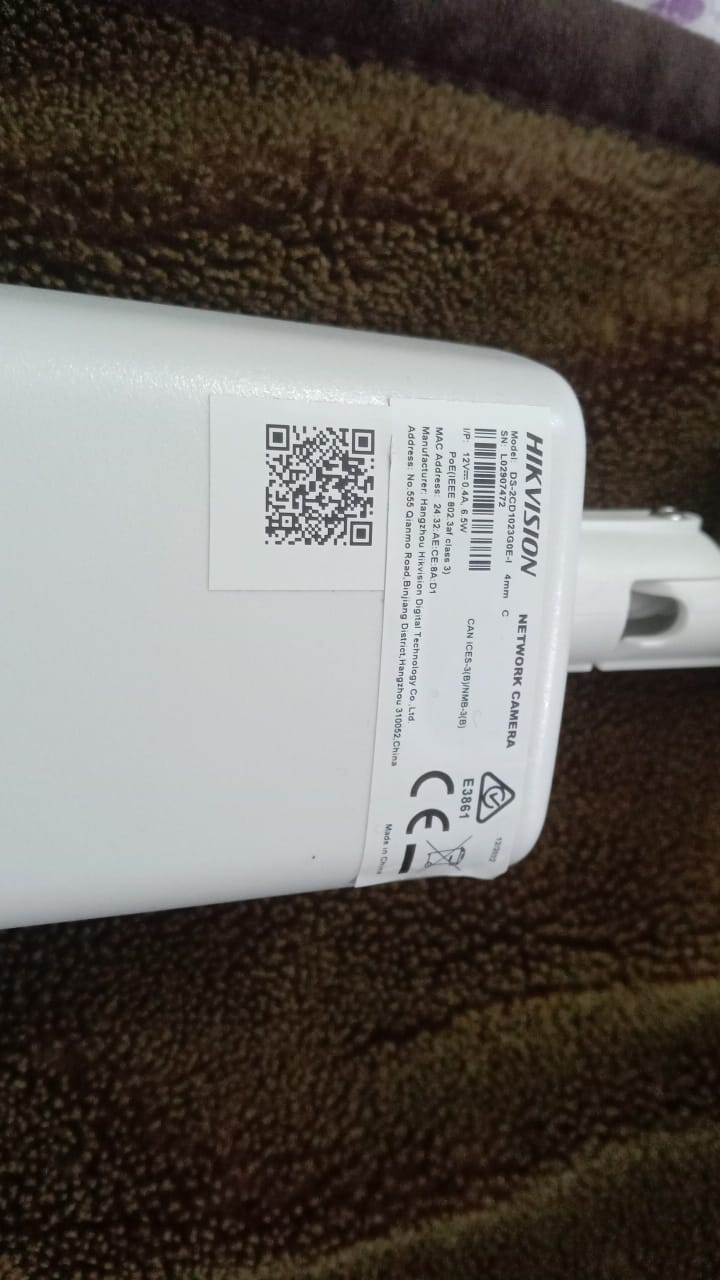

ipcamera hikvision model DS-2CD1023G0E-I, Reset button is unable to detect, help where is it located.see details on camera tag.

The hard reset button is usually found under MicroSD card cover, your camera does not support on-board MicroSD card which means your camera probably doesn't support a physical hard reset button.
The only way you can hard reset a camera without a hard reset button is to follow these password reset instructions and send the reset file to the seller/installer you originally purchased the camera from, they can then sort out a password reset for you to regain access to the camera.
