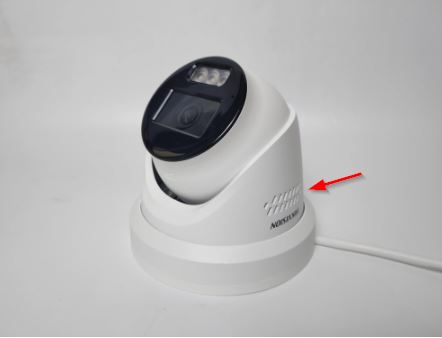

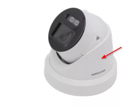

Another question - I've noticed that some sellers sell this camera with some pattern on the side next to the Hikvision branding that looks like a speaker holes, but some without.
What is the difference? Which one is the proper one version?

In regards to the difference in design, the model without the holes is actually the LU model without the speaker and the model with the holes is the LSU/SL model with the speaker and the holes simply help the sound dissipate.
Reactions: dsa
Hi Dan, thank you for your answer. This is what I thought, I got confused because even on Hikvision web site DS-2CD2387G2-LSU/SL is shown without the holes DS-2CD2387G2-LSU/SL
