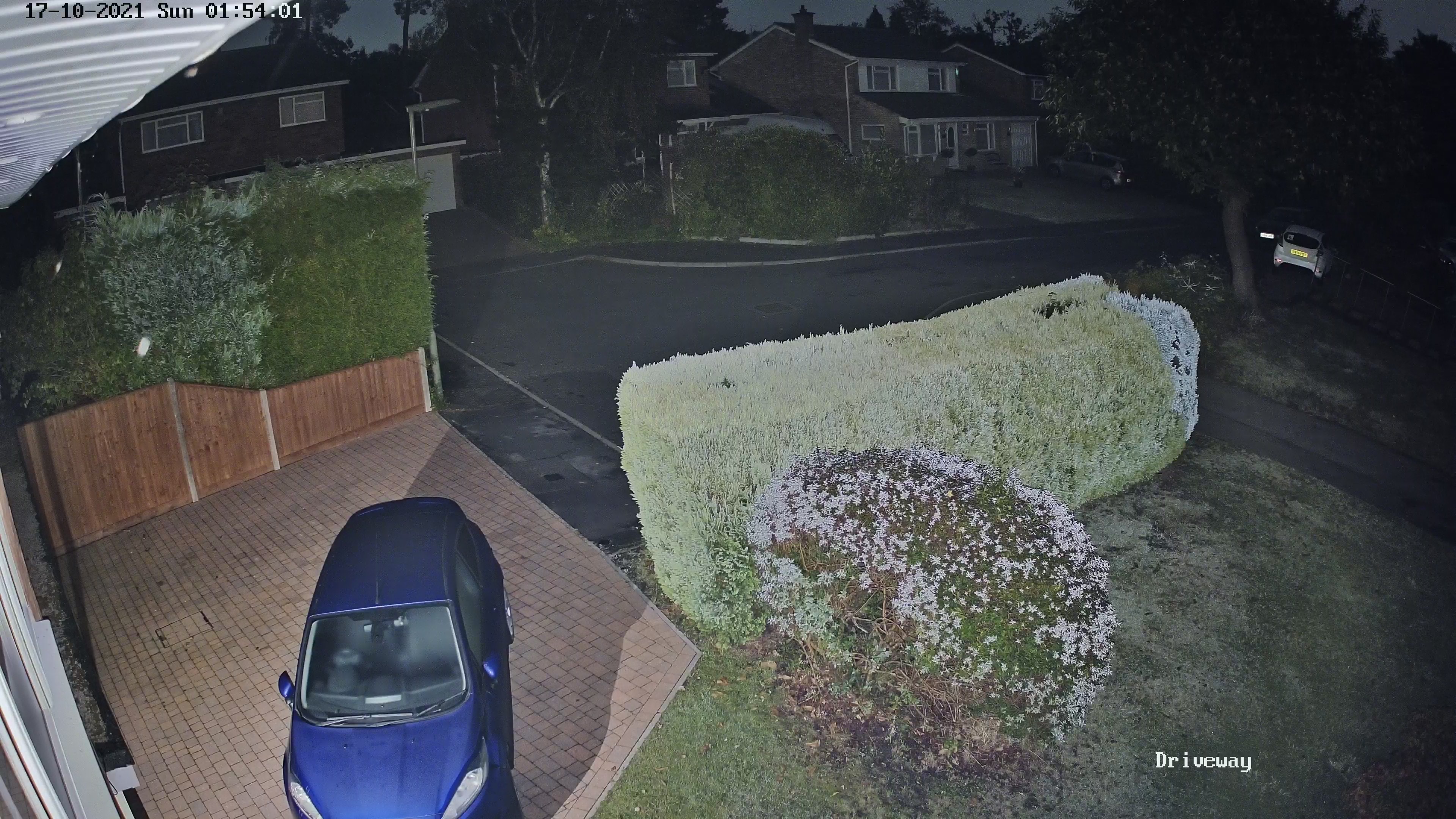

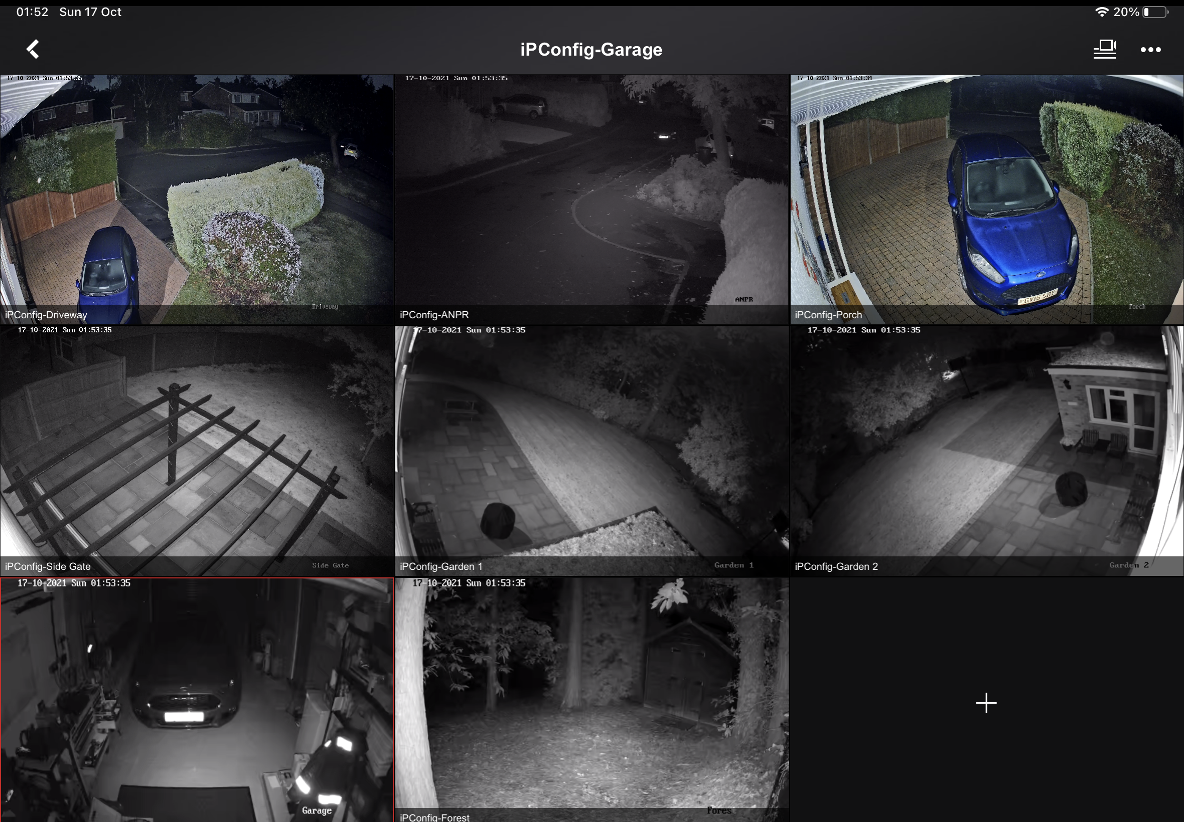

:: Update ::
The original ethernet cable fitted 6 years ago was aluminium :(, Today I re-cabled with solid copper core CAT5e and 8MP ColorVu now working correctly :)
