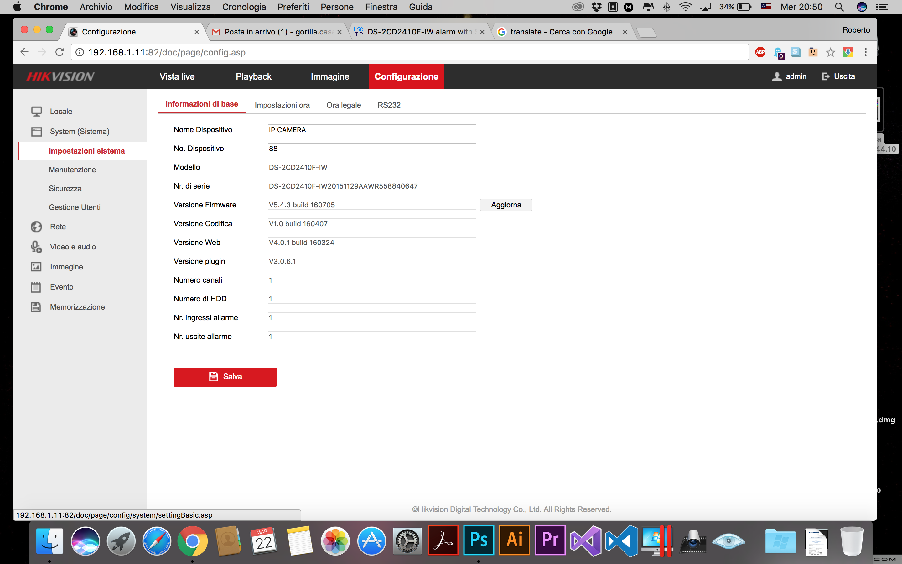

All cameras have same firmware V5.4.3 build 160705?

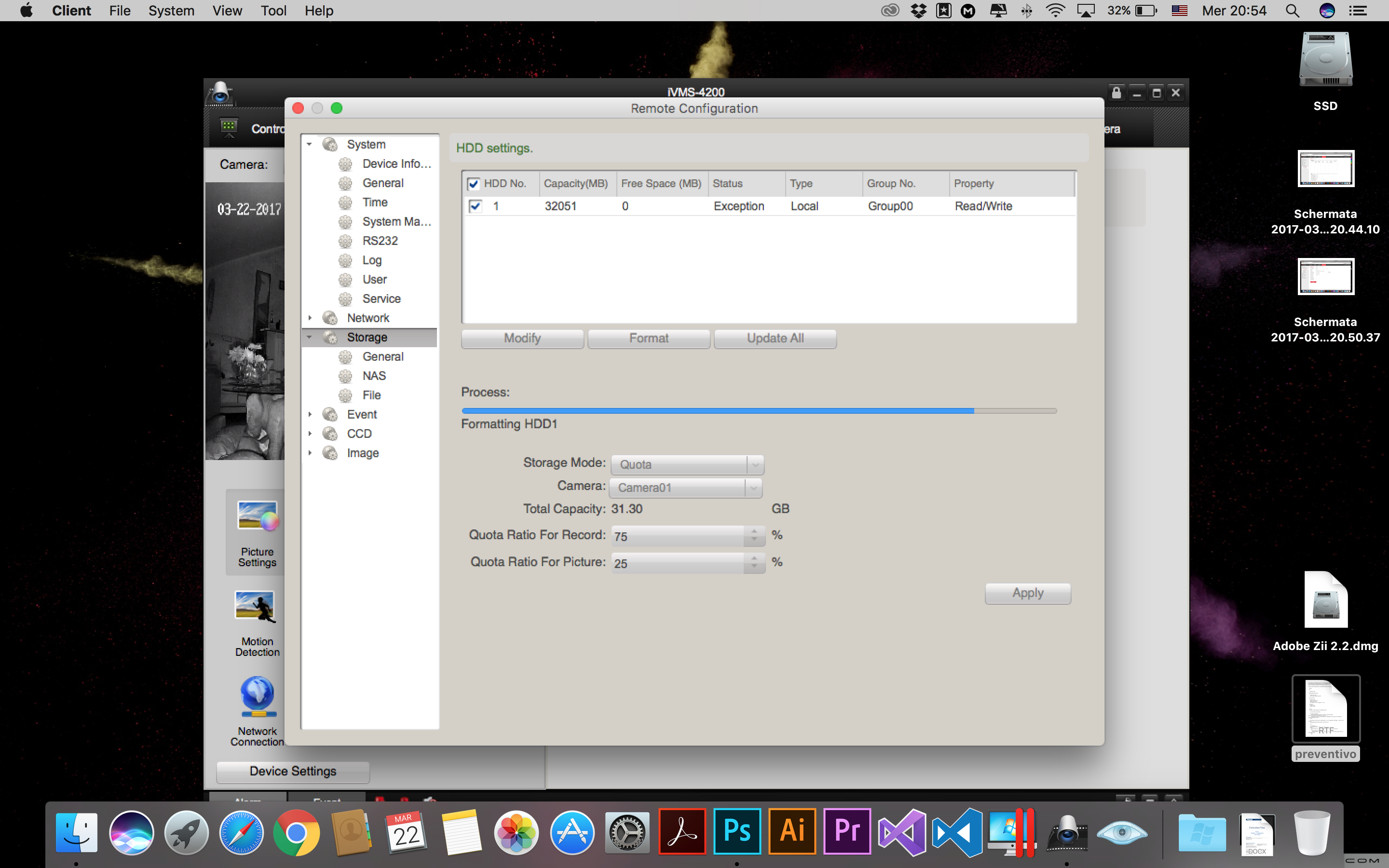

Micro SD not correctly format and at 99% start alarm, next in the page report no space avaible, error and so on...
If I start formatting again alarm stop, If I restart the camera no alarm but error remain :-/

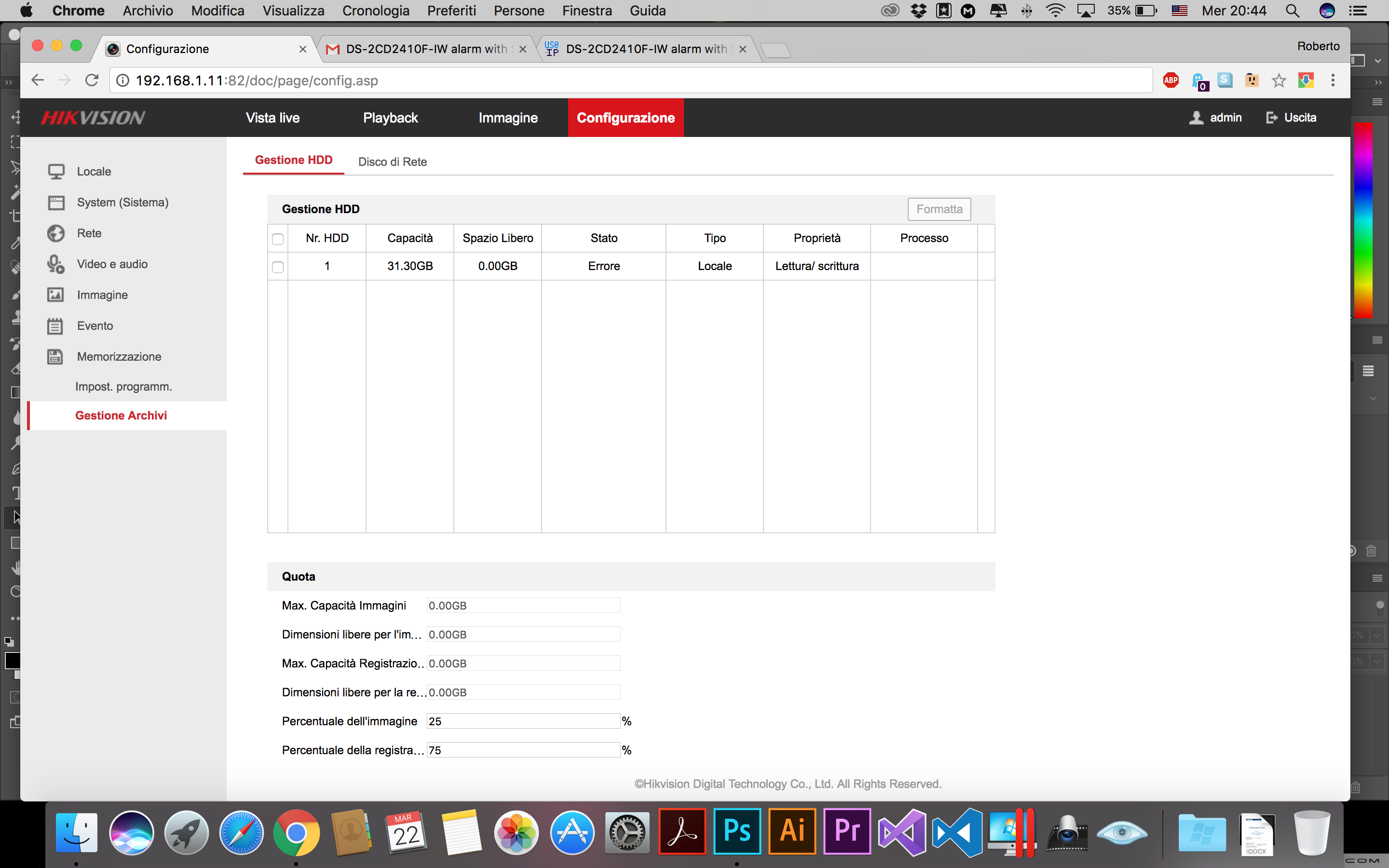

Would you be able to upload a screenshot of the Storage Management page, and what happens when you try to format?
Not right now because I'm at work and SD are not inserted, this evening I do a screenshot and post here
PIR disabled and now no alarm... that's something :)
I post a screenshot after formatting SD and It reports exactly Error Status and no FREE space avaible... have you got any ideas?
SD is a Sandisk Ultra 32 GB SDHC Class 10, I also tried a Kingston 64 GB SDXC Class 10 with no luck....
