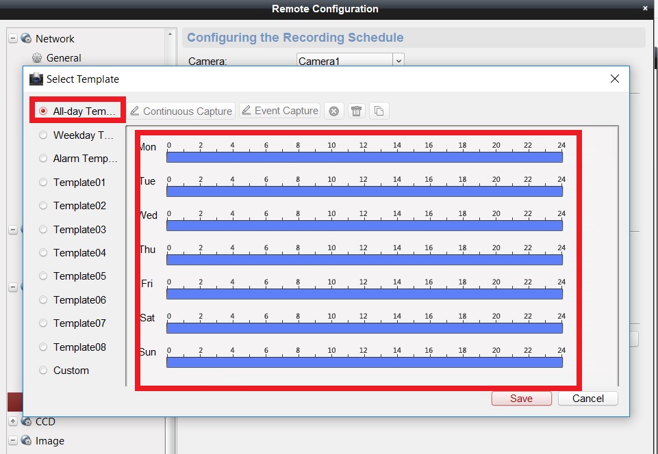

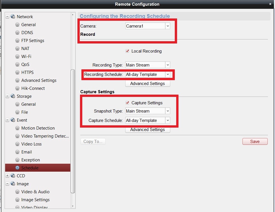

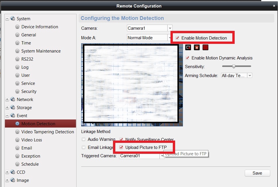

I need help with my new DS-2CV2Q21FD-IW (FW 5.4.4. build 170210) -the camera does not send alarmphotos to my FTP-webspace :-/

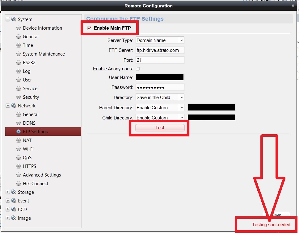

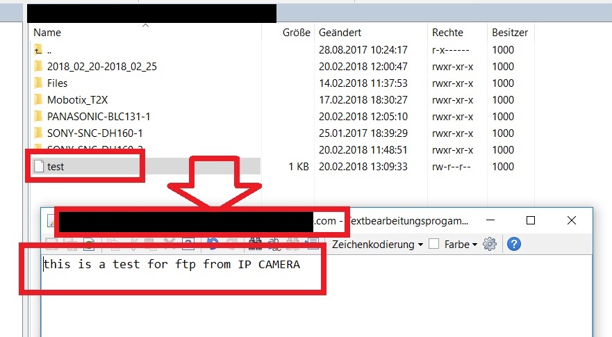

AA: The FTP config was done, FTP activated, saved, tested-->the testfile was created on the FTP-server.
BB: timesetup and areasetup performed, activated, saved
CC: but no file was created on the server during an event.
