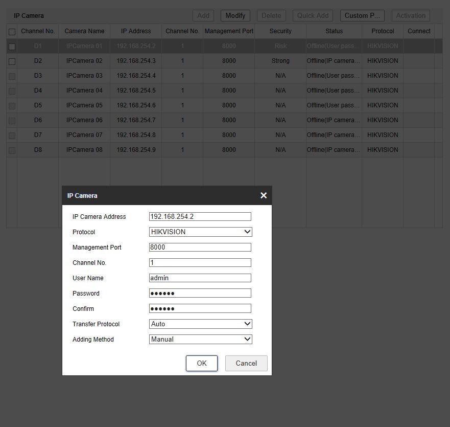

My problem is getting cameras back online. [System>Camera management] - all cameras are "offline (user password error). The camera IPs are defaulted to 192.168.254.x (see photo)
Clicking [Modify] and selecting Plug and Play doesn't work
Clicking [Modify] and changing to manual and adding the NVR user name / password for each camera doesn't seem to help.
Clicking [Activate] and entering NVR password doesn't help
Any advice on how to get these cameras up and running again?

Hi @kenzo33
This quite a common issue, I assume based on your camera IP addresses that all your cameras are directly connected to the PoE ports on the NVR.
If this is the case then what has happened is that when your installer first plugged the cameras into the NVR they will have been automatically activated with the NVRs original password and even though you have hard reset the NVR and set a new password for that, the cameras will still be using the old NVR password.
To get them reconnected you can either use the manual settings you have already tried but enter the old NVR password, if you don't know that old password then you will have to hard reset each camera and then reconnect/reactivate the cameras automatically with the new NVR password.
To hard reset the cameras you need to take the cover off the MicroSD slot on each camera and then follow the below steps:
1) Disconnect power to the camera
2) Hold the reset button down
3) Whilst still holding the reset button, reconnect power to the device
4) Continue to hold the button down for 30 seconds.
The camera will then reboot and power up as inactive and if it is still plugged directly into the NVR ports it will automatically reactivate the cameras and your cameras should be back online.

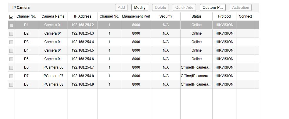

Brilliant. Thank you for taking the time to reply.
I think the issue is related to downgrading FW from 4.xx back to 3.xx - I wouldn't advise it
I did what you said and now the cameras show "online" but still no picture, just a grey screen. Anything I should be considering?
(just to add, the camera "clicks" after 30 seconds of holding the reset button)
EDIT: I needed to enter the new encryption key I created for HikConnect [Local>Live View Parameters] - thanks for all your help!
