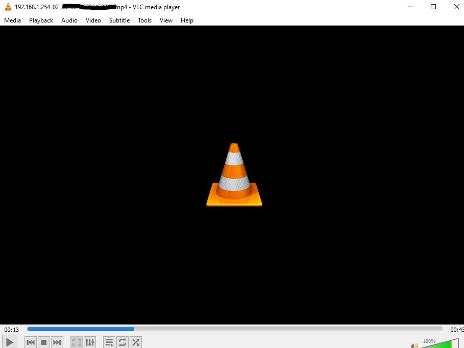

I am having issues with VLC playing back footage I've recorded from live view in the web portal. The record function shows that it is working and on stopping, it confirms that it has saved the file, however, on opening the file, I can see the time line moving along, but there is no picture.
VLC 3.0.11

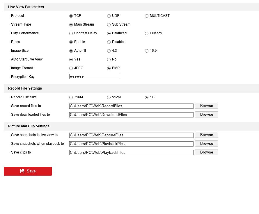

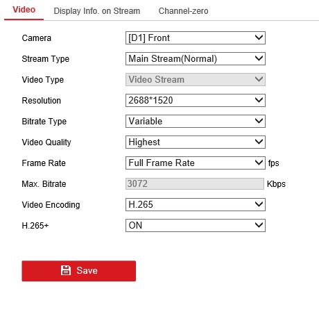

Please see the attached image for my encoding settings
The file plays, but nothing shows on VLC (see photo)

@kenzo33 it could a lack of processing power. try lowering the camera frame rate to 10 and try again with another clip from the web gui.

I switched video quality to medium, FPS 10 and switched of H.265+....It still doesn't work for some reason.

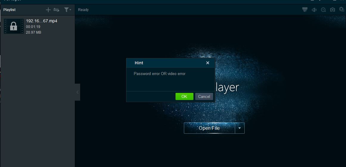

Good idea. I tried VSPlayer but get the following error (see attachment) when downloading directly in NVR web portal using IE
EDIT - it works if i click on the file in the left corner and enter the encryption key. Is there any way to bypass this and just play the file on VLC?
