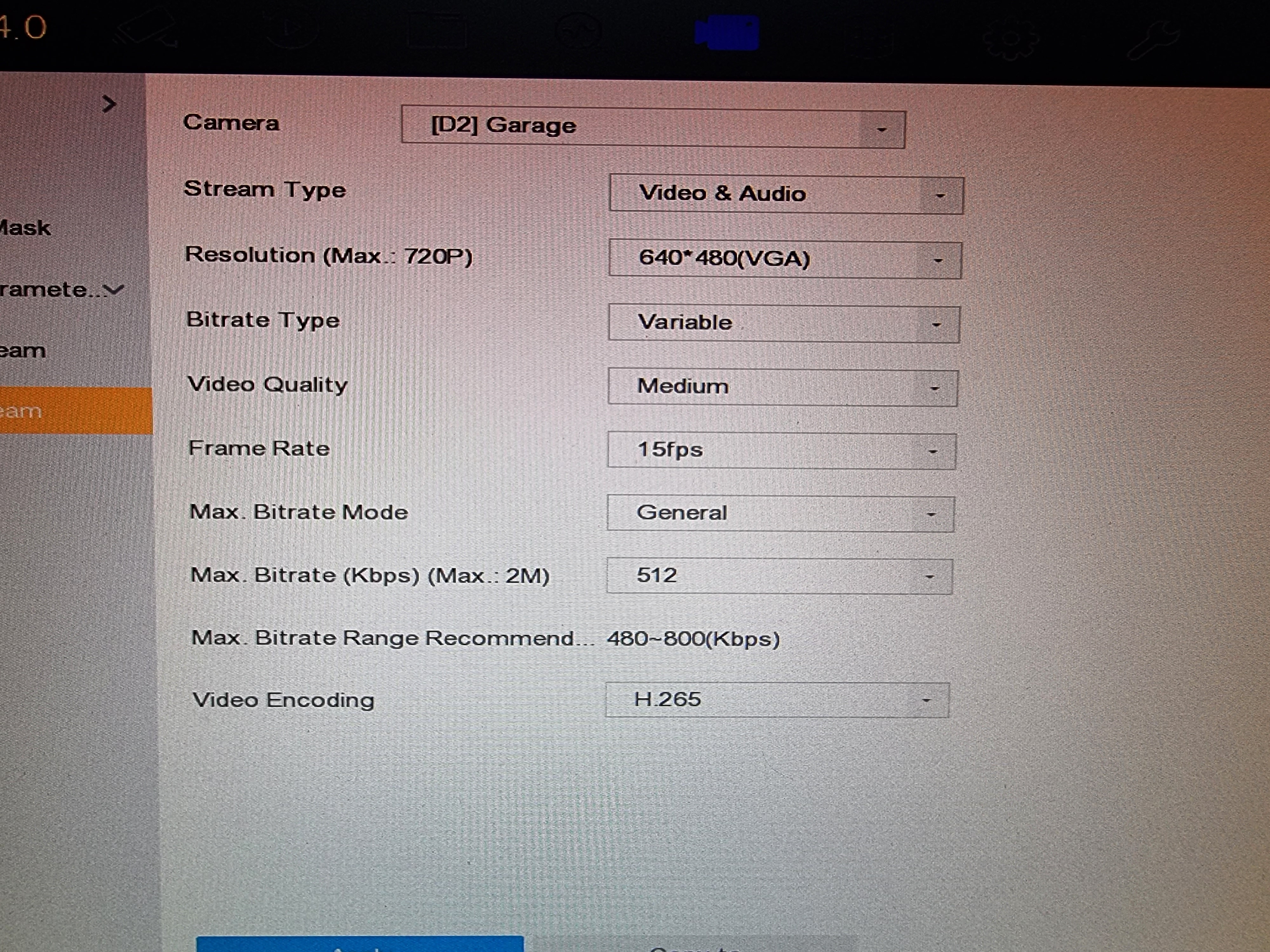

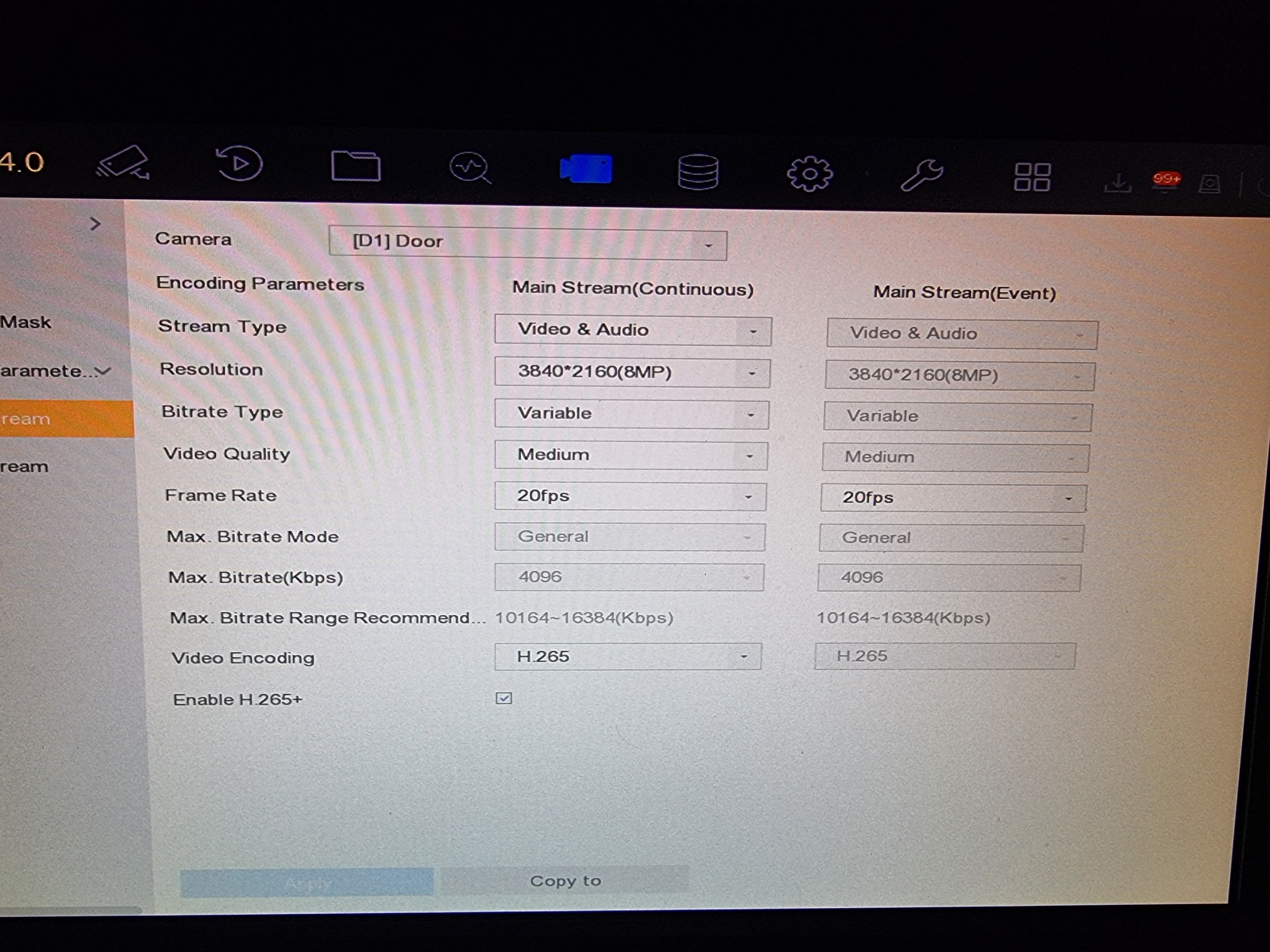

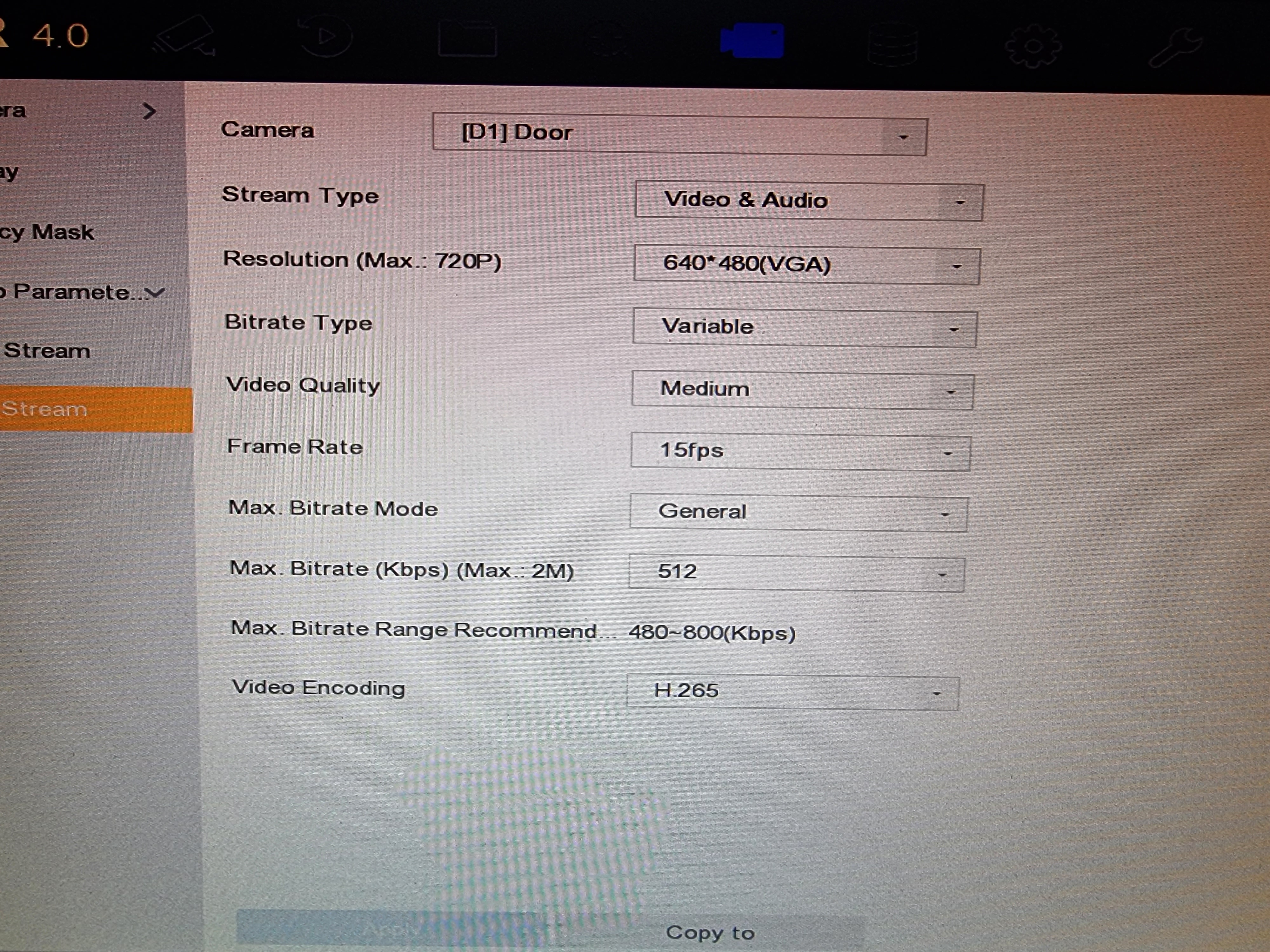

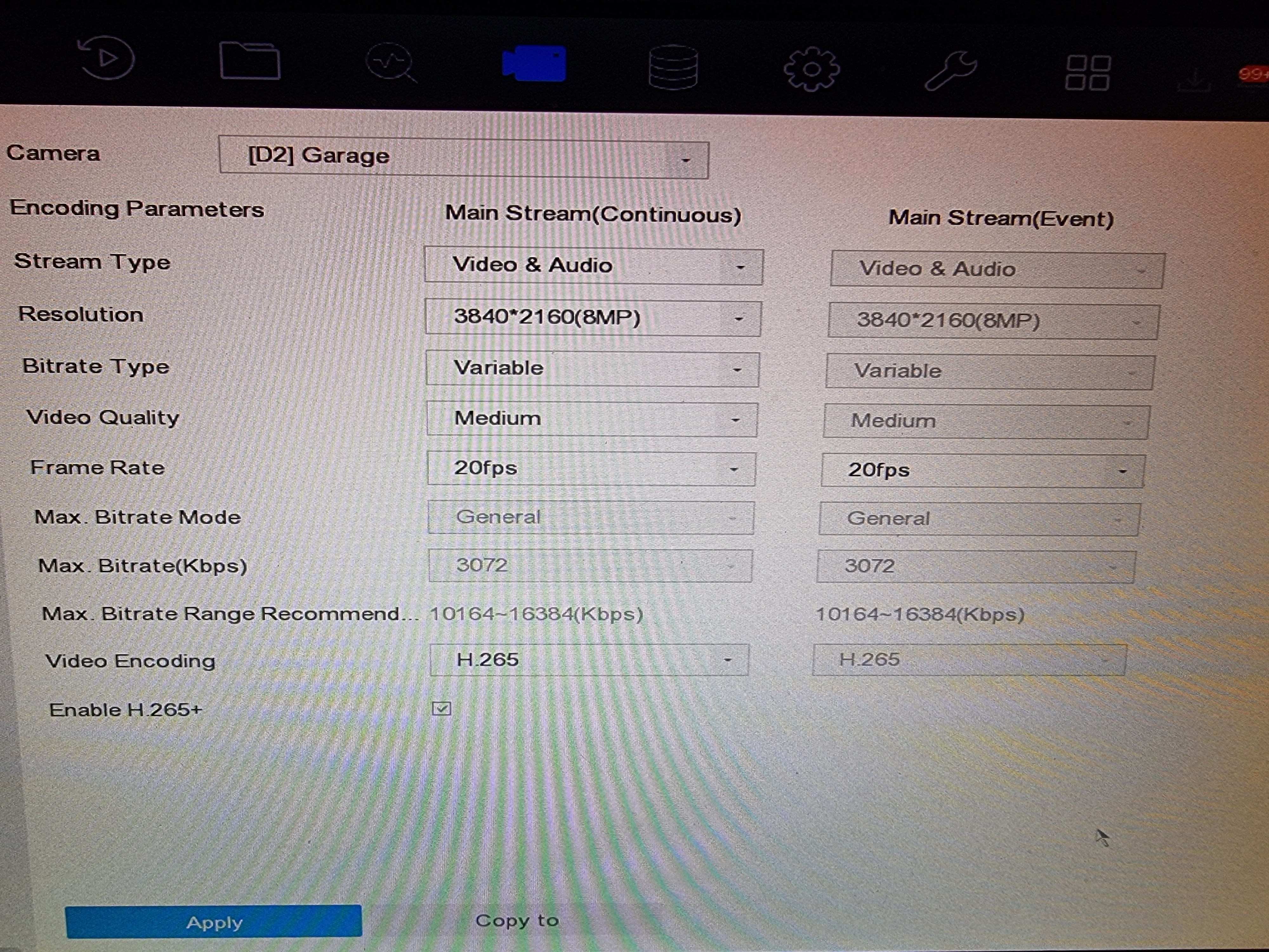

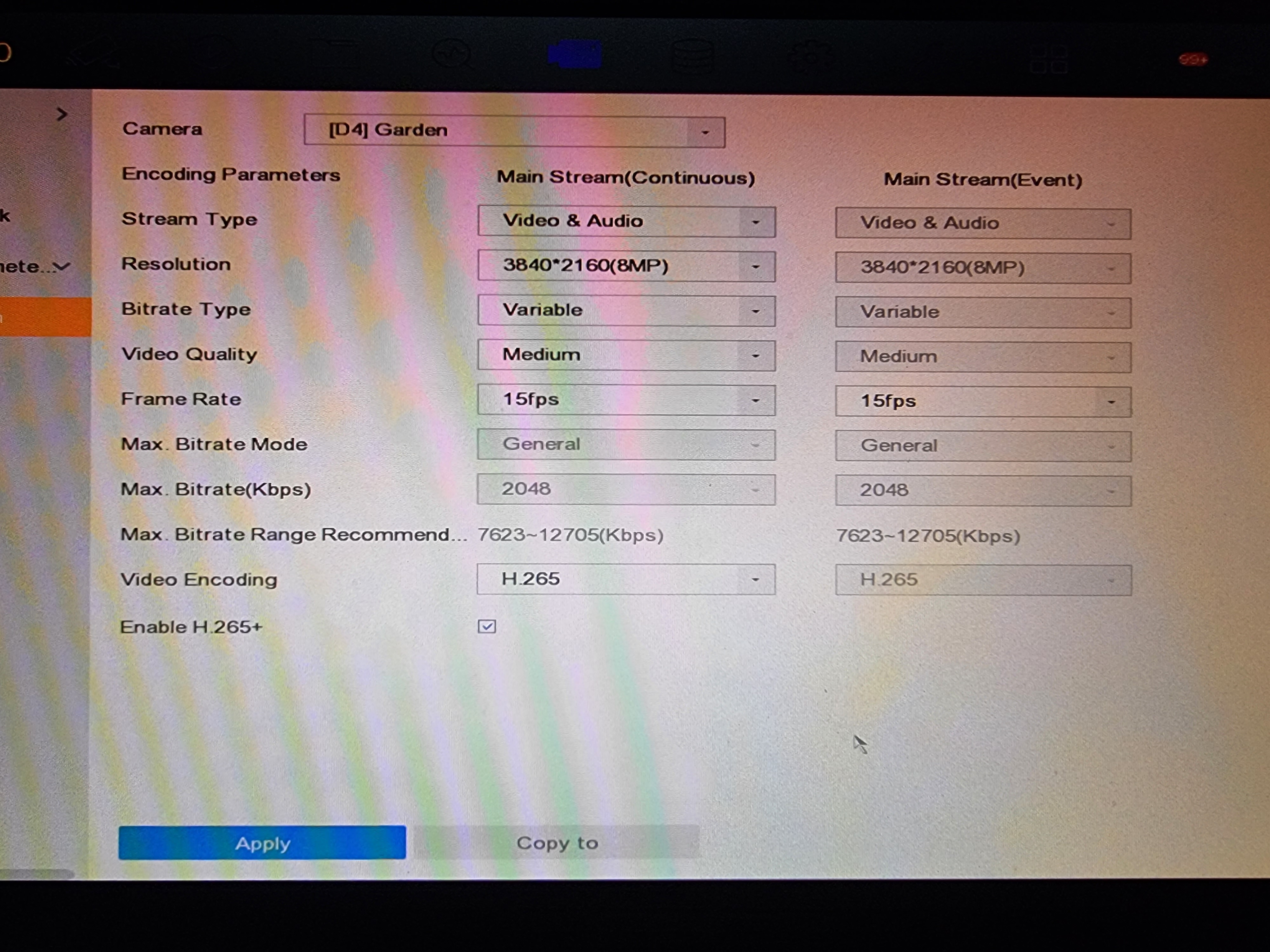

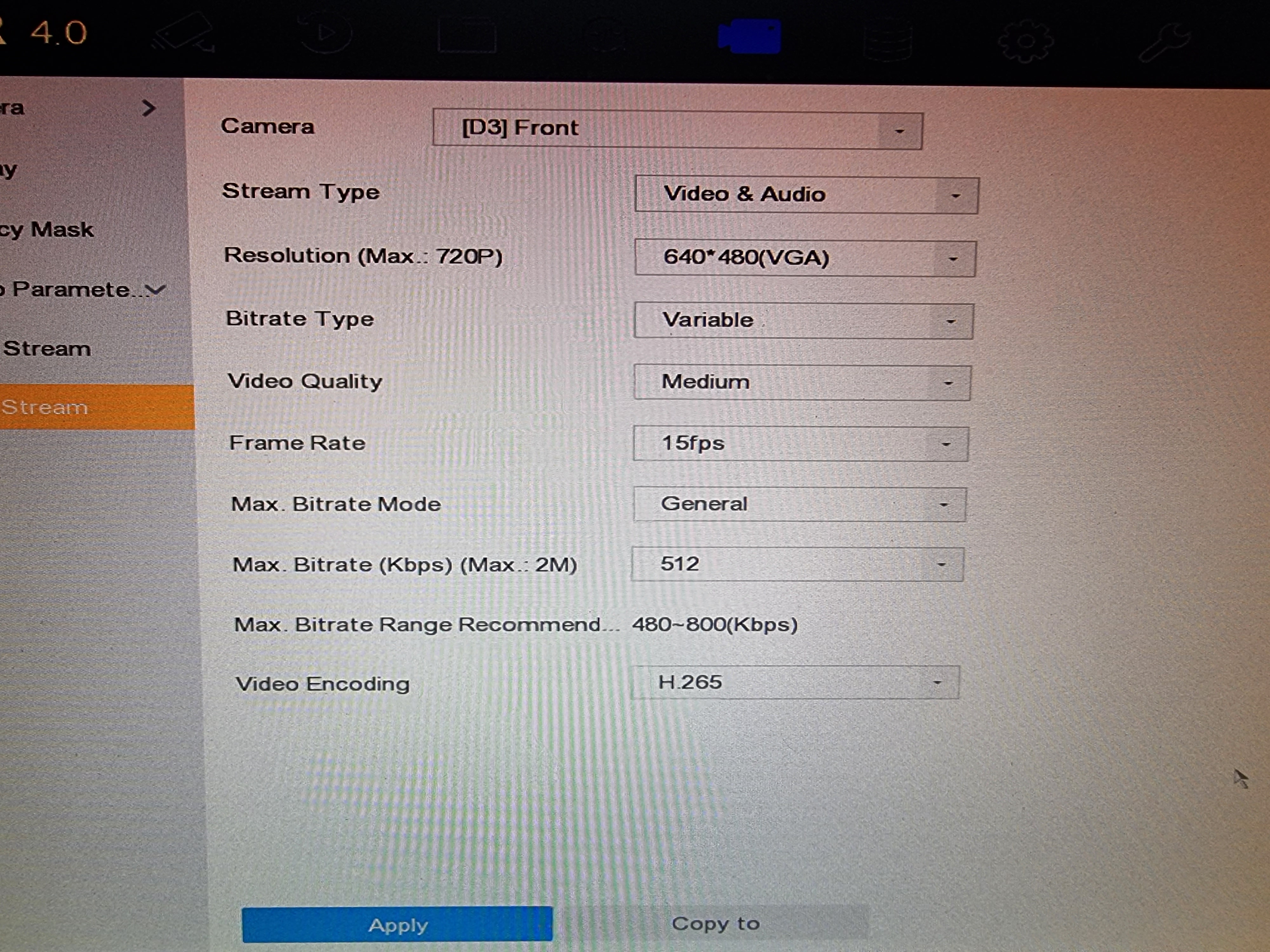

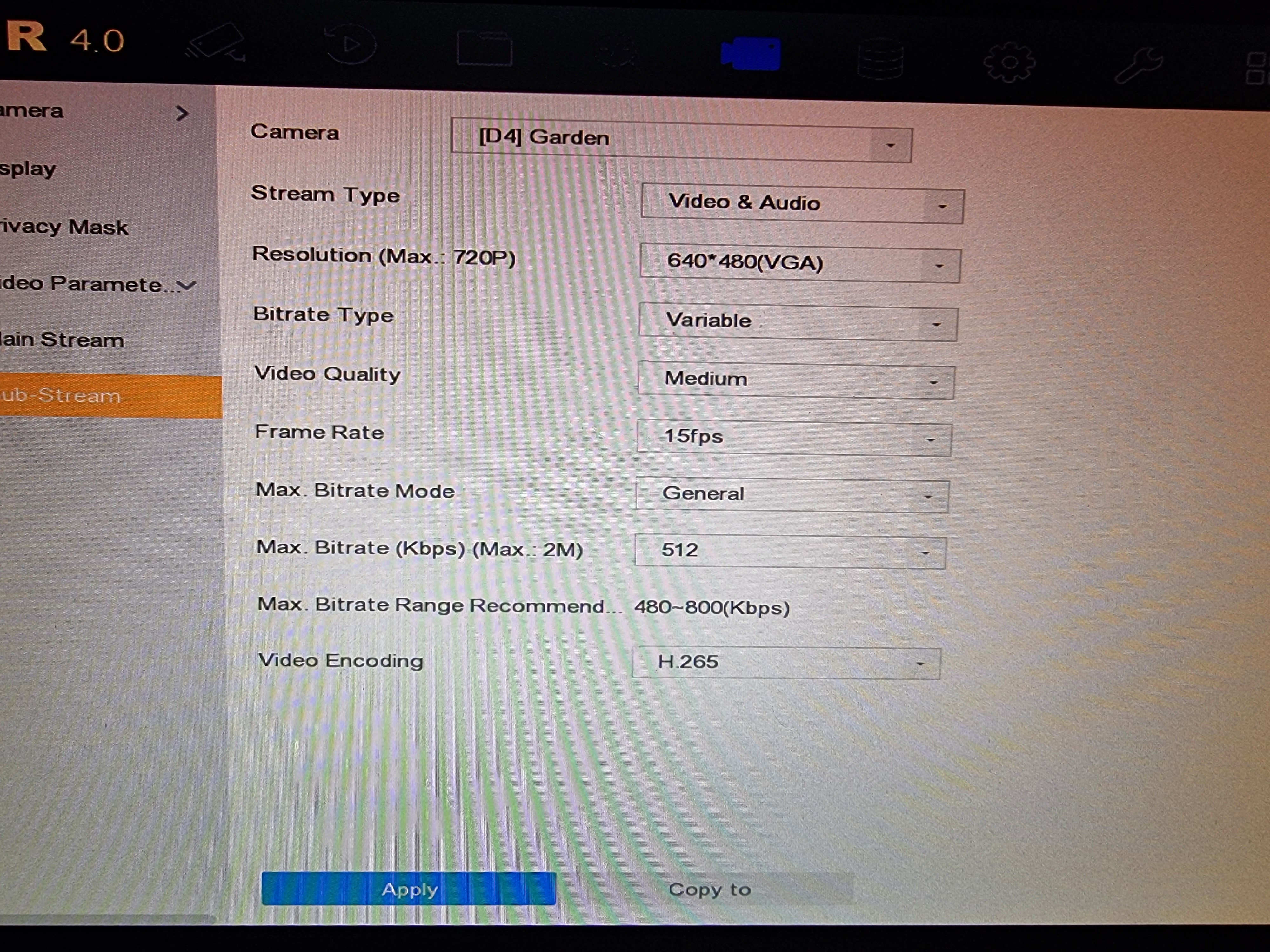

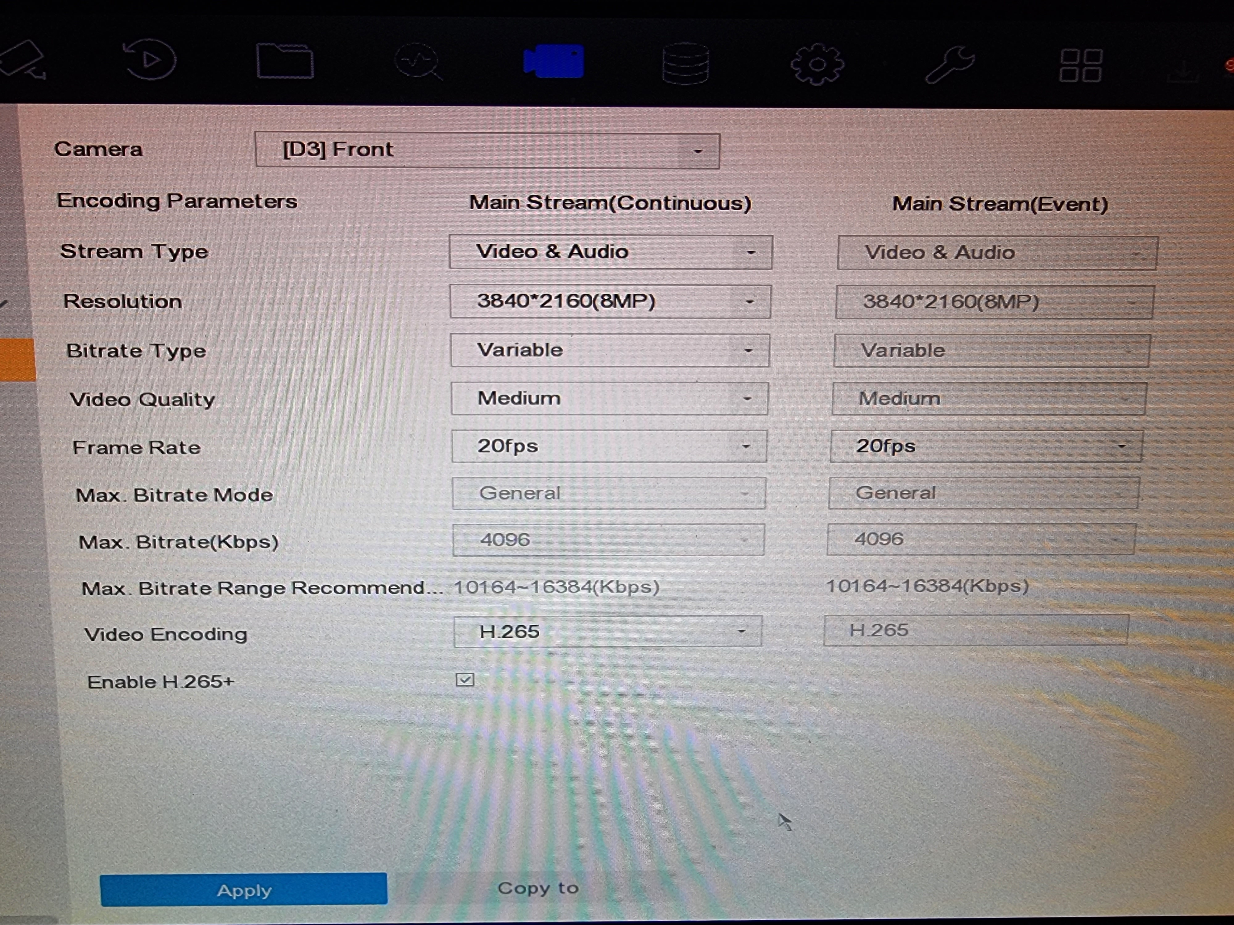

Could you post screenshots of your Main and Sub Stream video settings for all of the cameras, please?
It's worth rebooting the NVR and checking the playback after switching to H.265+ too.
Playback is jumpy both on NVR playback with a monitor and also Hikconnect, I've rebooted the NVR, it's made no difference.

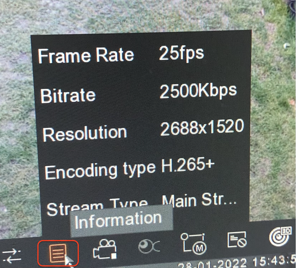

How do I find the fps and resolution on main stream?
Thanks David I will try that later.
On my NVR monitor I move the mouse to a screen and a black bar with icons pops up. Hover over the white outlined rectangle with white lines (information).

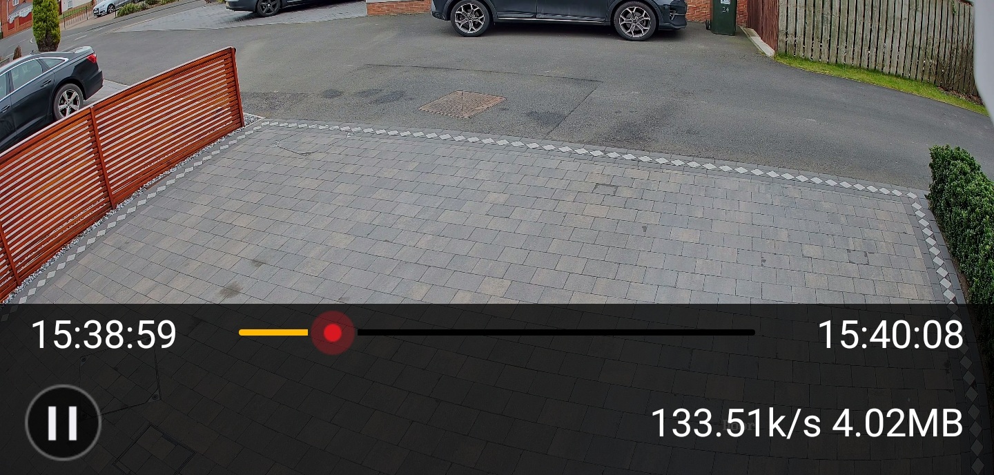

Is that the same as on Hikconnect?
See attached image from my NVR monitor. Dont use HikConnect for these tests, it could give misleading information.
