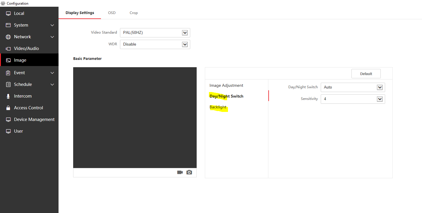

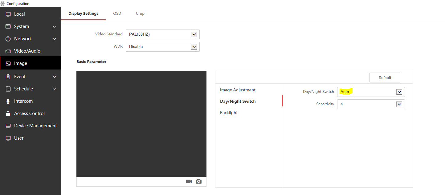

it is possible turned off Light ( inside led ) ?
yes, i believe so, those leds are turned on based on the sensor, i think you can turn it off in ivms, not sure though
here are some settings :
