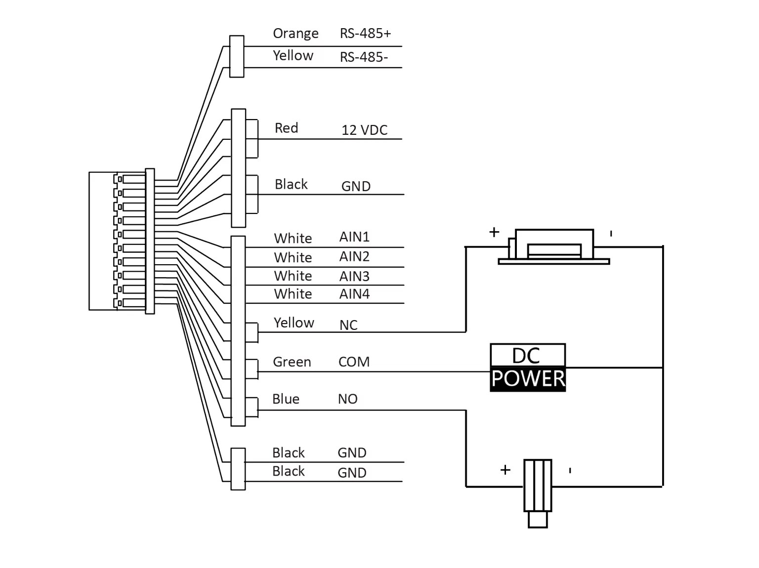

It depends how your ding dong is wired.
After changing the programming or relay 1 from Lock Output to Mechanical Doorbell, you could connect the common/normally open of the output (Green and Blue) across the bell push terminals. Unfortunately it might not work!
The issue is that when the call button is pressed that relay will close and open in about a 10th of a second. It's not possible to adjust that time. I reported the issue to Hikvision a long, long time ago and they responded that they'd forwarded my request for it to be either adjustable or set for longer to their HQ. Nothing has changed through several firmware updates so I expect it's fallen on deaf ears. You might find it works with a traditional wired doorbell, you'll have to try (and please report back whether it works).

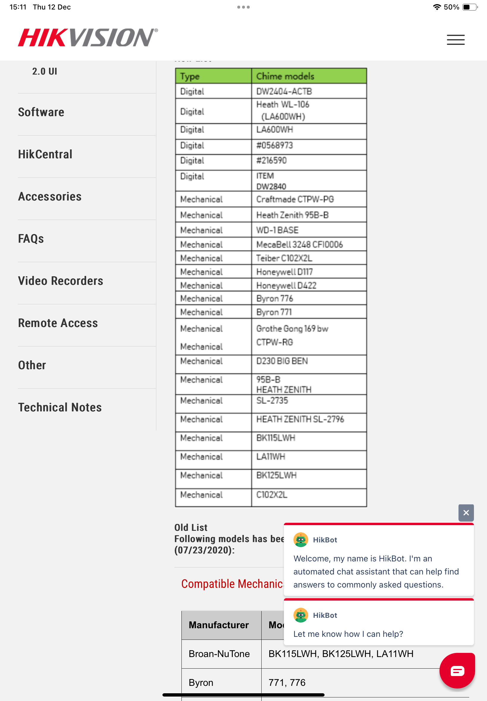

JB1970, I noticed that you had some success with a Byron wireless bell push, while searching I came across this on the USA Hikvision Portal showing compatible chimes, I know it’s a different model of bell push but 2 models of Byron chimes appear.
It might be worth a punt, but there are 2 models available, a 7v one and an 8 v one.

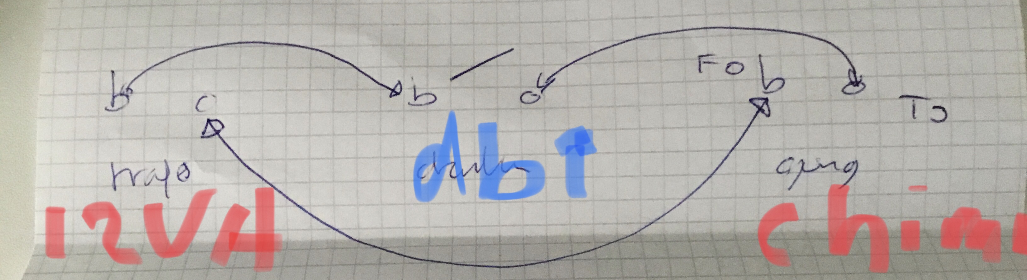

Sorry for adding a question here.
Bought the ds-kv6113-wpe1(c) to replace my ezviz db1 in which at first the normal doorbell was connected.
This situation works as pressing the db1 doorbell,the mechanicaL chime will ring.
I would like to replace the db1 with the ds-kv6113-wpe and power with the 2 powercords as below. Will then the chime still rings? (As i heard about the separate chime connection and selection?
Power comes from a12va transformator in the central metercupboard.
Only for additonal info, not part of the question, I also have a byron by32 convertor attached to the chime to extend the chime signal in a mobile chime further away in the house.
All works as a charm, expect the db1 that is failing with spooky calls without actually some body at the door.
in addition to previous, the above situation works for the chime only, when connected to the blue and green cables on the DS-KV6113 (after selecting the mechanial chime in the menu). I was able to pull an extra cable for POE powering, so this is working as expected.
