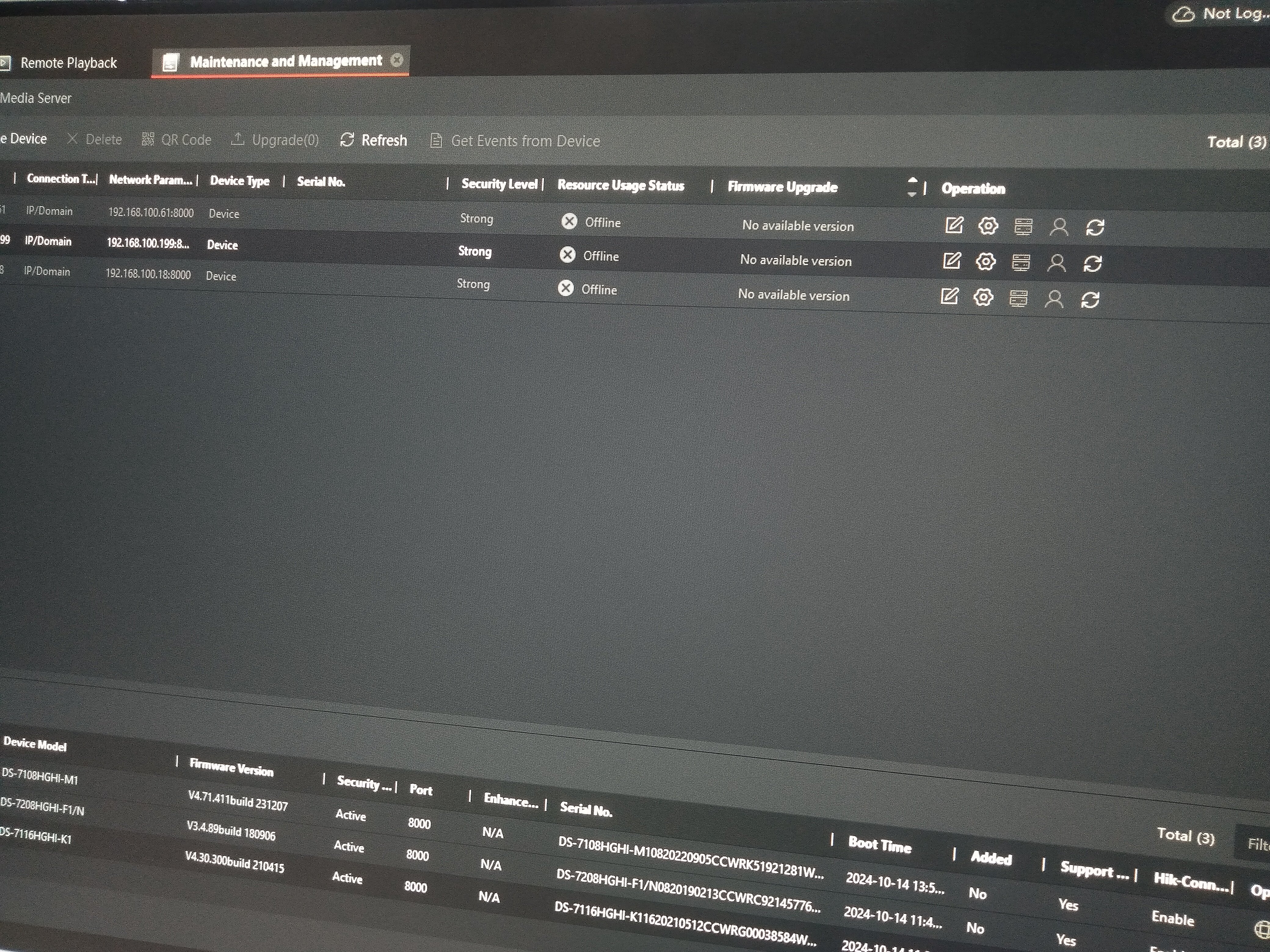

I currently need help, my DVRs are showing offline yet connected to the router for data transmission. I have tried to update firmware using ivms but it failed.
Attached is the picture from the management tab.

In the 'Online Devices' section at the bottom of the device management menu shown in your screenshot, are DVRs listed with the same IP addresses as the ones added to the device list?
Thanks for the response @Dan.
Nothing has charged with the local area Network, same ISP and i restarted the router about 4 times but still getting the same errors.
Yes the IP addresses that are added are showing the exact IP address as those on bottom. Data transmission is there as I'm able to ping.
