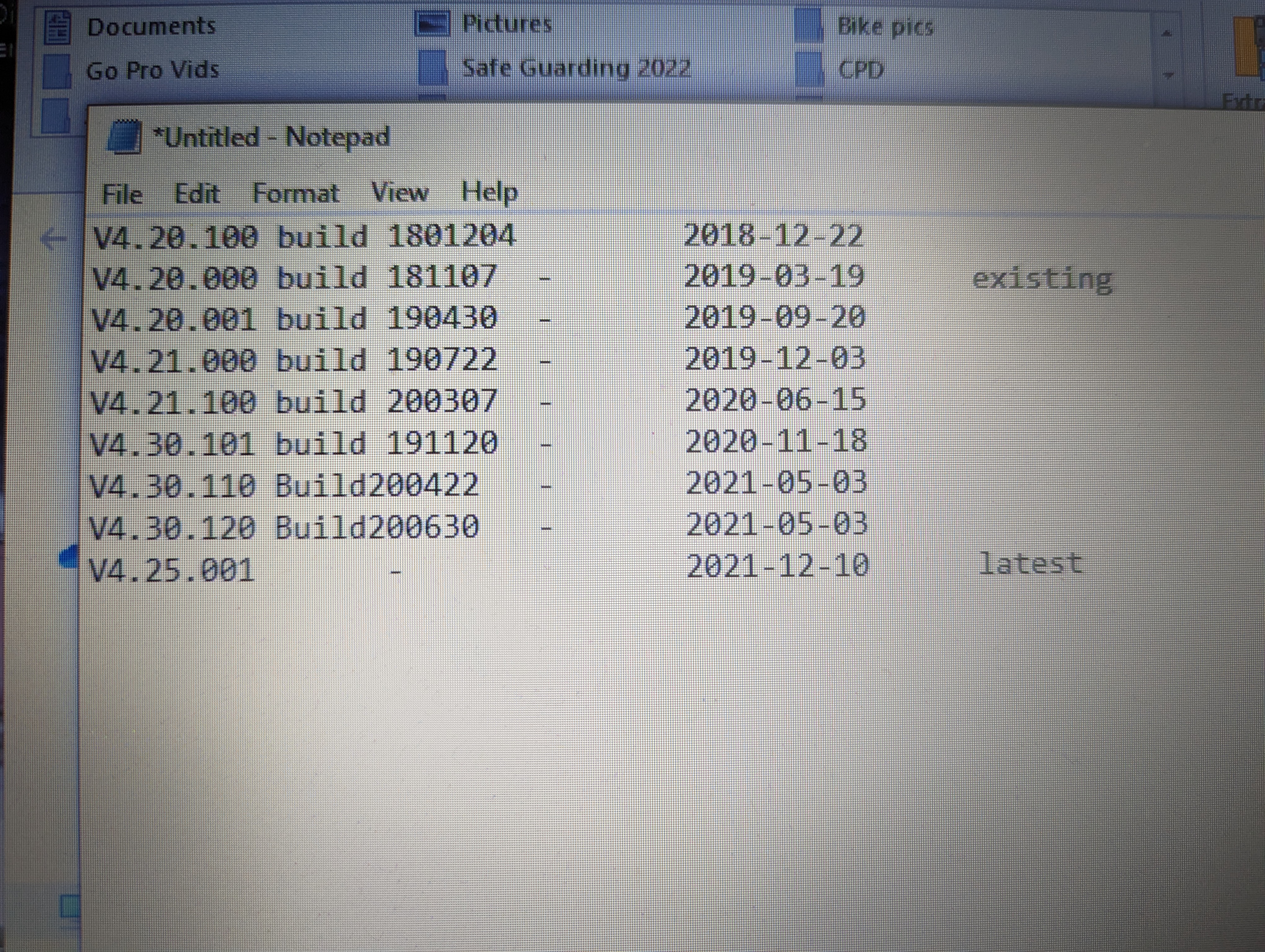

I can get the latest version of firmware (v4.30.120 Build 200630) to upload to my DVR via usb, or appear like it has. However after it reboots it is still showing the old version (v4.20.000 build 181107). Do you know what the issue here is please ??

Can you also share a screenshot of the NVR's System>System Settings>Basic Information page from the web interface, please?
It's from the Hik Vision Europe site (UK and Ireland been down for a while). Attached image shows the existing firmware and latest as per the Hik vision site. I tried the version after mine and again it looks like it's worked but after a reboot the firmware is still showing as the old.

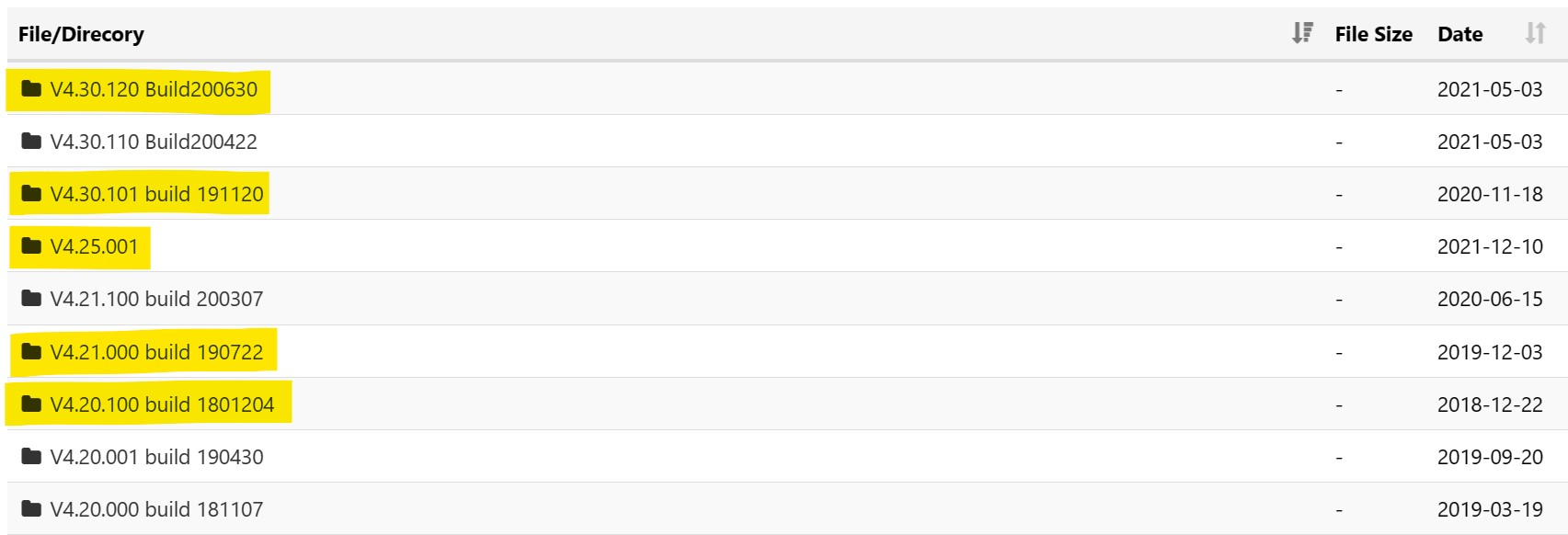

Thanks, I've found the folder, it looks like the European portal is definitely updated the most regularly:
It might just be too big a jump, try updating in steps via the versions highlighted below:

I can see you're using Edge, running this in IE mode should allow you to upgrade in the web interface which will be quicker:
