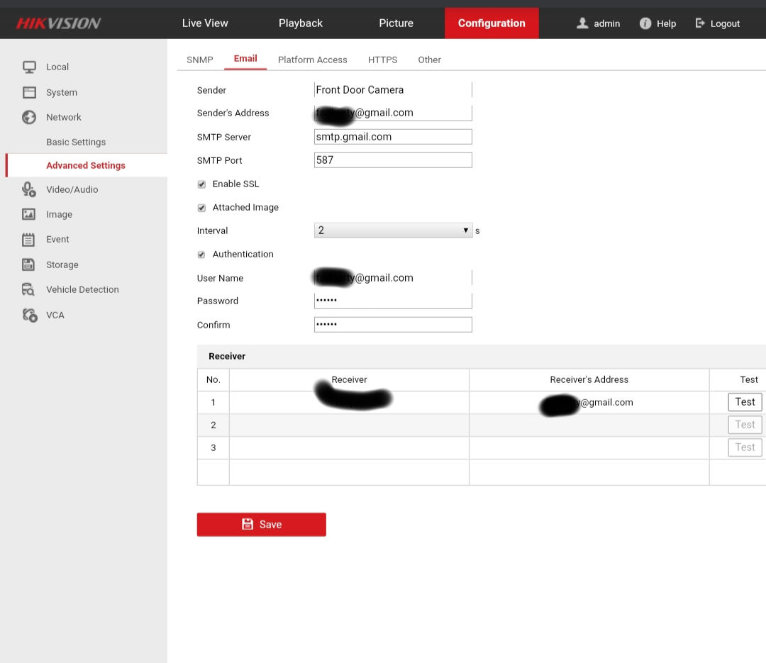

I have managed to set up the email notifications on the NVR, even though I have selected attach pictures, no pictures are being sent.

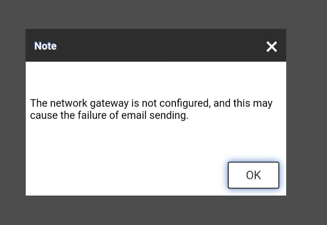

I read somewhere, that it's worth setting up the email notification on the actual IP camera itself. However, when I select "Test" I get the following message "The network Gateway is not configured. And this may cause the failure of email sending"

Set it up on the NVR.
Since you are using Gmail, have you enabled "less secured services?"
Hi, thanks for he reply.
I have set it up on the NVR. The email comes through without any attachment of the picture....also I have enabled less secured services.

I have read somewhere that the IP camera should be connected to the internet independently without the NVR?
Have you set the gateway (your router's IP address) in the NVRs network settings?
It easily slips under the radar as it is called 'IPv4 Default Gateway' in the settings.

Hi Phill,
So once I have setup the POE injector it seems like I am recieving emails with picture attachments for Motion sensor. Result!
So it seems like the appliances are happy to comply when the IP camera has its own connection to the internet really.
