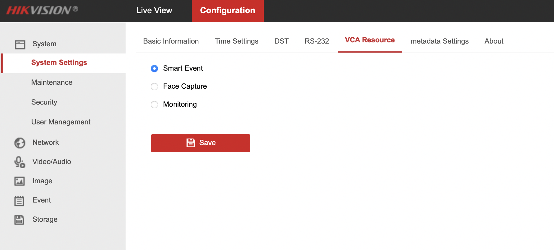

You don't mention whether these cameras are standalone or connected to an NVR. Either way, first you need to ensure that the cameras VCA Resource mode is set up for face detection. Although you may have enabled the Face Detection check box in Smart Events; it won't work unless the VCA Resource is set correctly.
Go to the settings page in the camera (not the NVR if you're using one) and navigate to Configuration > System > System Settings > VCA Resource. By default the VCA Resource is set to Smart Event as shown below:
Change that setting to Face Capture and click Save. The camera will probably reboot to alter the setting. Face Capture settings can then be applied in Smart Events as usual.
Note: Enabling Face Capture disables other Smart Events, so Line Crossing, Intrusion Detection will no longer work.

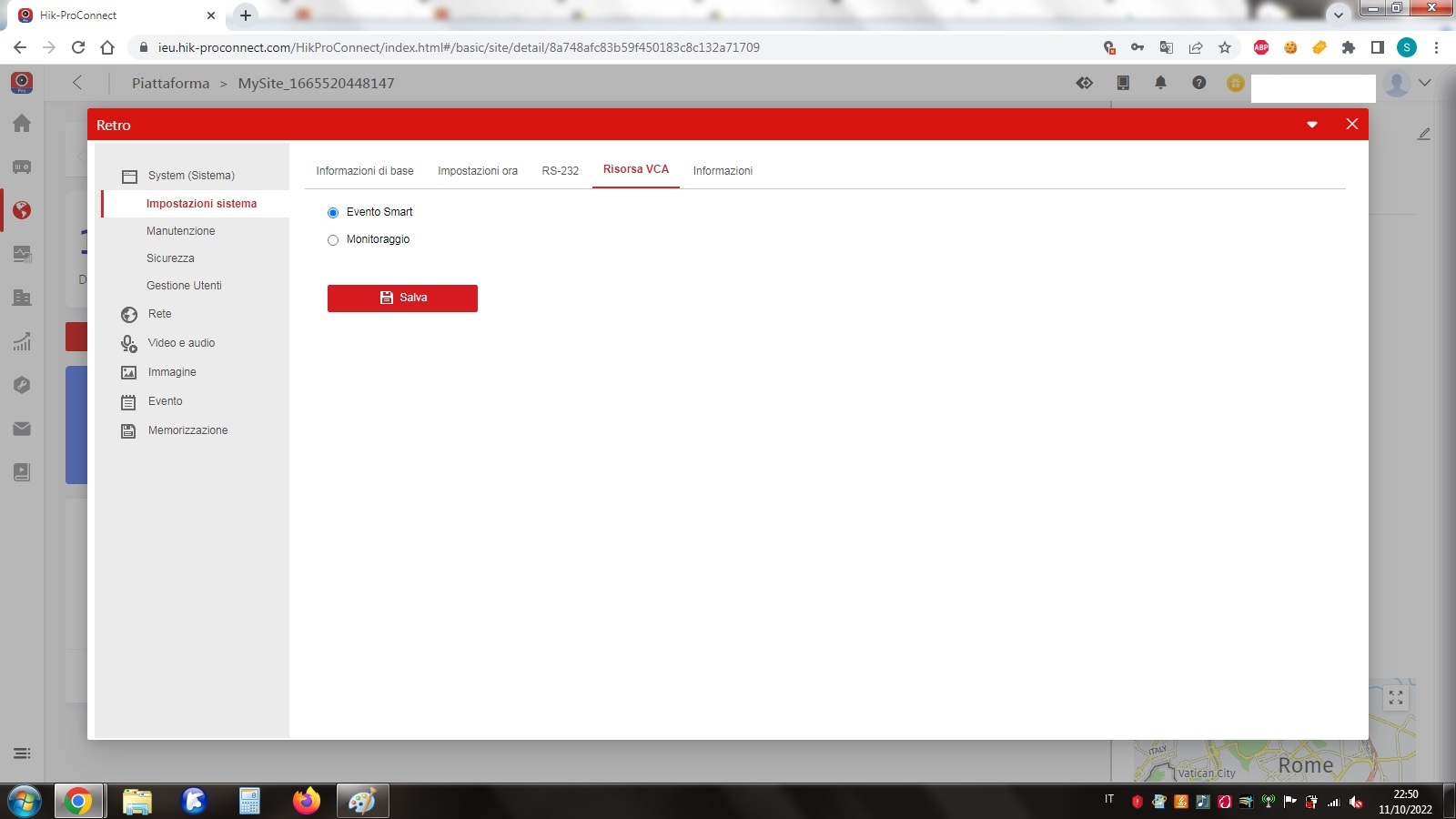

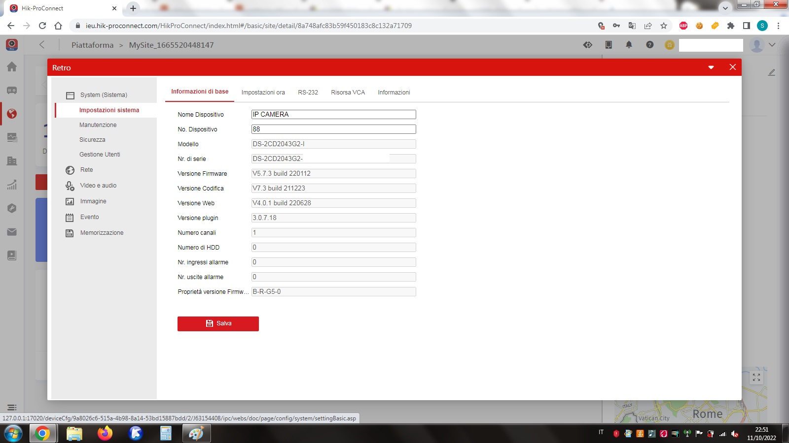

i don't have an nvr but single cameras, but i don't have the voice: face capture in the settings unfortunately. do you think it has the latest update?

Just to confirm, is the issue that you're having that you are not receiving push notifications for face detection?
If so, I've spoken to Hikvision HQ about this recently and they have confirmed that face detection does not support sending push notifications, unfortunately, either directly from a camera, or from an NVR.
Their advice was to use intrusion detection with "human only" filtering enabled instead, as apparently face detection on the EasyIP DS-2CD2xx3G2 cameras isn't all that reliable yet.
I cannot find your existing firmware 5.7.3 build 220112 on the Hikvision UK Portal, have I found the right camera model?
yes yes the model is DS-2CD2043G2 - Will I be the latest update?

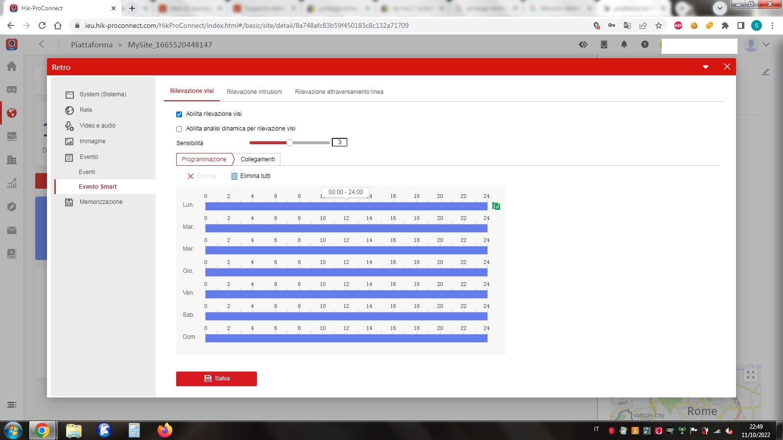

do you think this can go as a setting for human detection? I never understood how I have to set this option thank you very much

hi, can anyone help me configure the camera to detect people only, excluding false alarms? I do not know what to do
