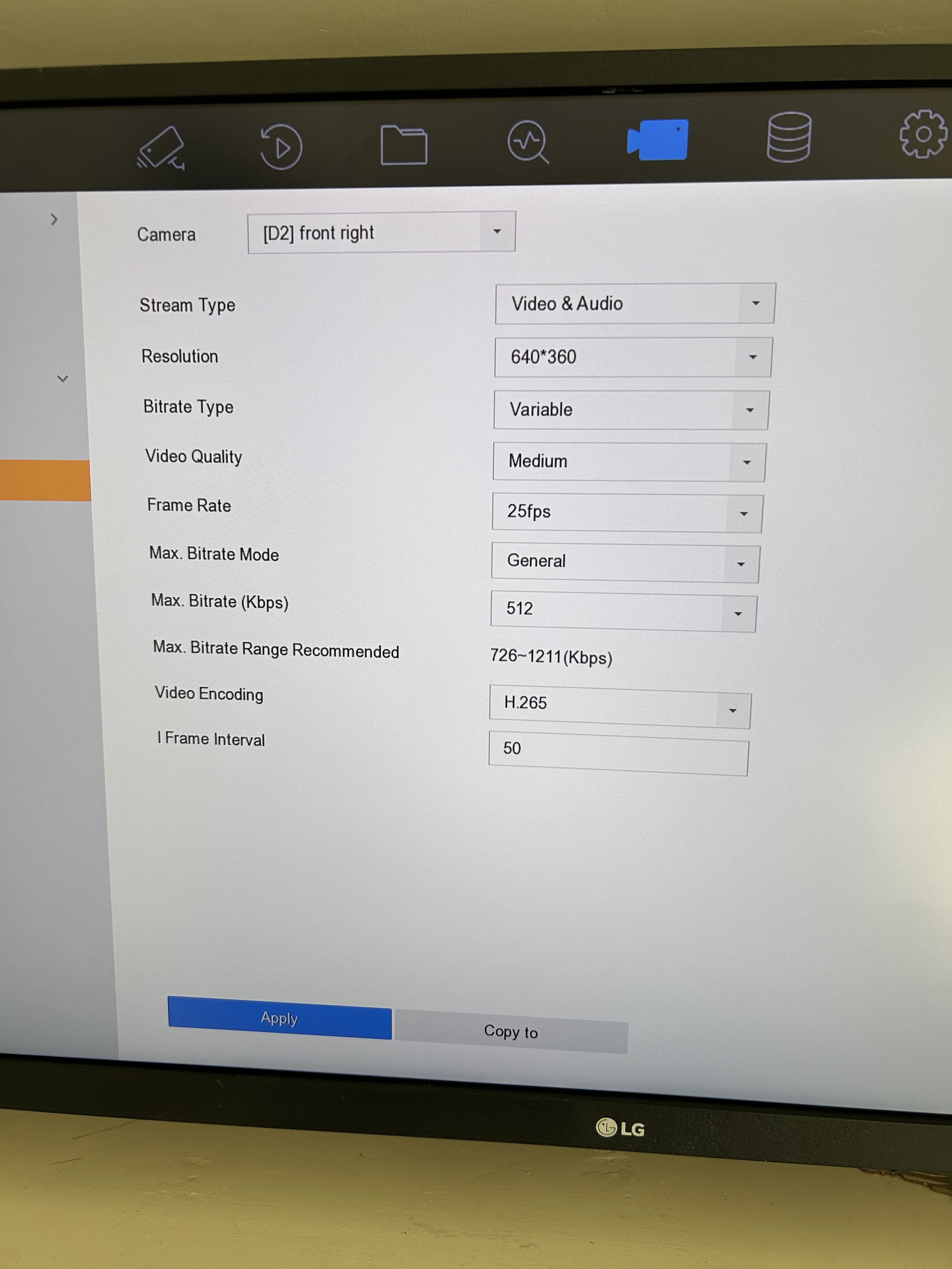

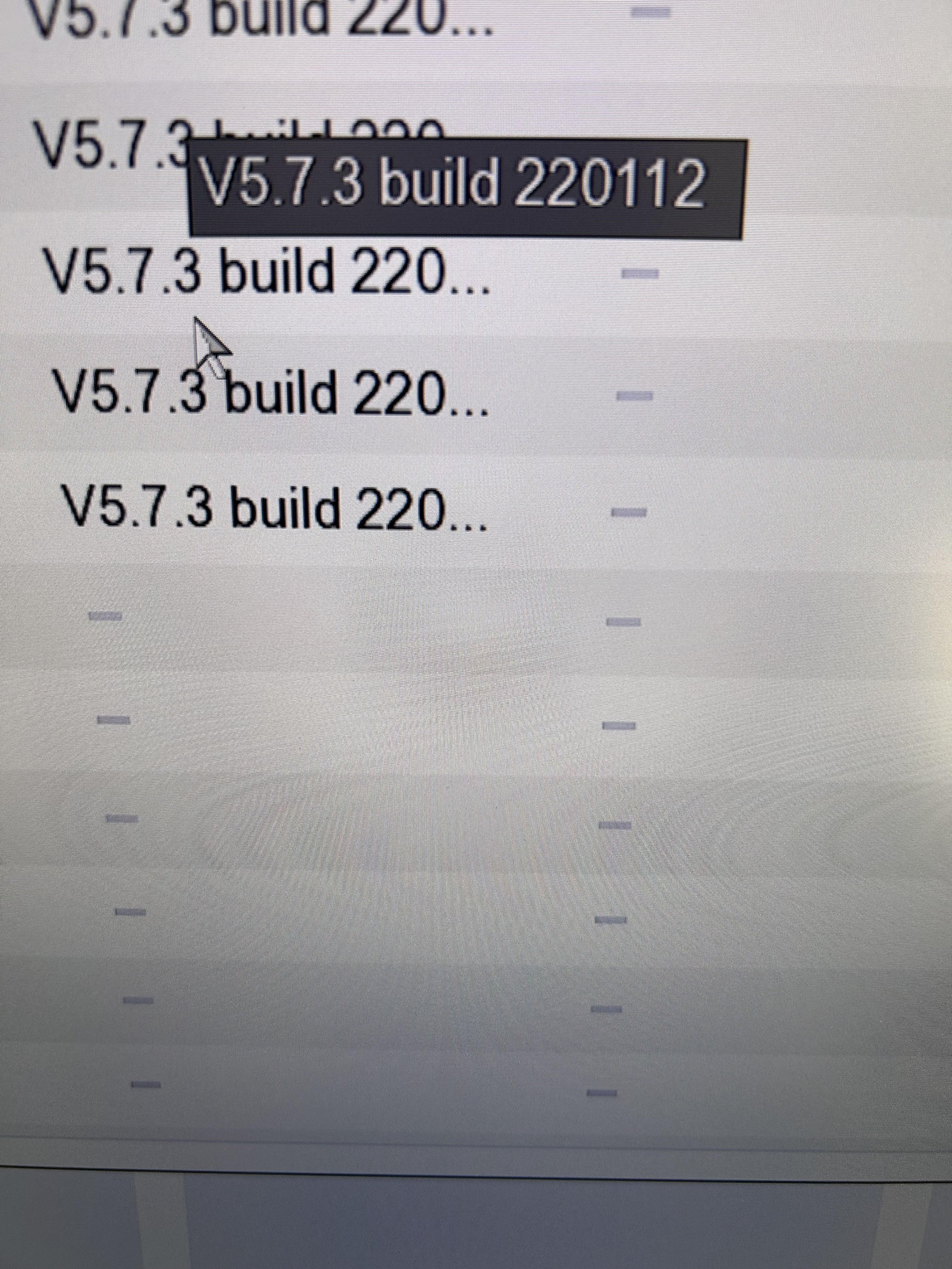

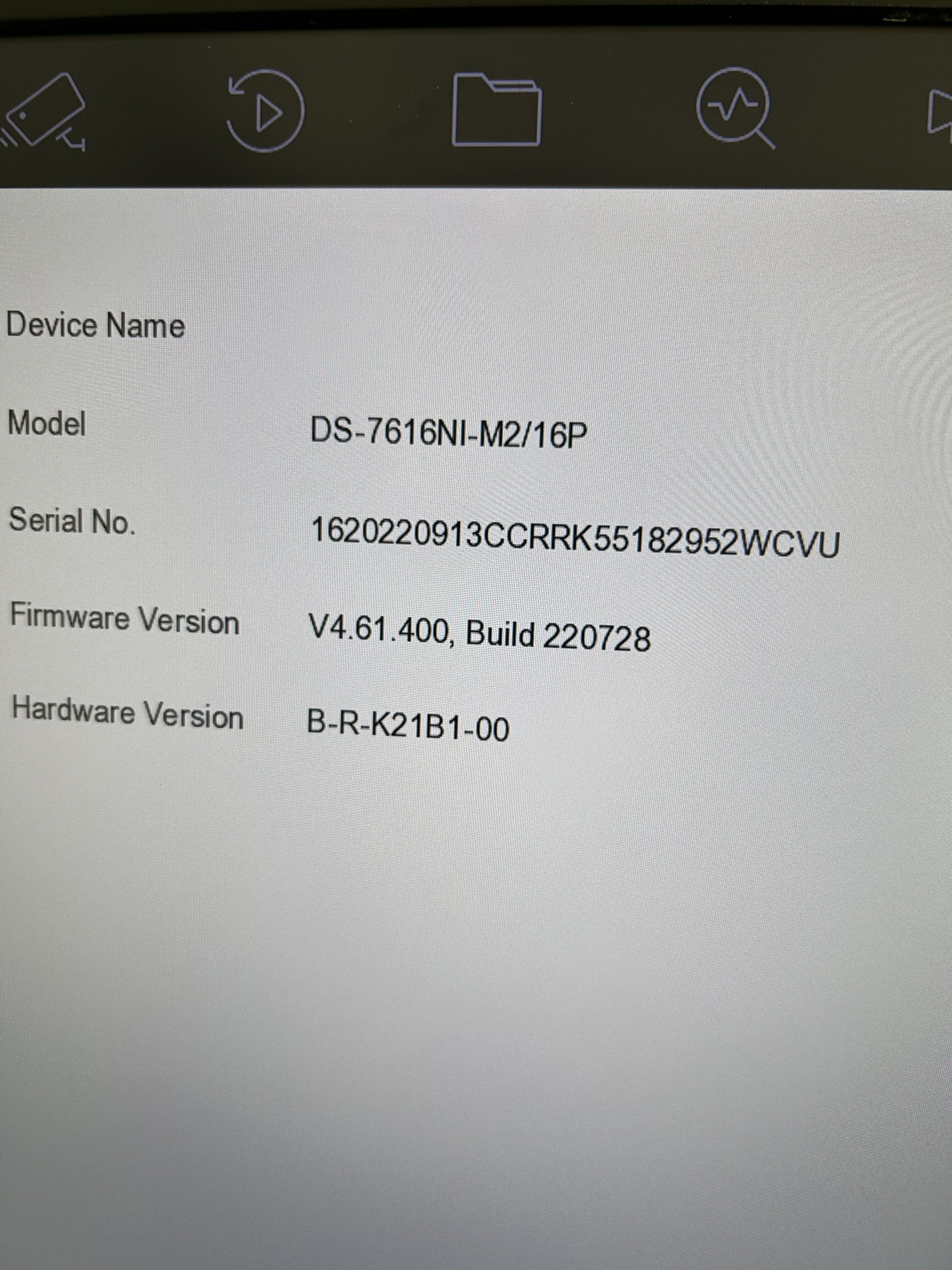

Hi, exposure was 1/25 but I just changed it to 1/50 seems abit better.
Info attached.
Info

Thanks @Kilojade
The latest firmware versions are below:
NVR - V4.63.020_230808
Camera - V5.7.13_230706
using a faster exposure time/shutter speed like 1/25 or 1/50 will have the greatest impact on reducing motion blur, but you can also try disabling image settings like DNR, WDR, HLC, etc... to make further small improvements.

Ok thanks mate. What settings make it less jittery? Like if a person walks past it’s not smooth just abit jittery.
