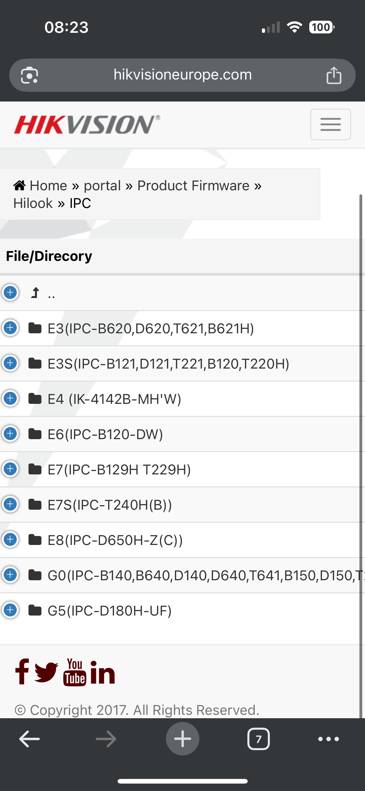

For the cameras I cannot see my models listed. The are Hilook cameras by Hikvision model IPC-T259H. One the firmware portal they seem to have every camera apart from mine listed. See attached. Any ideas?
And thanks again for the help.

one other alternative is to search your cameras model on Global Hikvision site and go to RESOURCES to see if there are any new firmware there:
another option is to search on Hikvision PORTAL:
- EU PORTAL: https://www.hikvisioneurope.com/eu/portal/?dir=portal/Technical Materials/00 Network Camera
- UK PORTAL: https://www.hikvisioneurope.com/uk/portal/?dir=portal/Product Firmware/Hikvision/03 Front Ends
