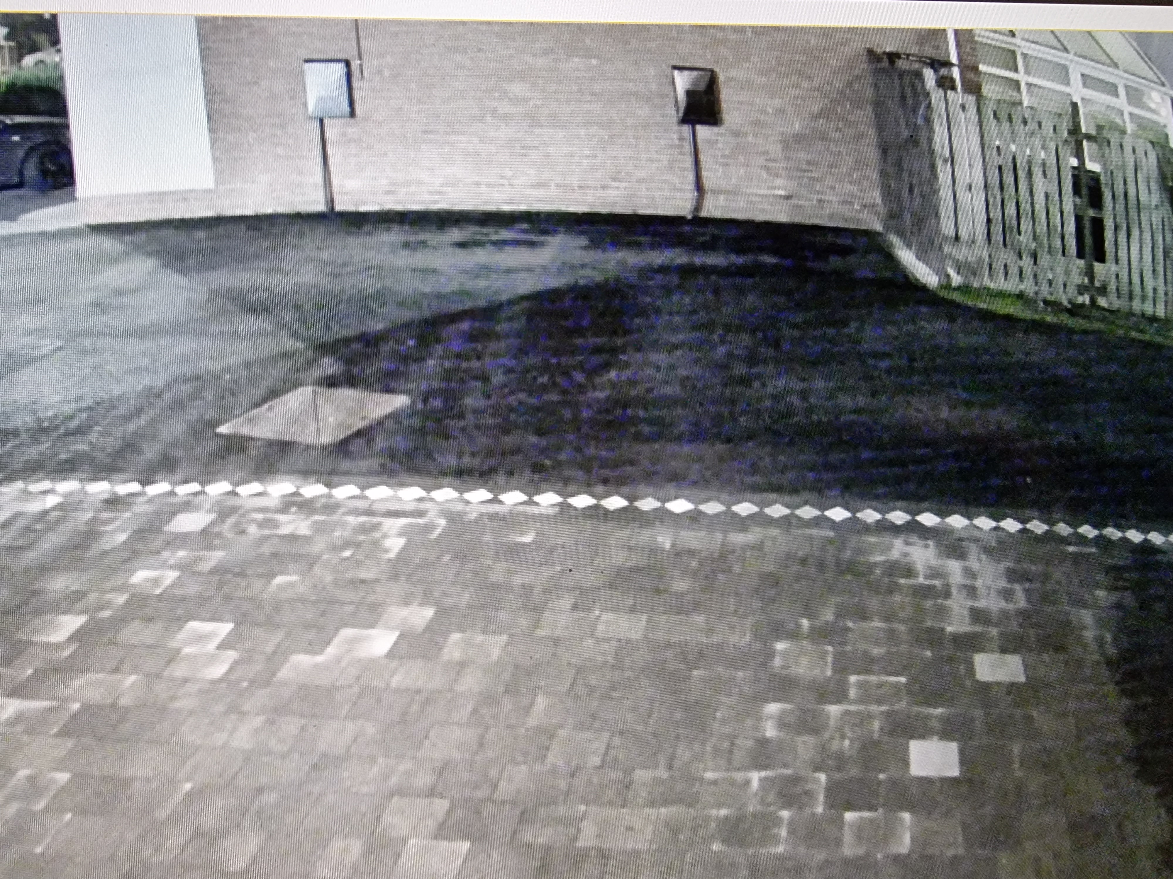

On two of the cameras (front) there are flashing horizontal lines only when it's dark.
I've tried changing the exposure time but still the same.
Could it be caused by the LED light I have at the front door?

It's quite possibly the LED light. I get similar - not so much flashing but scrolling through the image. Simple test - just set the exposure time at its out of the box 1/12 sec and turn the lights off to prove it one way or the other.
It stops when I turn the outside light off but I've tried lots of different exposure times and the lines are still there.

At the front I have two of the cameras about 5 metres apart directed toward one another. Beneath each is an identical light. So one side is a mirror of the other. I can see the lines on one but not the other. What will always be different is the view. One of mine has more sky visible and this makes the lines show more prominently - it's across the entire image but only perceivable in certain areas.
The other thing that makes it more visible is WDR. Switch it off and it will practically disappear (at least it will not be noticeable)

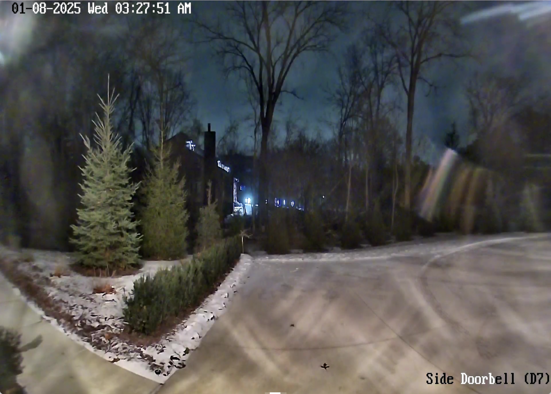

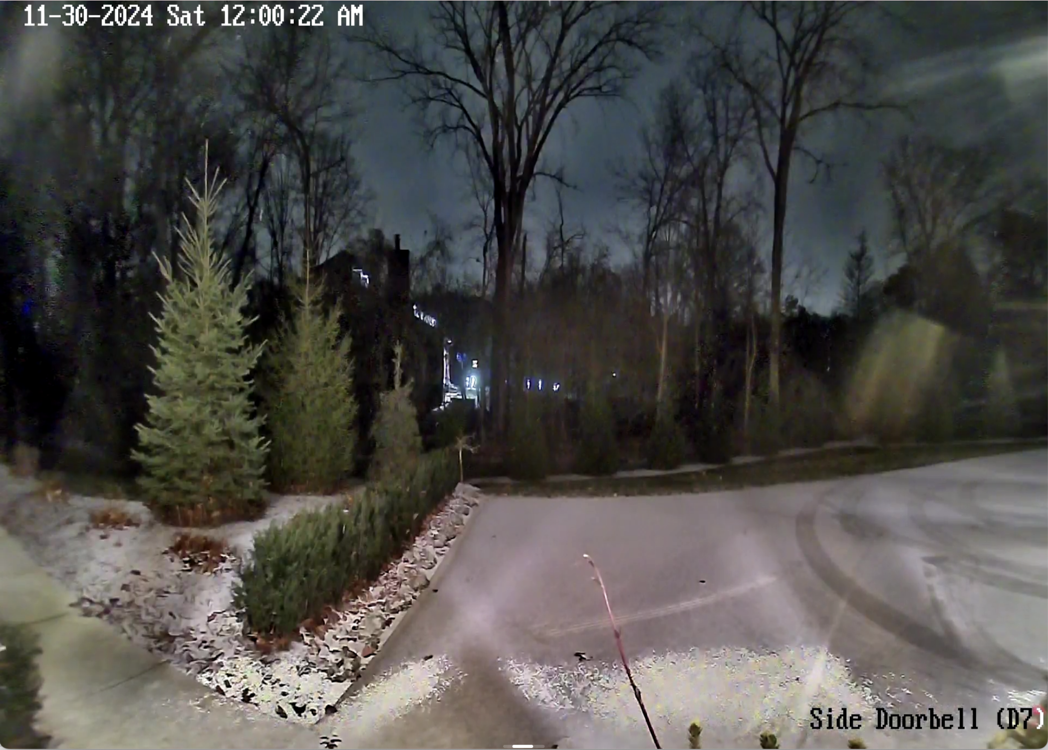

I have a door station unit (DS-KD8003-IME1(B)) that was causing a similar problem. I tried all different settings and could not get it resolved. This cam was installed on a newly built house and the homeowner wanted to change out outdoor lamps. They changed the lamps which required new bulbs because the bulb base was different. The builder originally had installed some cheap led bulbs and the home owner bought some really nice bulbs to fit into their lamps. Once these new lamps and bulbs were installed, the issue went away.
I have some screenshots below so you can see the difference. Unfortunately, that door station doesn't have the best cam and the lens is dirty and needs to be cleaned. But at least you will see the difference before and after.
Before: you can see the noise at the bottom of the image. It would either have this or lines and then drift outwards.
After:
