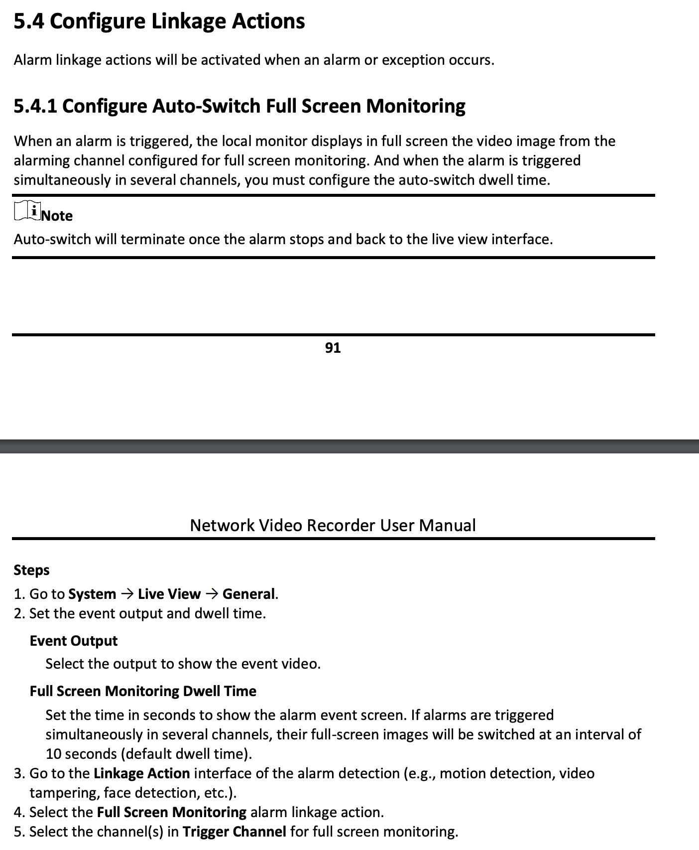

Hi @Womboman
The user interface has changed a bit on some of the newer NVR models so they might have moved some settings around.
'Full Screen Monitoring' should be possible if you follow the below instructions:
Hi @Womboman
