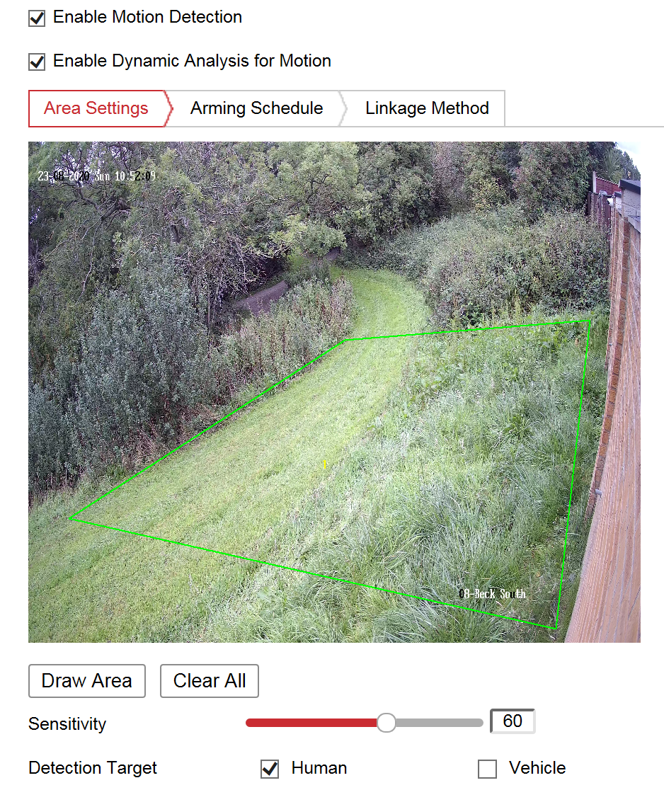

I'm not sure what's happened with the motion detection in the latest version of firmware for AcuSense G2 (G3 5.5.135) but it's been fouled up monumentally.
In earlier firmware (possibly 5.5.131), the motion detection was drawn as a polygon (rather than enabling a range of cells) but the firmware only allowed a 4 pointed shape. To cover irregular areas you would need to draw more than one (up to 4) non overlapping regions. There was an issue in this version where if you drew for example 3 small regions. When you went back to the setup screen later - region 1 would have changed itself to a full screen rectangle encompassing the other regions. Effectively overriding your region settings.
In 5.5.134 it was changed so that you could draw a multipoint shape to cover irregular areas. As stated in the release notes -
Optimize motion detection
1) Interface optimization: The rule box is optimized from quadrilateral to polygon (maximum decagon, minimum
quadrilateral, concave and convex sides are supported, cross lines are not supported); the new "Clear" button can be used to delete the selected area.

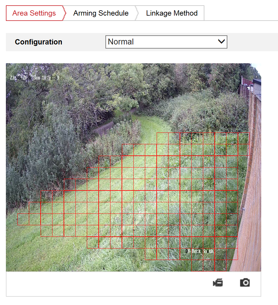

In 5.5.135 it has reverted to how it was in 5.5.131 - 4 point shapes maximum and the bug where region 1 resizes itself to full screen. In addition if you login to the camera GUI directly, you're back to selecting cells as a grid, rather than drawing a shape AND the Human Detection filter option has disappeared.
1st image is from NVR web GUI, 2nd image is from camera web GUI

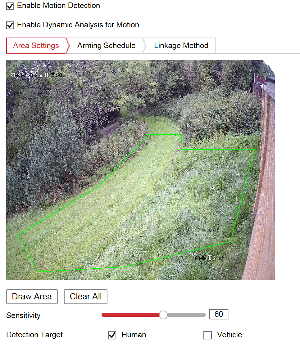

As can be seen in the images below - reverting to version 5.5.134 restores the multipoint region, replaces the grid with the polygon in the camera GUI and restores the Human/Vehicle filter option in the camera GUI.
