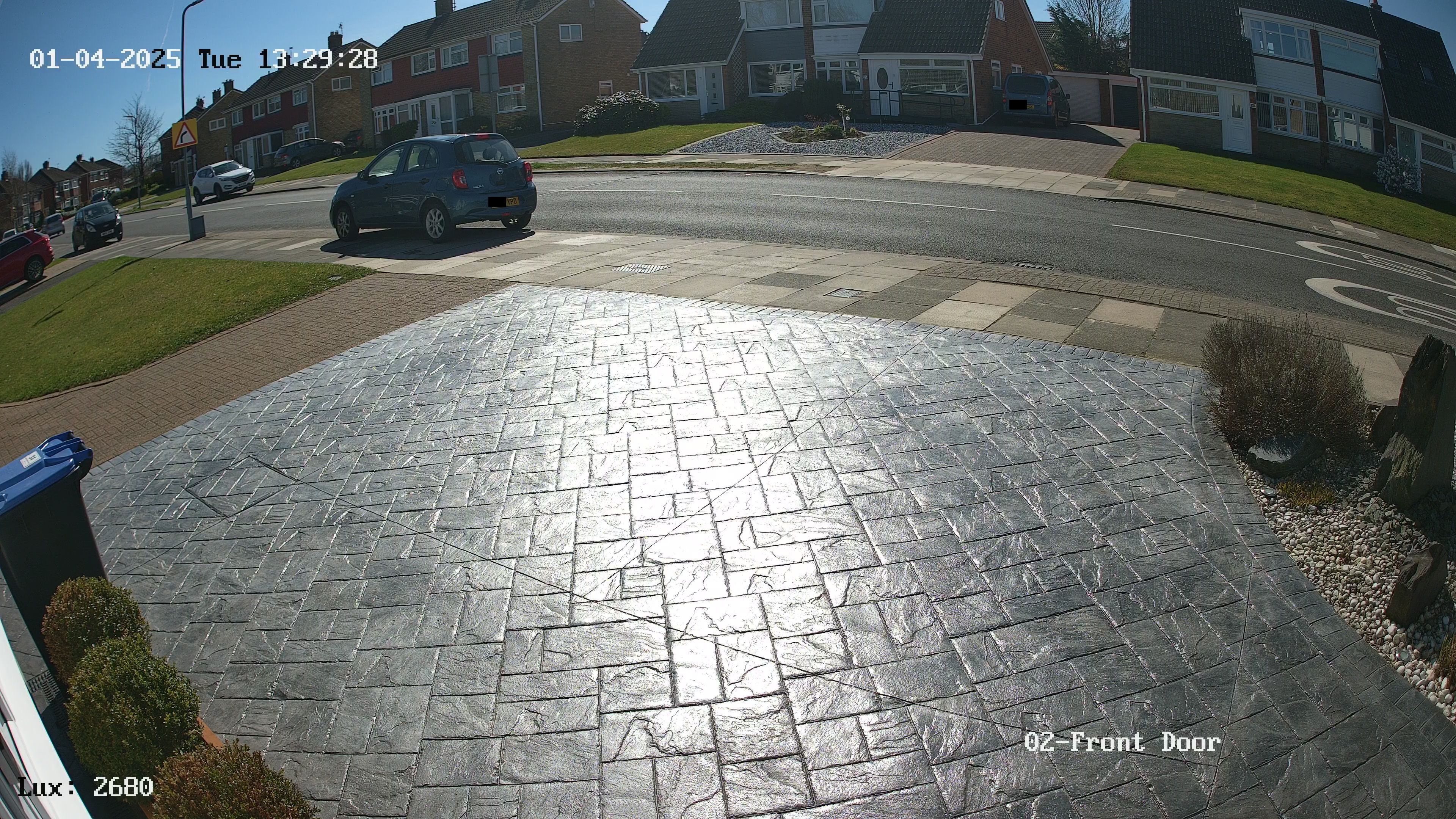

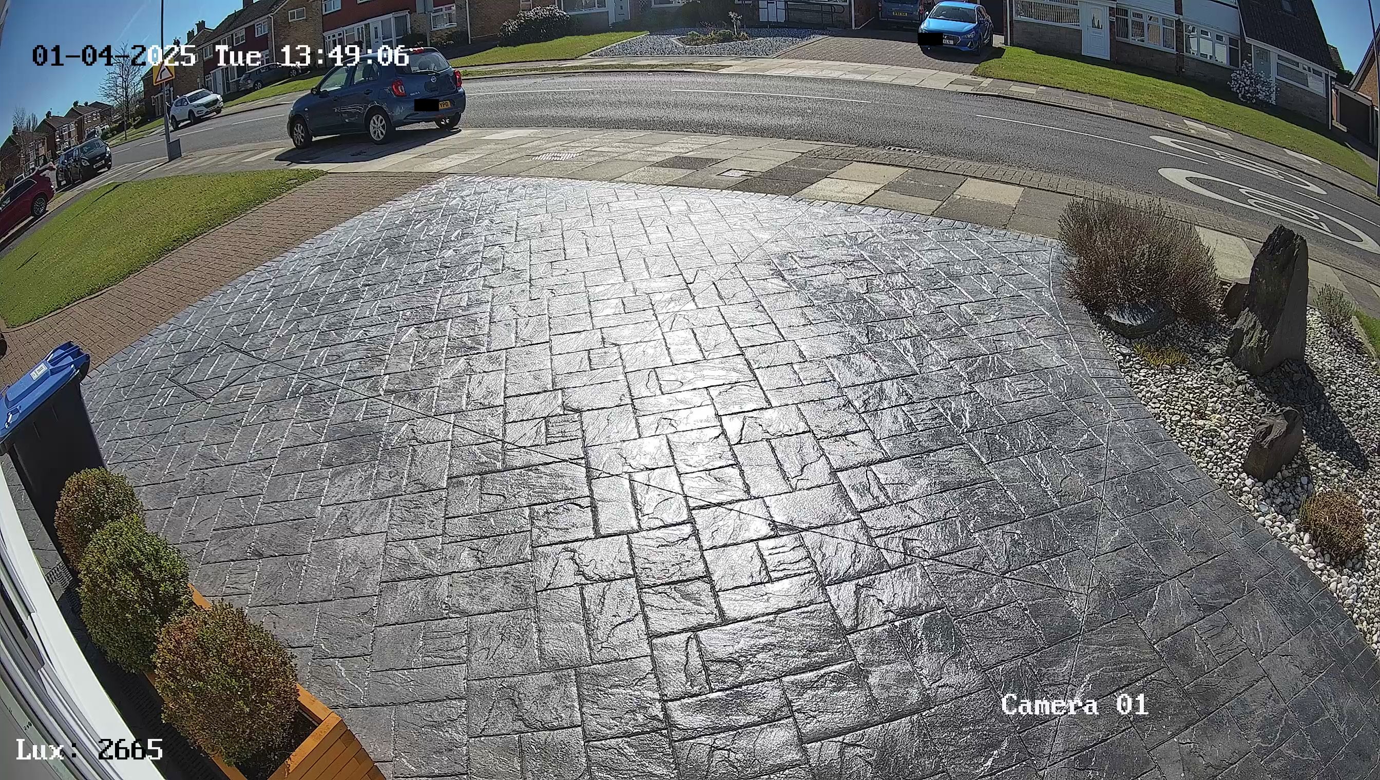

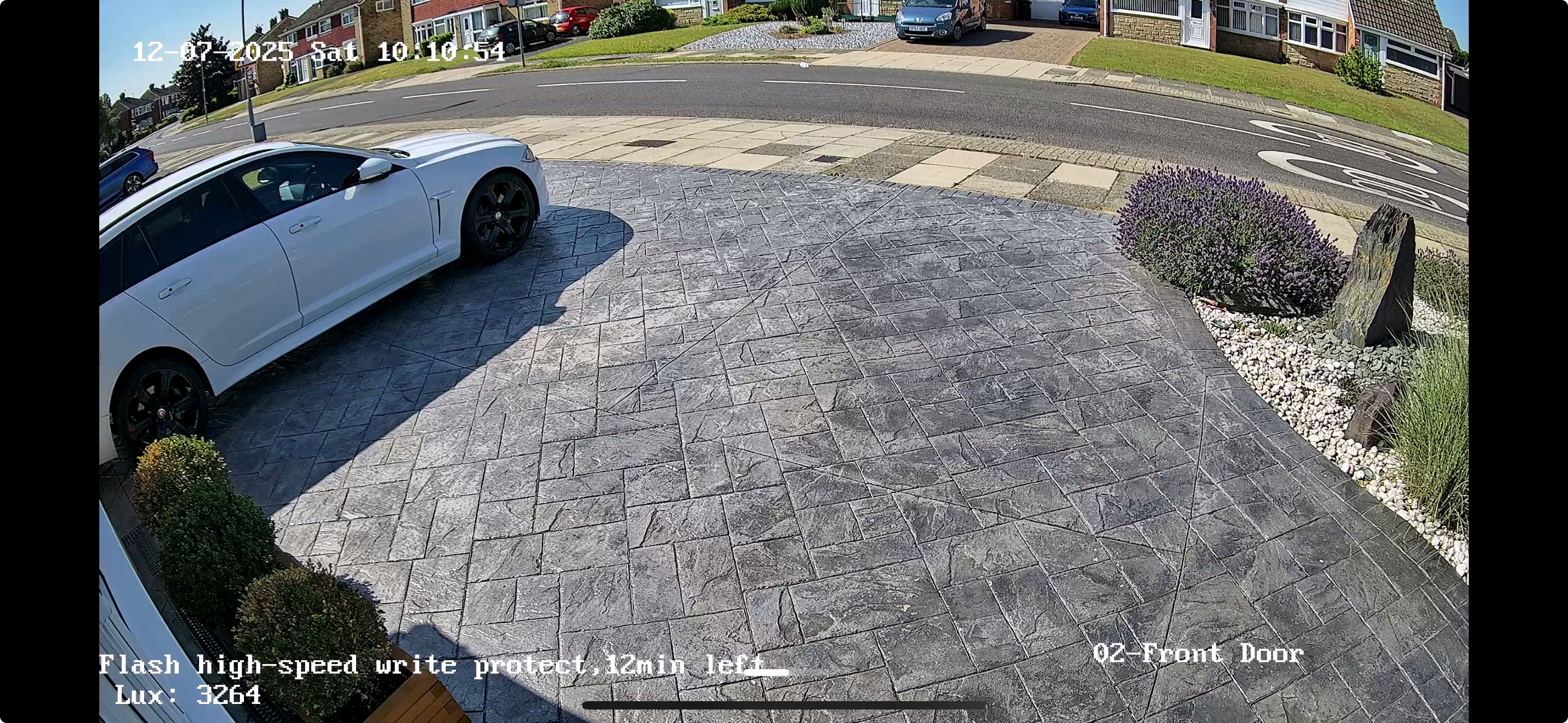

Daytime image - One camera has replaced a DS-2CD2387G2-LSU/SL (G5 Color only with 1/1.2" sensor). Obviously replacing an 8MP model it can no longer get a number plate in daylight due to the reduced resolution, but I'd say the colour rendition looks better and it is pin sharp by comparison; the older larger 2387 looking a little softer. Full resolution images of the outgoing 2387G2 and the incoming 2347G3 are below. I've not toyed with the settings on the new camera yet but the two images are a short time apart, roughly similar view and with a mere 15 lux illuminance difference (as shown in the lower left corners). Selecting the images and viewing actual size you can see that the last three characters of the numberplate are clearly visible on the 8MP camera but barely resolvable on the 4MP.
Old - DS-2CD2387G2-LSU/SL:
New - DS-2CD2347G3-LIS2UY-SL:

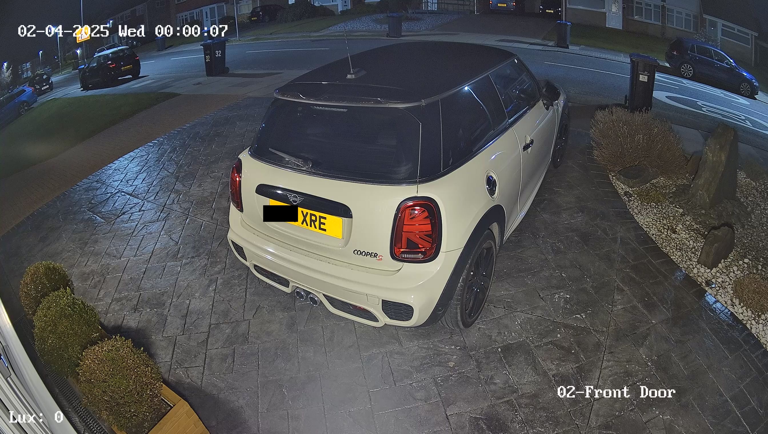

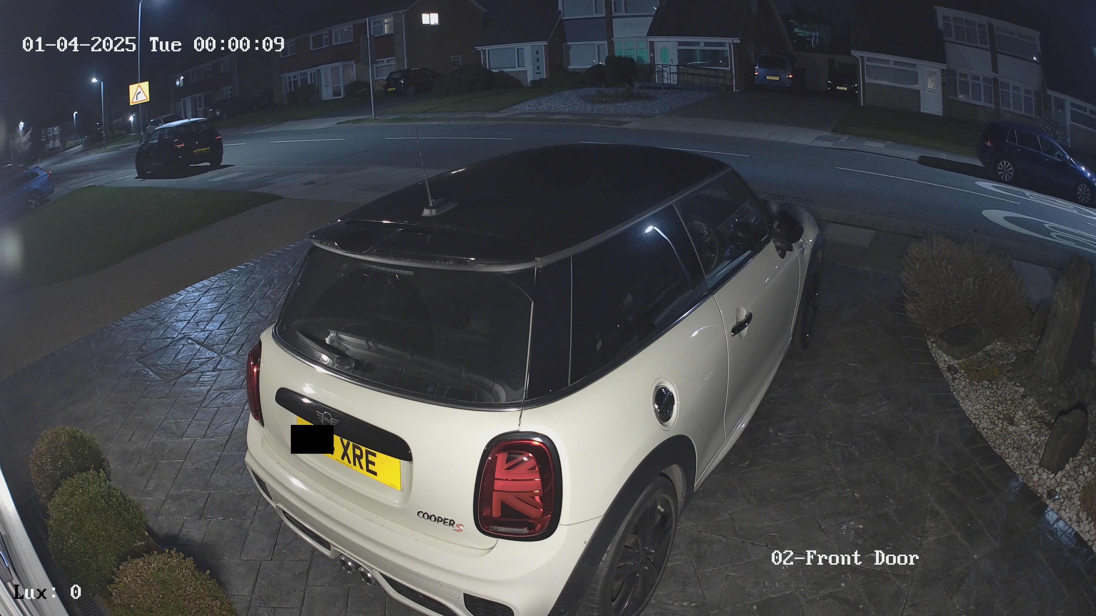

Nighttime Image - I have two 6W LED warm white lanterns at the front of the house. They are directly below (touching) the cameras. The two lights, although not the ideal 4000K, provide enough light to have the cameras remain in colour without using the integral LED in the camera at all. The images below show the old and new cameras at midnight, 24 hours apart. Keeping in mind that the newer camera is only 4 MP, again I think it's a crisper image. I do tend to set these cameras up to look a little dark, favouring a clear image with reduced motion blur over a bright image (24/7 colour is great but it's night and as long as colour information is available, the image doesn't need to look as though it's 12 noon). I set the new camera up with similar settings to the old; 1/50s shutter, gain around 30 and noise reduction at 50. I was quite perturbed that the visible noise in the new 4MP model with it's 1/1.8" sensor could not be dialled right down the way it could on the old 8MP with the larger 1/1.2" sensor. It's not a direct comparison, but as the G3 8MP version uses the same 1/1.8" sensor as the 4MP, I can only assume it will be worse. You can't see the noise when you view the below images at actual size, but if you zoom in further you can see the old camera image is cleaner. It doesn't affect normal viewing.

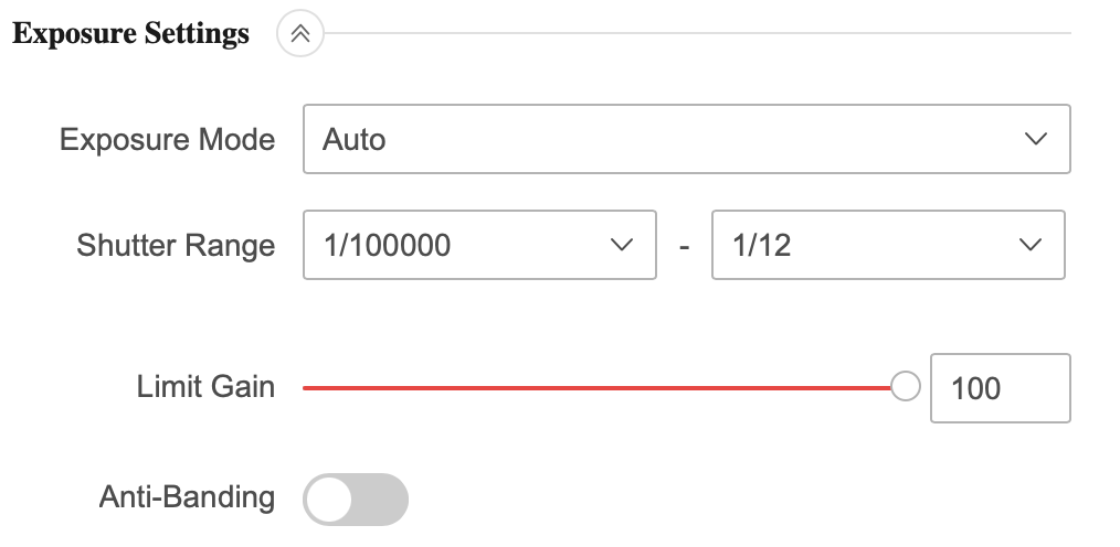

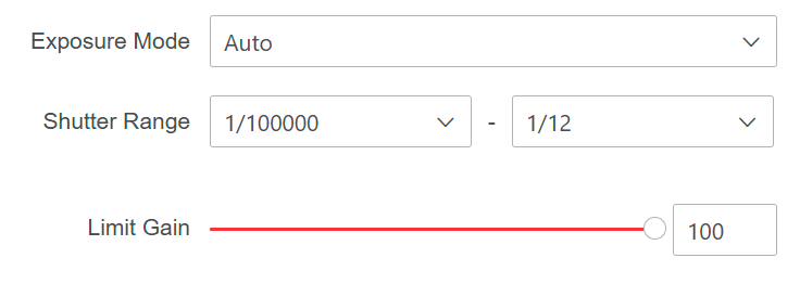

  • Exposure - It's nearly 2 years since I did a little review of the Hybrid Light models when they were introduced (G2H Review). While very happy with the image quality, I noted my annoyance that it wasn't possible to alter gain while the camera was in Auto mode; it was forced to 100%. Since then I've been using an illuminance sensor and a node-red flow to switch modes in order for that gain setting to be adjustable whereas @johnfitzy made a little app to switch the modes by sunrise/sunset with adjustable offset. The new exposure setup allows (for each mode) an upper and lower limit for exposure time rather than just a capped maximum, along with an upper limit for Gain. I'll likely still switch modes for greater control, but for those leaving it set to 'Auto' there's more adjustment (I guess this is more akin to how it's set up in Dahua models though I've never tried them personally)
The exposure time can be increased all the way to 1 second.

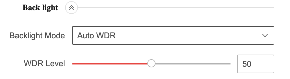

  • Backlight - A couple of changes. Previously WDR had an Auto and Manual setting; now they are separated into 'WDR' and 'Auto WDR'. I imagine the latter is the new AI WDR. It is factory default to 'Auto WDR' at level 50. I'll leave that as is for now. Usually I turn it off completely but I'm interested to try it here.

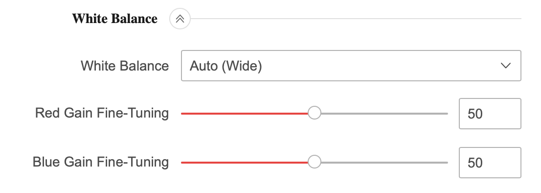

  • White Balance - More changes here. AWB1 and AWB2 are now 'Auto (Wide)' and 'Auto (Narrow)' with both having sliders available to fine tune Red and Blue gain if you feel they need tweaking.

Thanks for the running updates. Much appreciated! I guess the Image quality at night was expected to get worse with the smaller sensor in the 8MP model (despite the marketing spiel) .
The original 8MP 2387G2 had the 1/1.2" sensor while the 4MP 2347G2 had the smaller 1/1.8" sensor. The newer 8MP 2387G2H and the 4MP 2347G2H both share a 1/1.8" sensor as do the new G3 models. However there was a difference in alleged minimum illumination values.
The G2H lost out on the G2 due to its smaller sensor (0.0008 up from 0.0005). The G3 supposedly is back to the same 0.0005 value despite that smaller sensor. The 4MP G3 was supposed to drop from 0.0005 to 0.0001.
I'm surprised that the G2 8MP with 0.0005 is cleaner at similar settings to the G3 4MP with 0.0001. Even playing with the gain and noise reduction I can't get an image quite as clean. I'm not sure how the G3 8MP would do if I'd have used that instead.

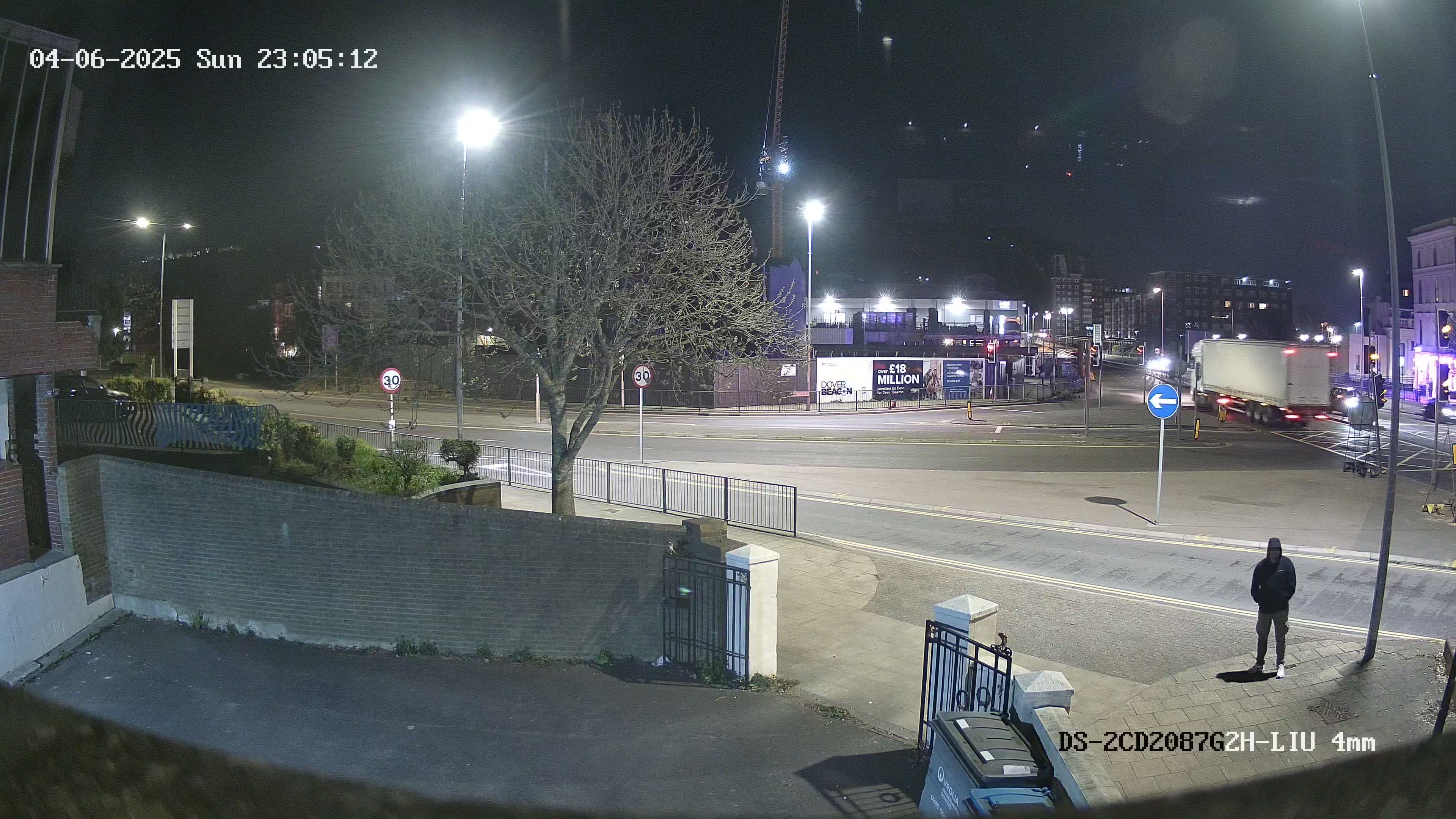

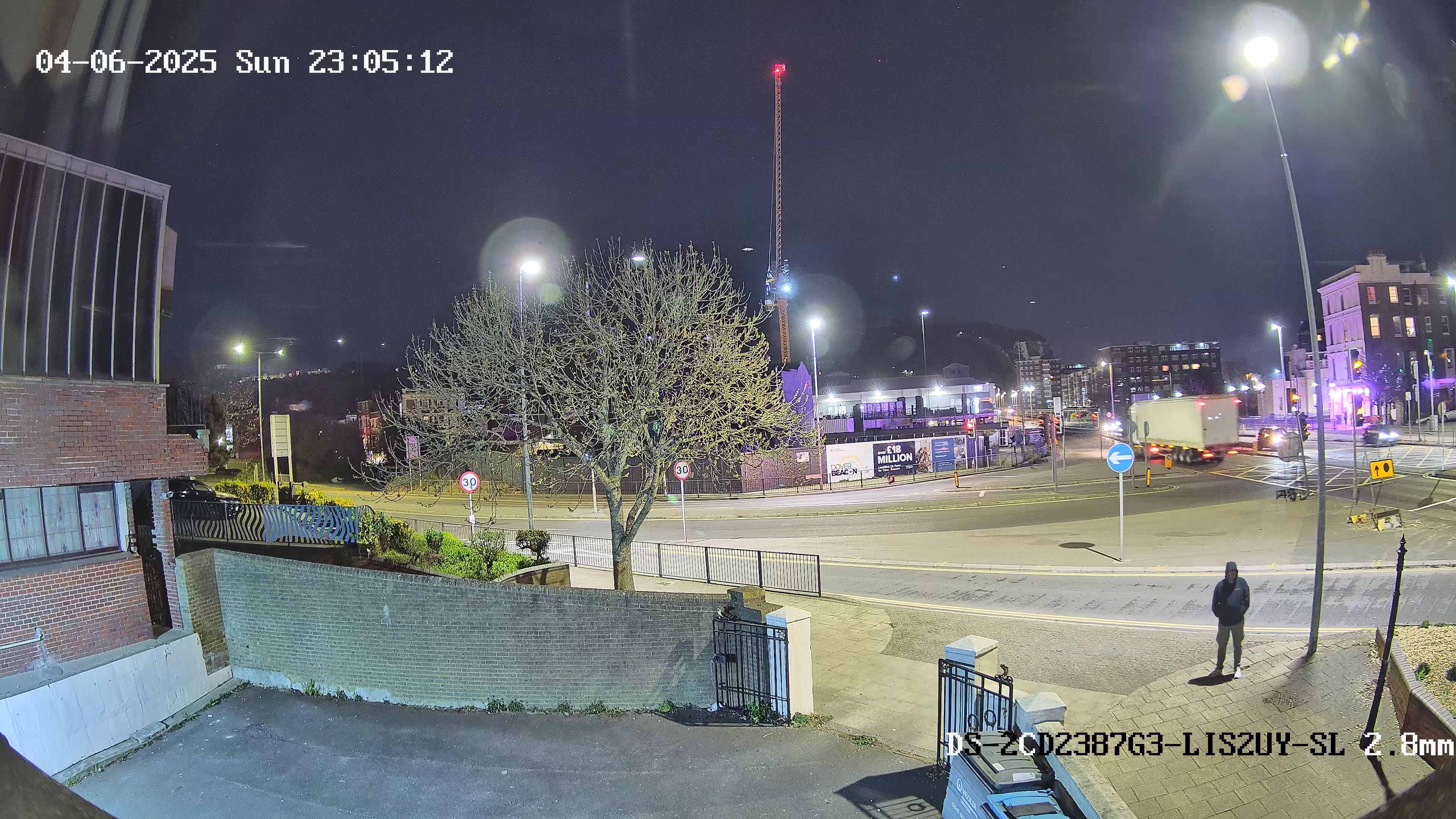

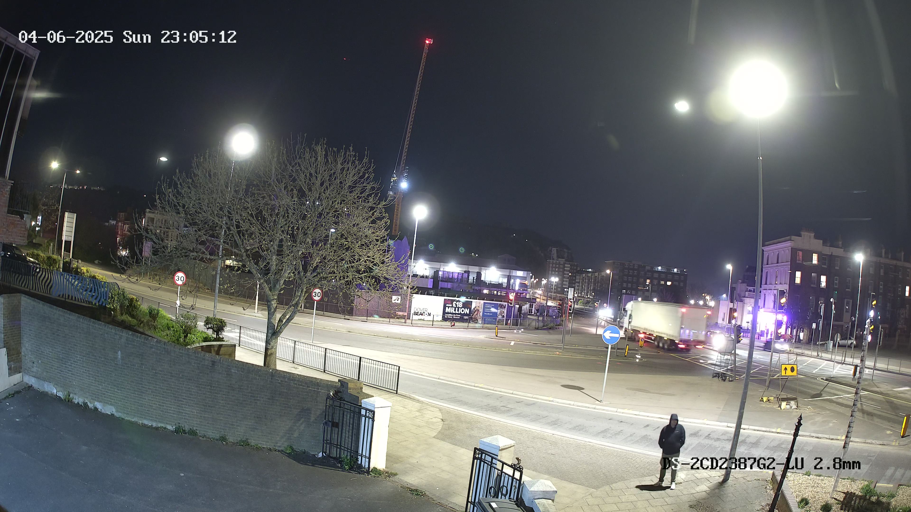

We set up a 2387G2 (2.8mm), 2087G2H (4mm) and 2387G3 (2.8mm) to record outside of the office over the weekend as a quick test.
Unfortunately, we didn't have a 2387G2H (2.8mm) here that we could use for the perfect comparison, but hopefully, the 4mm mini bullet still gives a decent idea of how the picture varies.
It's also worth noting that these were set up inside the office, looking through a window, so the views are not identical and the extra layer of glass will very likely be impacting picture quality.
All three cameras are using their default video and image settings, other than Video Quality, which was set to highest, with the built-in LED disabled.
As you can see, the G3 image is sharper and brighter all over, but most notably the road signs, tree and car park in the foreground:
Thanks Kyle, do you have short video comparisson by passing vehicle where you or someone else stand at? Im interested in blur reduction at 3.0
The G3 image has a lot more visible noise than the G2.
That's what I found. The old G2 a bit softer but practically noise free. The new G3 sharper but noisier.
