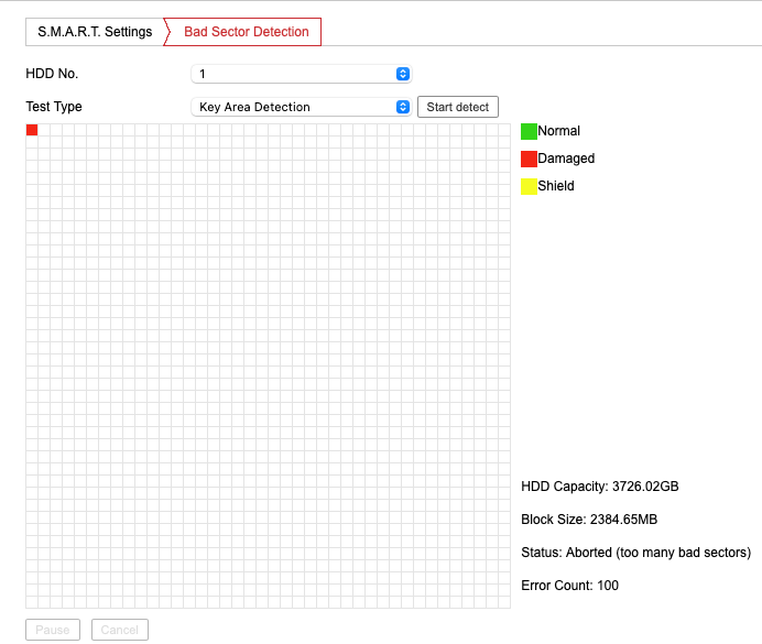

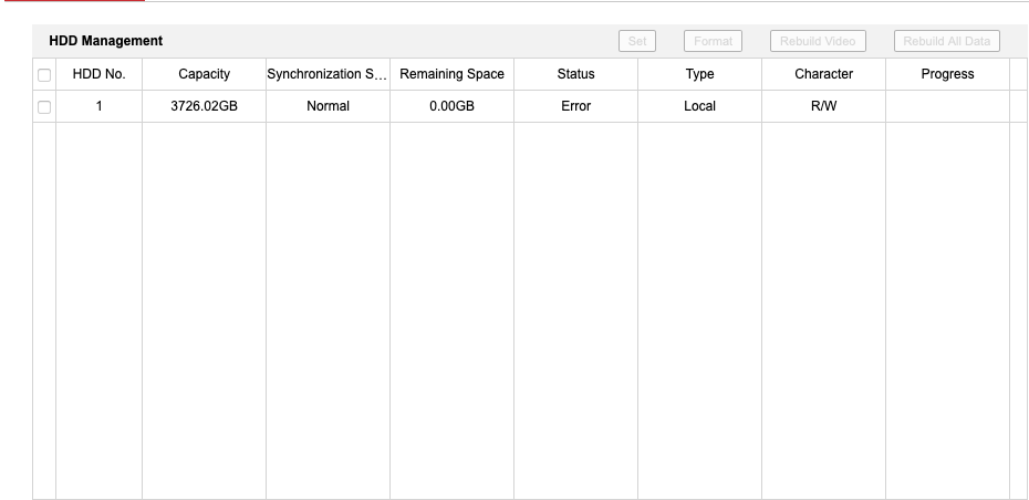

Hello everyone I think I already know the answer to this question lol but it's the first time so just after some advice from people who know.
I woke up this morning and the NVR was beeping DS-7604NXI-K1/4P(D) and when logging into Hik-Connect it had the red warning with HDD Exception and all recordings/playback not available but live stream was still working fine.
I have turned off/on the NVR and all seemed to be working fine and when checking NVR via web it was showing as good but when I ran the bad detection it finished all green but then started beeping again, redone the bad detection but this time it was encountering a red block on the first one.
Im guessing the HDD is knackered (4TB Seagate Skyhawk only 4 month old)
Is there anyway to still use the cameras live stream only but turn off that beeping noise? I cant find any where within the configuration to disable noises etc.

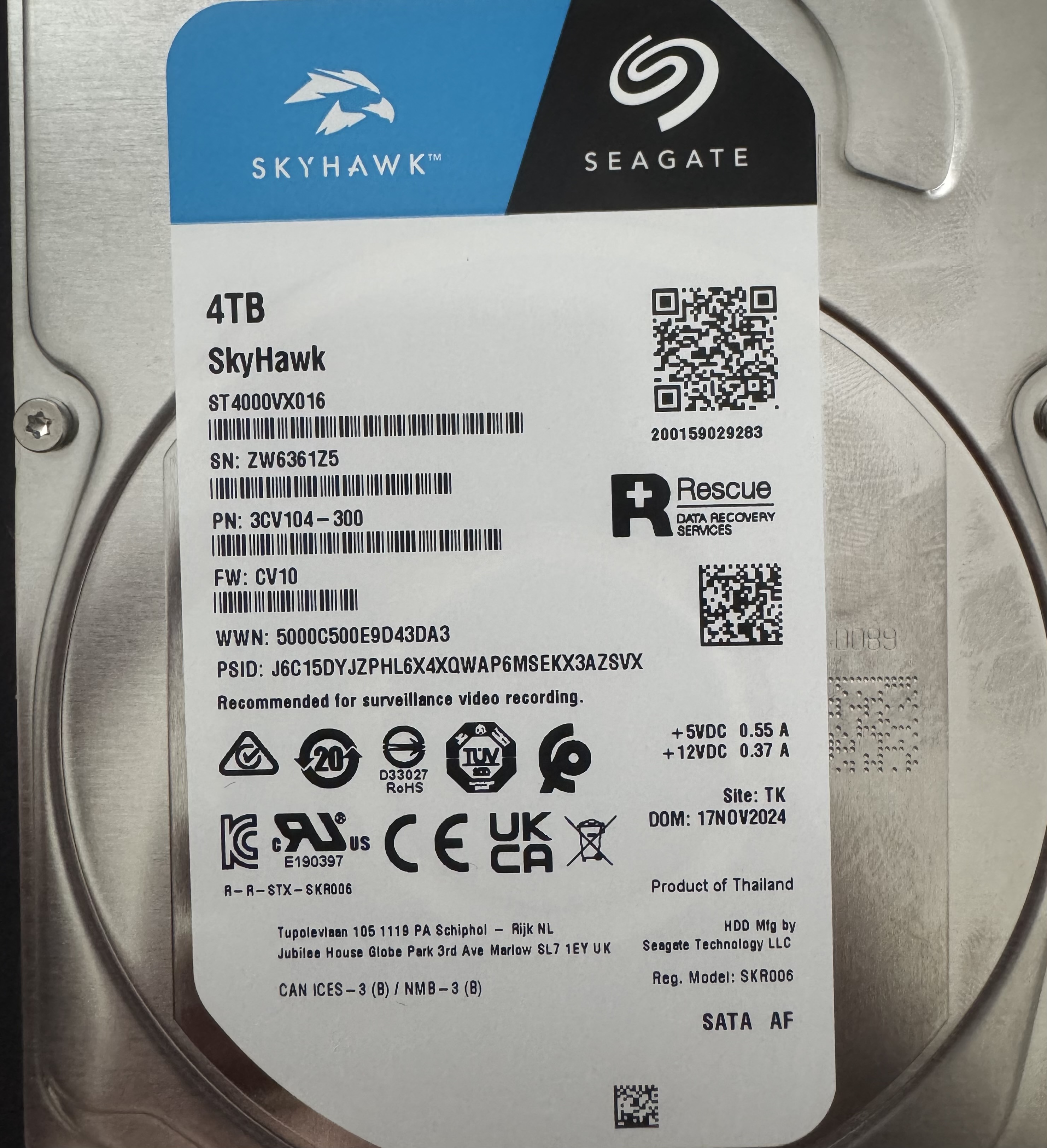

Thanks JB im gonna have a look now , do you still think the Skyhawks are the better HDD or would you recommend the WD Purple? Im guessing I just got unlucky with this, its from amazon so not sure if its not genuine to be honest lol
I generally use Skyhawks and I've used WD Purple a few times without issue. You probably just got unlucky, it happens. However as mentioned in another post somewhere, there are some Skyhawks that are not fully compatible (won't store VCA data) so check the part numbers against the Hikvision compatibility chart if you're buying from Amazon (I made the mistake at least once). Make sure it is NOT one of these:
ST4000VX005, ST2000VX012, ST4000HKVS001, ST8000VX002, ST8000VX008, ST6000VX010, ST6000VX011, ST4000VX013, ST3000VX016, ST3000VX017, ST2000VX015
I’ll check the one I bought against the site , this has been fine up until this point to be fair.

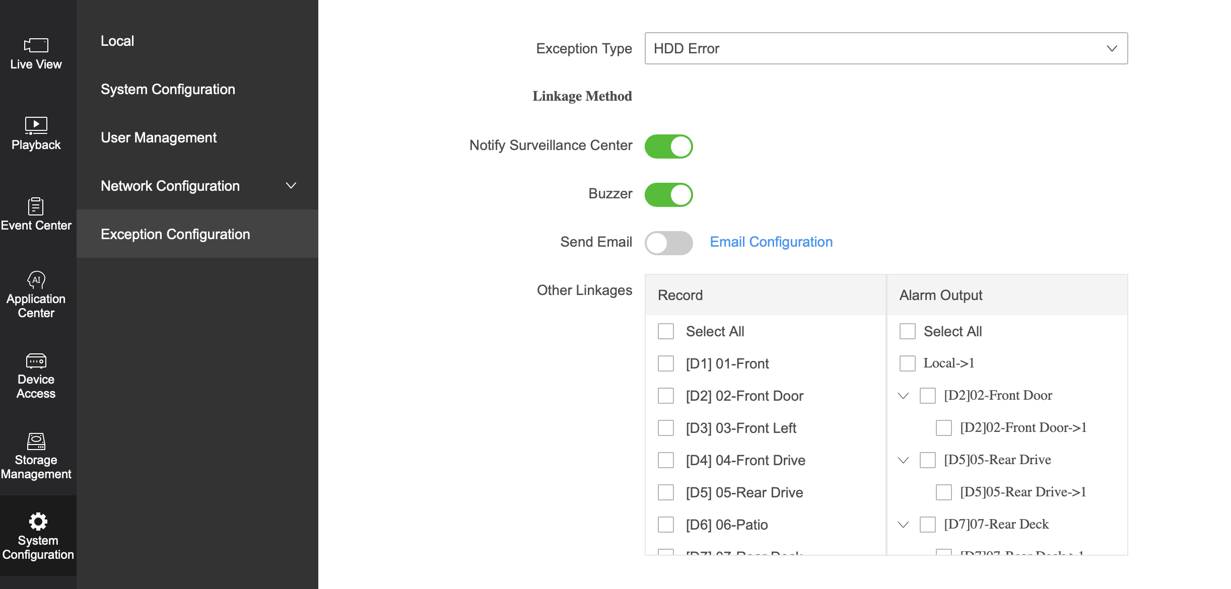

You might be able to find it in the 'Exception Configuration'. There you can turn off the buzzer for individual events. This is from my M but there will be something similar on the NXI:
I’ll take a look when I done it through TV mate but I’m almost certain there is no exception section on my virtual host , but I might be wrong
Well the good news is that it isn’t one of the ones you listed so just unlucky for me. Thanks for your help mate appreciate it.
