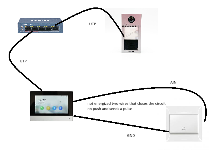

I Il_Picasso New Member Messages 2 Points 1 Feb 18, 2025 #1 Hi! I just boguht a doorbell with an indoorstation DS-KH6320-WTE1 , I have wired a button switch like this to the indoor station I want to be able to trigger the doorbell by pressing that button, is that possible?
trempa92 Gives a lot of help Trusted Member Messages 343 Points 43 Feb 19, 2025 #2 Yes, connect any AIN from 1 to 8 and GND Then define that Alarm input to be doorbell.
I Il_Picasso New Member Messages 2 Points 1 Feb 19, 2025 Thread starter #3 trempa92 said: Yes, connect any AIN from 1 to 8 and GND Then define that Alarm input to be doorbell. Click to expand... I saw that, but do I need it to deliver any kind of energy? I tried the next with no success Attachments DIAGRAMA.png 100.8 KB · Views: 84
trempa92 Gives a lot of help Trusted Member Messages 343 Points 43 Feb 20, 2025 #4 No power needed, you can actually short circuit them and you should hear ding dong
