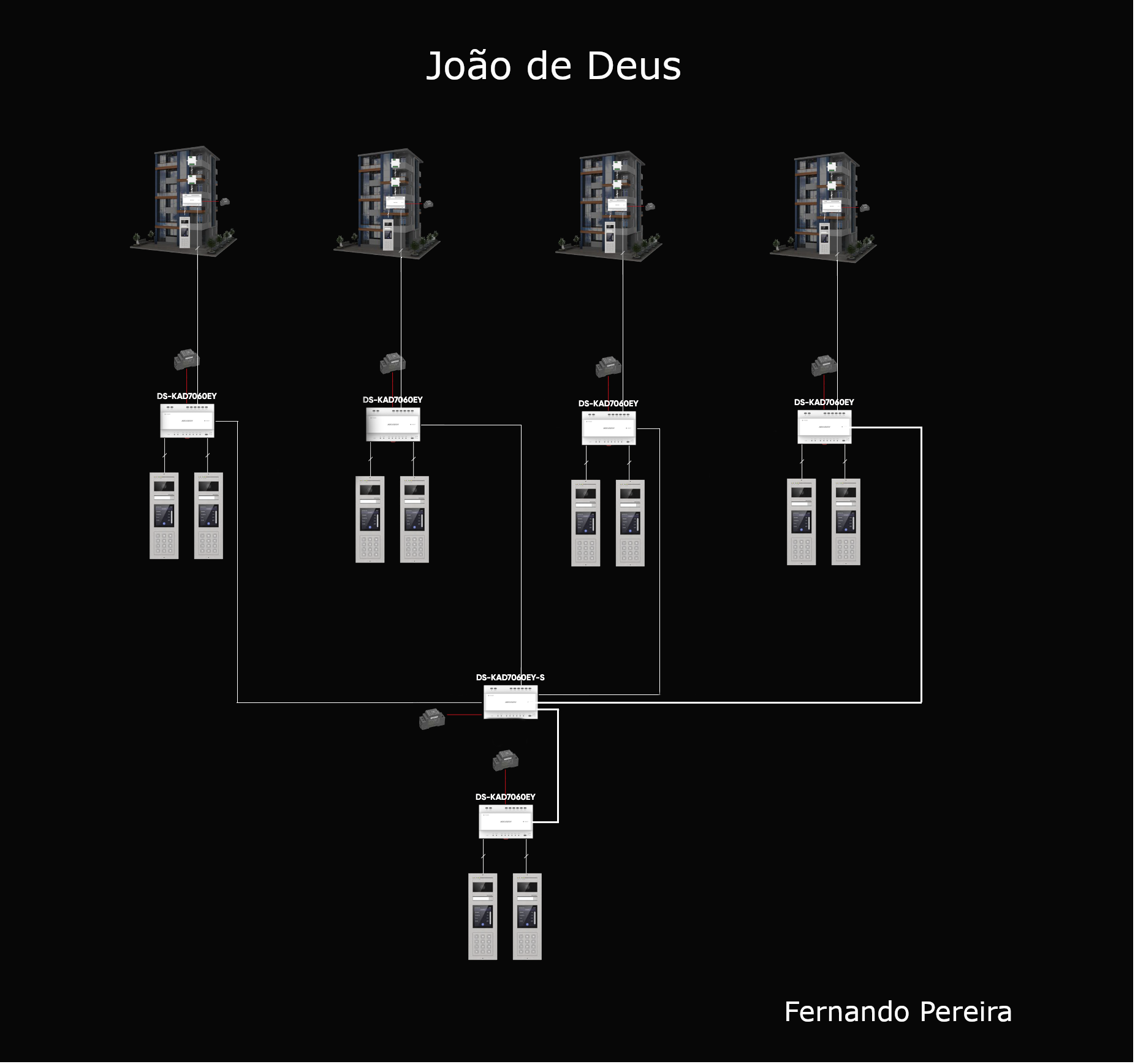

Hello everyone,
I need some help configuring a Hikvision IP video intercom system (DS-KD series) for a residential complex, and I want to make sure the network logic and device configuration are set correctly.
Here’s the situation:
  • There are 4 buildings (blocks) in total.
  • Each block has 3 entrances, each with a DS-KD7003/04/06EY main unit and 2 sub modules (button panels).
  • There are also 2 external entrances at the street level, which should call all apartments in all 4 buildings.
  • In total, there are 69 apartments across the 4 blocks.
What I need:
  • Each block’s 3 entrances should only call the apartments within that same block.
  • The 2 external (street) entrances should be able to call any apartment in any building.
  • All devices are networked via DS-KAD706Y-S PoE switches in a star topology.
  • Each apartment has indoor monitors (Hikvision IP monitors).
Questions:
  1. How should I configure the Main Door Station vs Sub Door Station roles for each entrance?
  2. Should each block have its own “main door station” defined with a separate building number, and the two external ones configured as “global door stations”?
  3. How should I set the Building No., Unit No., and Room No. so that calls from each entrance go only to the correct block’s monitors?
  4. Is it possible to configure the two external entrances to call all apartments (broadcast call) while the local entrances remain limited to their block only?
  5. Any advice on recommended IP addressing and linking between door stations (via “Linked Network” or “Main Door Station IP”)?
Any example configurations, screenshots, or best practices for similar multi-building setups would be really appreciated.
