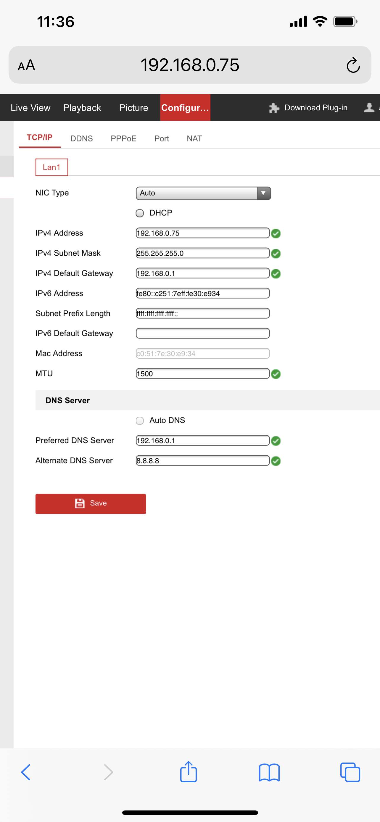

As suggested in older topics on this forum, I have checked the tcpip settings, platform settings and they look fine as I can ping the Hik connect server.

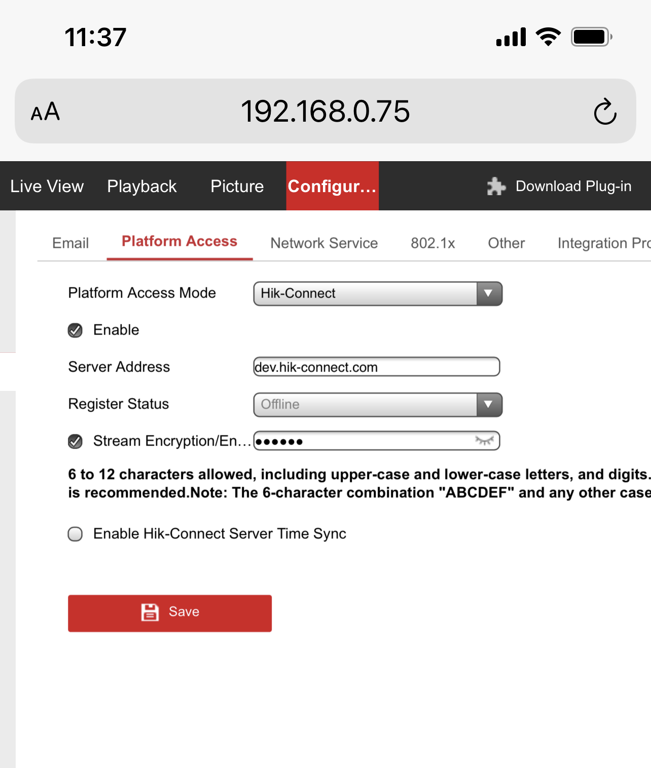

I attach screen shots of the network settings and rebooted everything but it’s still showing offline so can someone please help.
thanks
Hi
please ignore this thread as I’ve got it working.
I enabled DHCP and then disabled it again to use a static ip and enabled NAT/UPnP and set Port Mapping to Auto.
All working.
