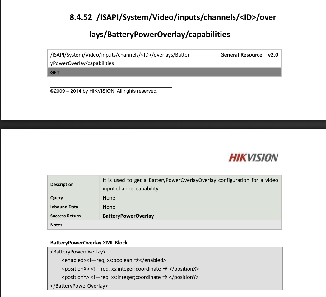

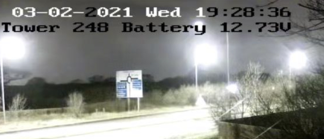

so I came across an osd in hik-connect on a hik camera that used ISAPI (little to no knowledge on this) to overlay the battery voltage onto the OSD.
this would be super useful and after a lot of head banging I found this document that explains briefly how this is done at section 8.4.52:
ISAPI page: 8.4.52
what I need to know is how do I actually implement this? I have spent days on google and this forum trying to find answers but got nowhere?!
there must be an expert here who can teach me specifically how to do this and not just hit me with wrong answers?
oh and for those about to ask... yes the voltage is live and yes I have seen it change...

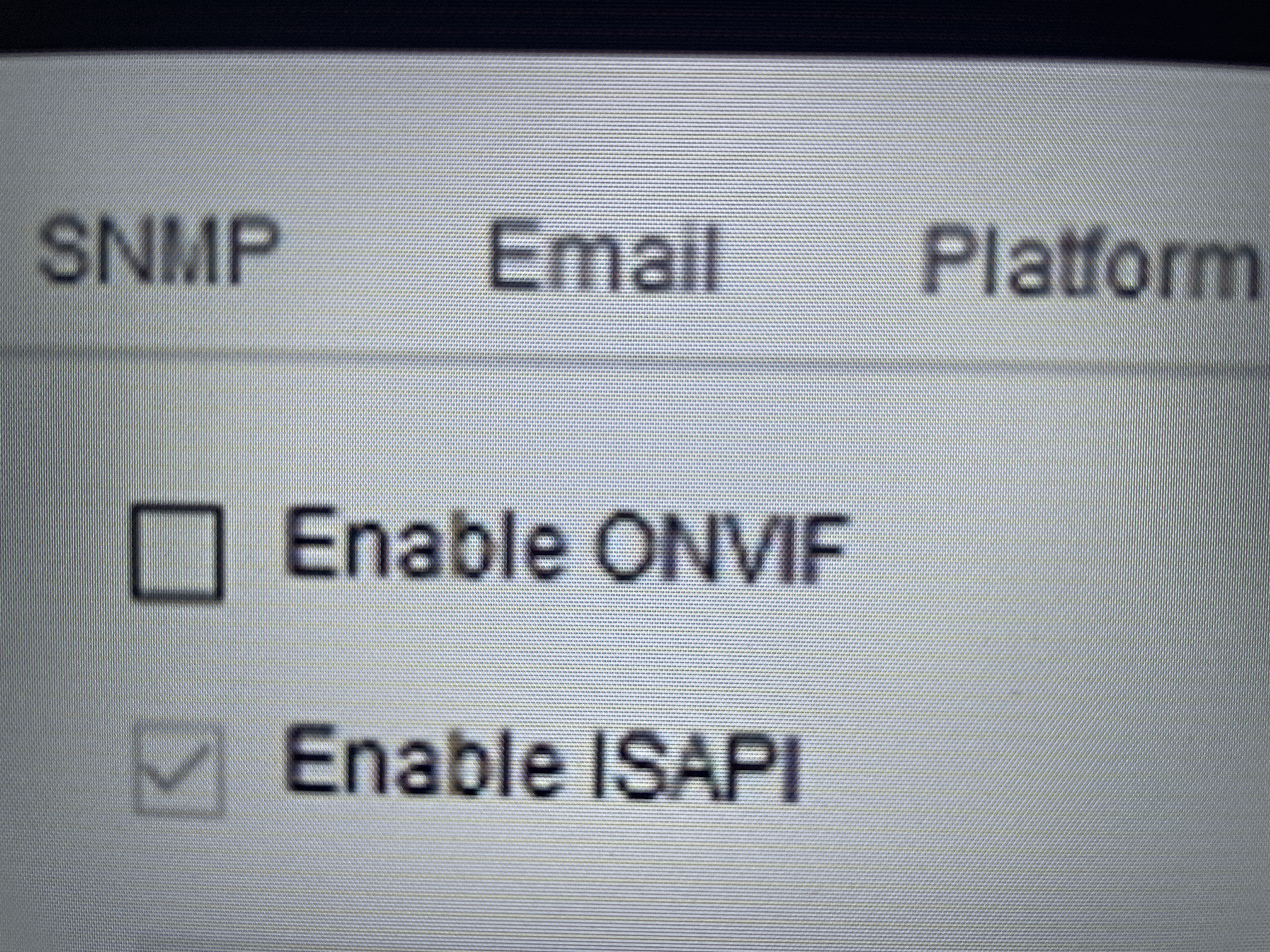

Also don't forget that you may have to enable the ISAPI interface on the NVR or cameras beforehand, it may be disabled by default.

Probably ISAPI interface is disabled on the camera. Go into the admin pages and find the setting and enable it. Probably in advanced network settings but not sure.
Also remove the > from your URL, sorry, my original post had a typo (now corrected).

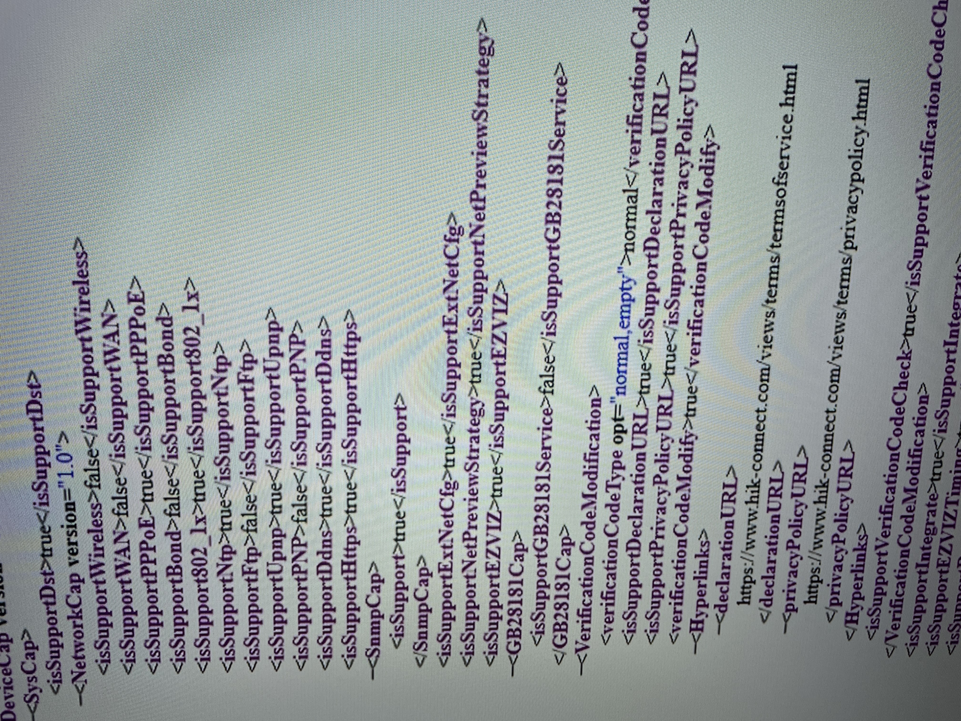

Ok so checked and isapi has a tick in the box but is greyed out? That being said if I run
/ISAPI/system/capabilities I do get a loaded xml displayed?

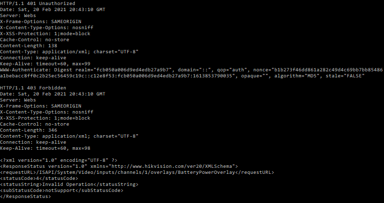

I really appreciate all your help but i am having no luck at all, with your last command this is the result i got:
Try entering the username and password in the http string, like http://username:password@....
