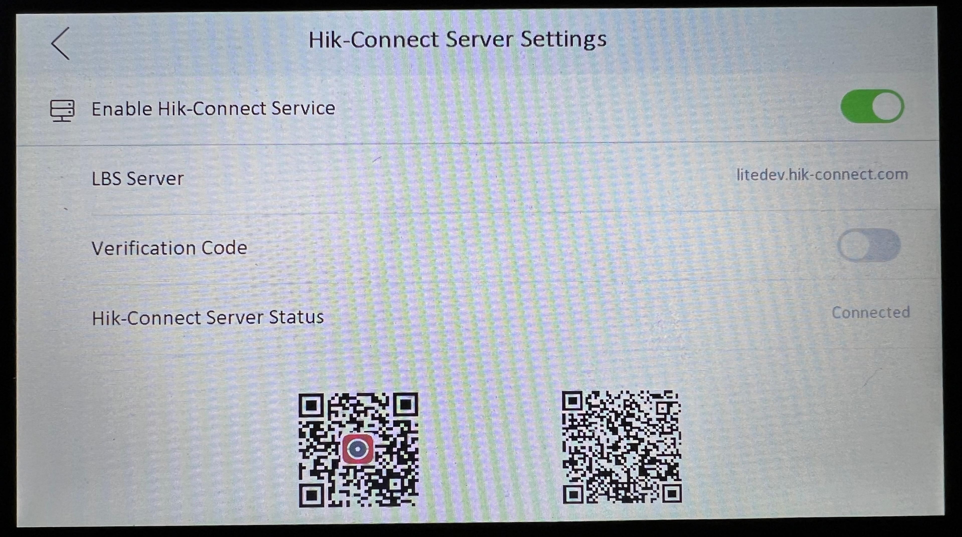

I'm trying to set up a video gate phone using a newly purchased indoor station (a DS-KV6113-WPE1(B) ) and gate station ( a DS-KH6320-WTE1).
I can't add the DS-KV6113-WPE1(B) to my HIK-Connect account. I'm asked for a verification code which I don't seem to have. I've done some digging and as a result have tried the following:
there's no verification code on the sticker on the back
I've tried 888999, ABCDEF and 123456 and a blank verification code.
I can't get into the unit via its IP address in a web browser - the connection is refused
I can't get in via ssh or telnet - the connection is refused
The HIK-Connect service settings screen is as attached. Toggling the verification code switch on and off doesn't seem to do anything.
The IP address responds to a ping. On the unit itself I can see that it's running firmware version V2.1.34 build 211118. I can see the gate station and view its video so am reasonably confident the networking is OK.
Any advice appreciated!

I think the problem's been solved. I was using iVMS on a Mac - I borrowed a Windows laptop and installed the latest version of iVMS and it sees the indoor station and allowed me to upgrade the firmware. That new firmware has a significantly more extensive menu and one option is to set a verification code!
All is up and working now; I’m grateful for all the replies.
