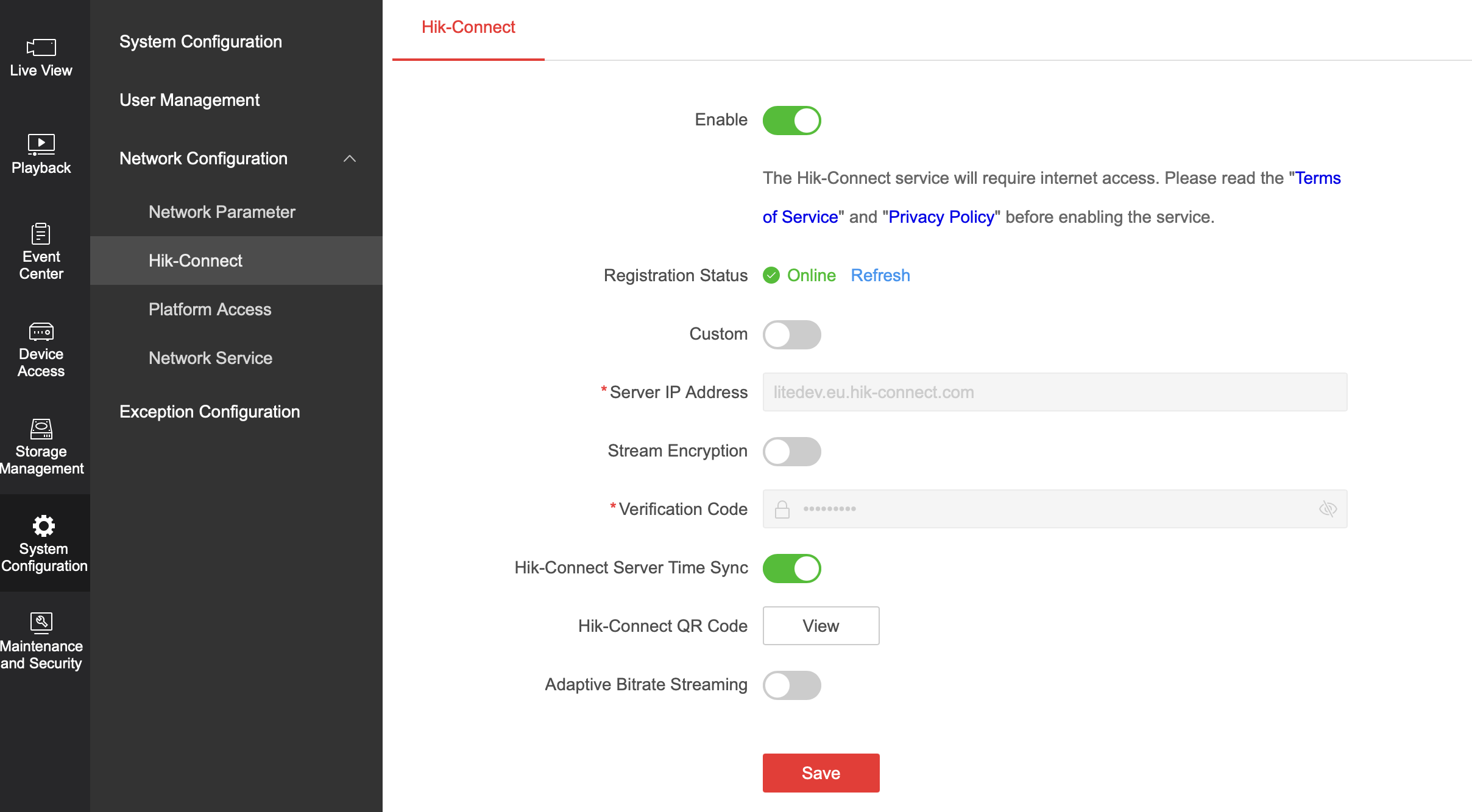

It'll be 'sub stream adaptive bit rate' setting. It's on by default and needs unchecking (probably in platform access). I've had that kick in on several models with a perfect network connection.
Edit: Renamed 'Adaptive bit rate streaming' on the newer GUI 5 and theres now a separate page for Hik-Connect:

WOW... that's what that's for... worked like a charm... Thanks!!!

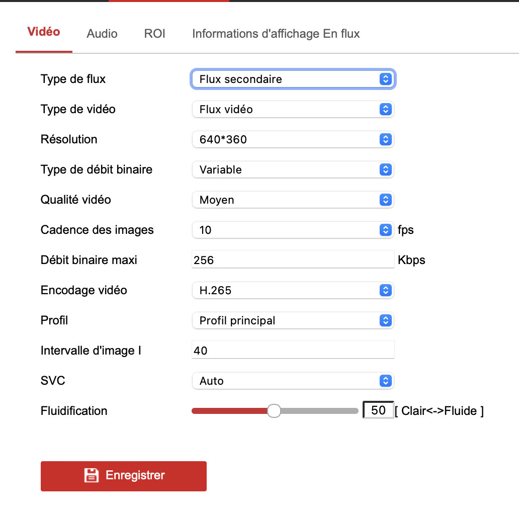

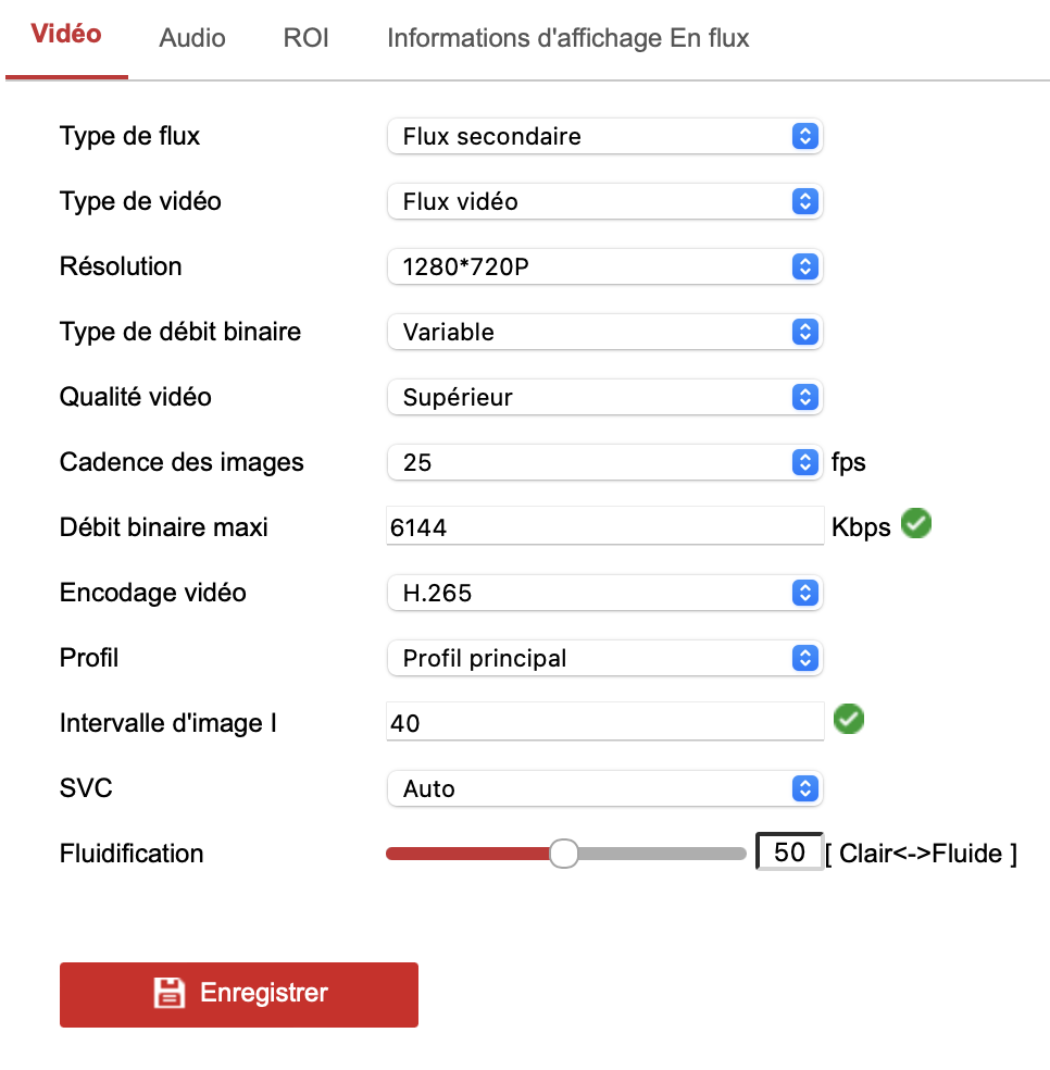

I am having the same issue with a DS-2CD2386G2-IU camera with latest Firmware (V5.7.15 build 240201). Everytime HIK-Connect is loading the SD stream, all the sub-stream settings in the camera are changed to lower definition ....
Before:
After:
When going to platform settings, there is no such settings named "Adaptive bit rate streaming".
I am not using any NVR for this camera.
Does anyone has an idea where I should look? I am using the web-browser and not IVMS.
Thank you!

Try disabling SVC (Scalable Video Codec)
unfortunately this did not helped
As there's no specific setting in the camera configuration that enables Hik-Connect altering the stream settings, I could only suggest looking in the Hik-Connect settings for that camera. From the Home page of the app, click the ... menu to the right of the camera name then click Settings. Maybe there's something there. I only have NVRs not directly connected cameras in Hik-Connect so can't check to see what's in that menu but I know that the options in the Settings menu vary by device type.

I already had a look to HIK-Connect too but there is also no such setting or any settings relating to stream quality available there.
Looks like there is no solution :-(
