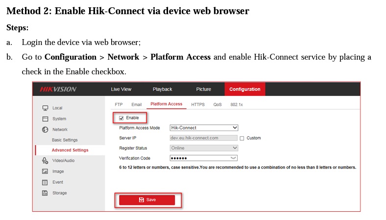

In a web browser:
Use the device’s local IP and admin credenials combination to log in to it in a web browser.
Then, go to:
Configuration Network Advanced Settings Platform Access
On this page, select Hik-Connect from the Platform Access Mode dropdown and tick Enable.
Don’t worry too much about the Server Address field, the default entry here is usually fine.

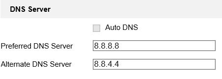

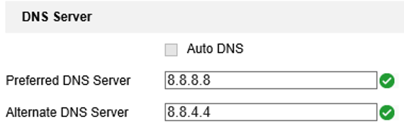

Make sure that the DNS servers are set correctly and then reboot the NVR, which may then enter the right server address for you automatically:
Connect to your device on a web browser and go to:
Configuration Network Basic Settings TCP/IP
You need to make sure that you have valid DNS servers set up for DDNS to work. Google’s 8.8.8.8 (Preferred DNS) and 8.8.4.4 (Alternate DNS) servers should work fine, but this list has a list of other free DNS servers that will work well.

DNS looks correct. I reboot the NVR and it is still blank.
Kinda at a loss. Do you know what the default address is? Maybe I will try litedev.hik-connect.com.
