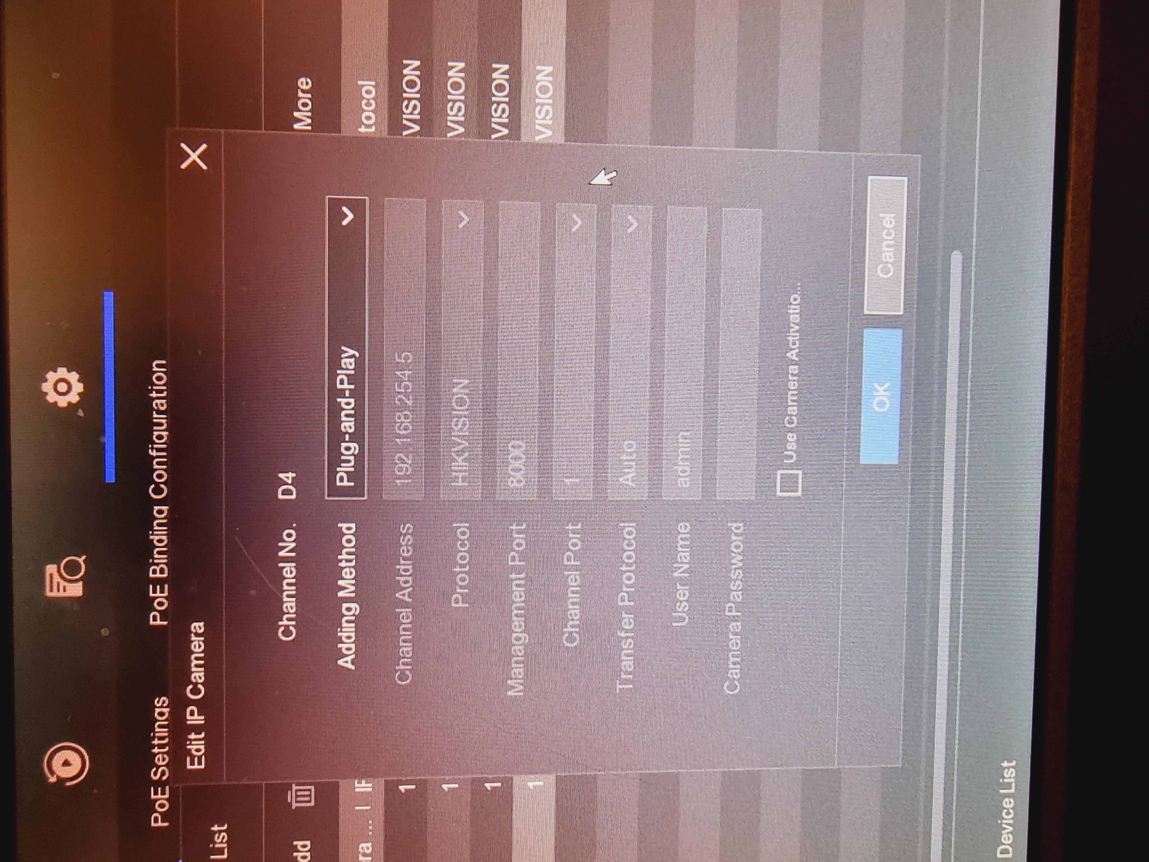

There is no option to sync the time on the camera settings

So starting with that there's no option for the IP camera time sync. It's not a problem - mine are configured manually so I guess it's done automatically without an option when using plug and play.
