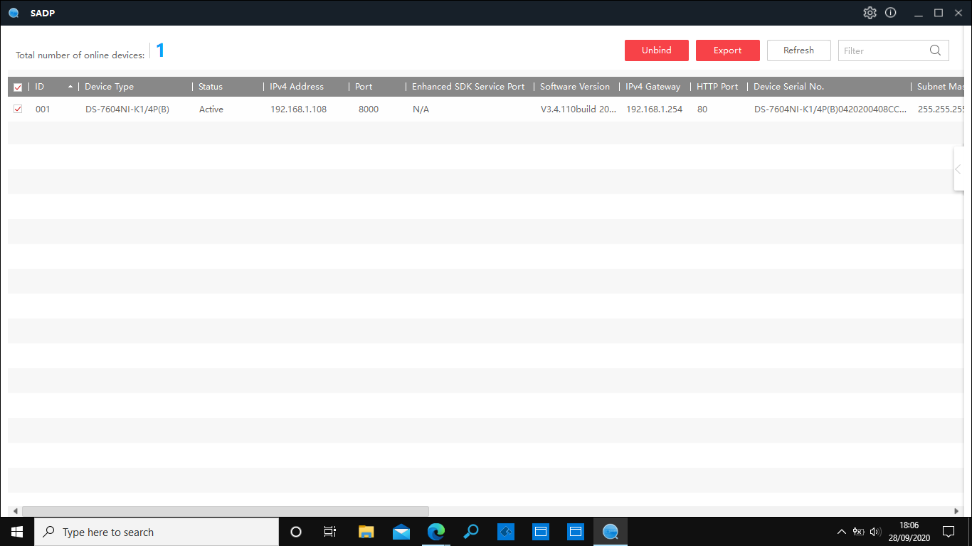

If so, can you please run SADP on a PC on the same network and upload a screenshot of the table it produces.
I’ve made it worse now all cameras are showing not linking! Here is a screen shot.
