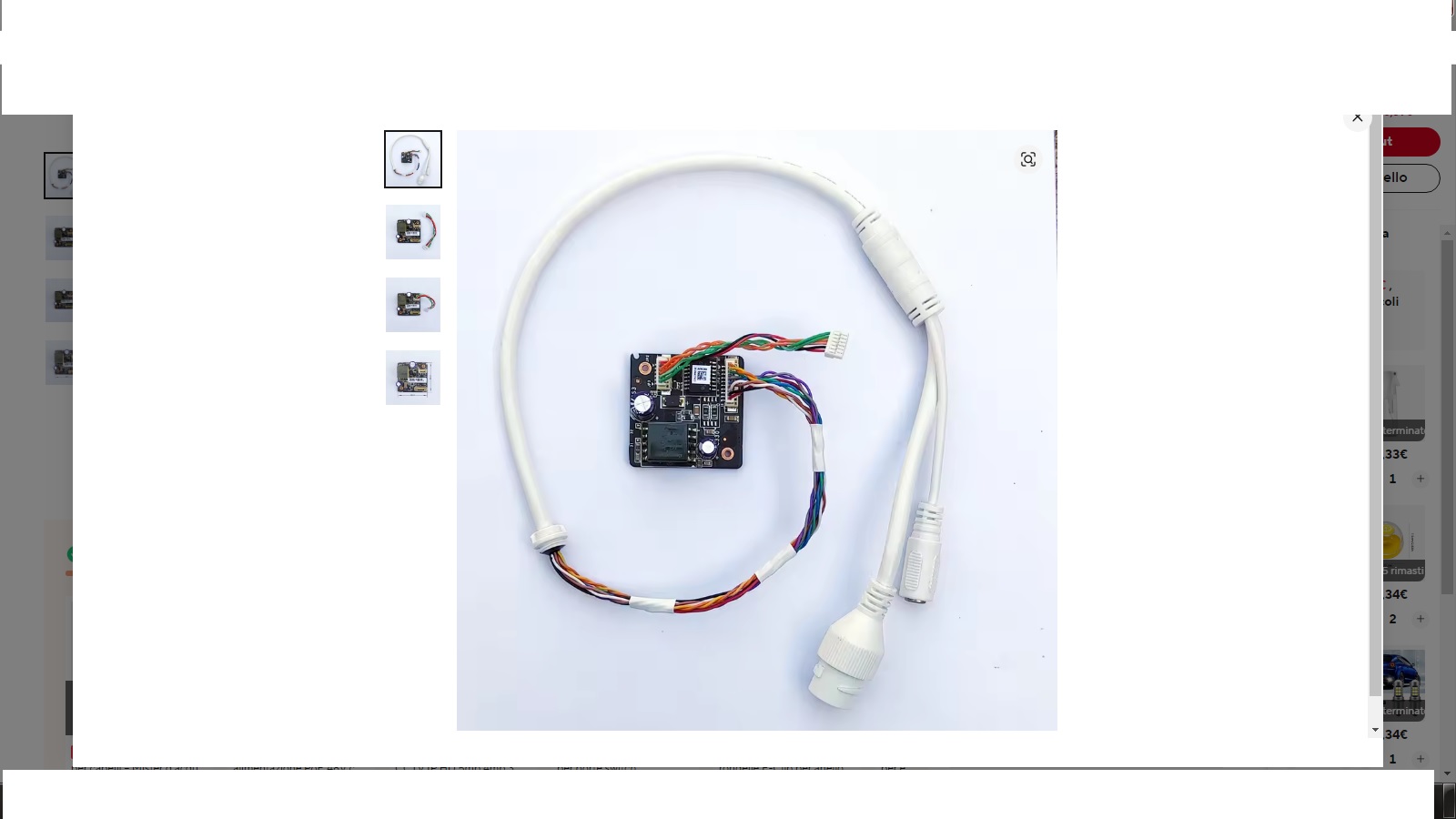

this?
No. I’m referring to where the two individual cables split/become one. I saw a post showing that there’s a tiny circuit board within that casing that converts the PoE voltage down to 12V DC. I’ve not seen it myself and I’m not about to butcher a working camera to show it.

ah ok I understand, I was thinking of disassembling and replacing that module

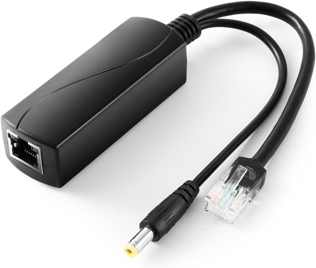

or I buy a splitter like this
