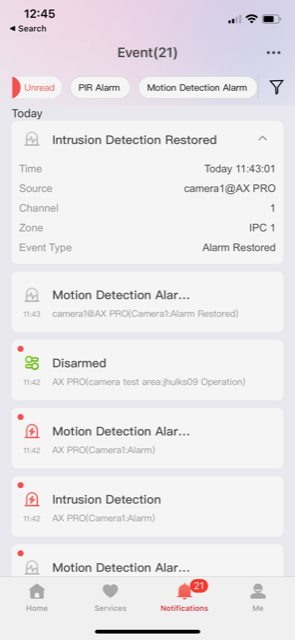

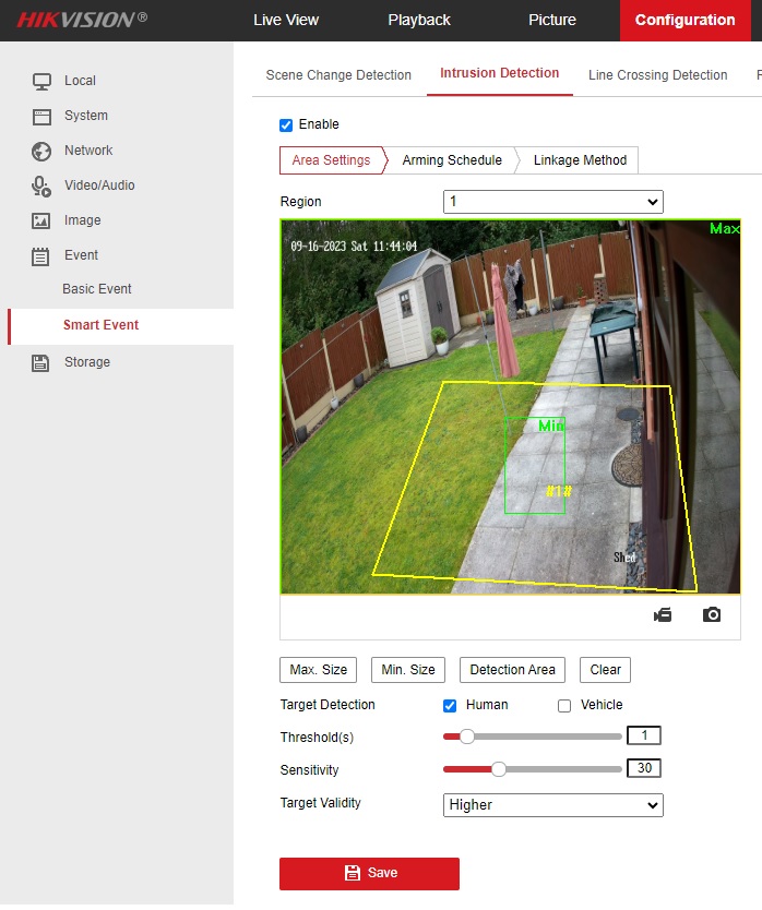

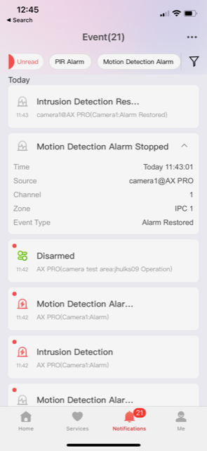

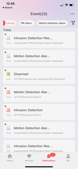

@Kyle Unfortunately, I had no joy. I had several "Motion Detection" alarms last night: one was triggered by a neighbour's floodlight, one by a squirrel, and another by a bird in my garden.
I've attached an image showing the intrusion settings and another image displaying the 'Motion Detection' Alarm.
Just to note, the camera's events show nothing for the three alarms that were triggered last night, I can only see the 3 "motion detection" alarm's occurred through the main notification button.
I'm just wondering if it's an issue with the camera settings or if it's a bug with the AX Pro alarm system

Thanks, I did have the Basic Event > Motion Detection > Enable Motion Detection and Enable Dynamic Analysis for Motions options ticked, I have deselected both of those options and updated the NVR to V4.63.020 build 230808
I'll give it a go tonight and update
Good morning, @Kyle! It seems like the solution you provided has resolved the issue. I'll be conducting additional tests and will provide an update to confirm its effectiveness.

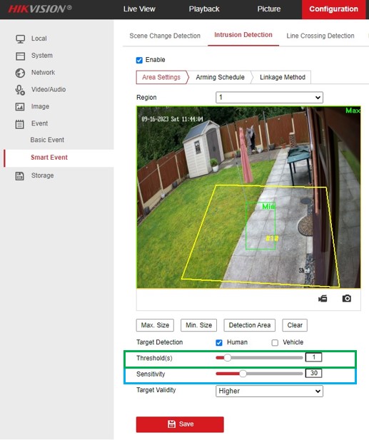

Also, thought i would point out [for awareness & for others] how the Sensitivity & Threshold parameters work.
In your picture the Sensitivity value is 30 & Threshold is at 1.
When an Object is detected moving toward the detection area, a Green Box surrounds the Object.
The Green Box needs to be Larger than your "Minimum" size & Smaller than your "Maximum" size indicated for object to be valid.
Now the Sensitivity Scale is directly proportional the Green Box [Object], where the Green Box is Equal to 100 on the Sensitivity Scale.
You have set the Scale to "30", therefore to Trigger an Event "70%" of the Green Box [Object], Must Cross Over Inside the Detection Area, thus the Remaining "30%" of the Green Box/Object [70+30=100] is equal to the Scale Setting does not need to cross over & therefore is a Low Sensitivity.
The Opposite of this, for example, the Scale is set to 90, then only 10% of the Object/Green Box needs to cross over inside the Detection Area to trigger the event, hence High Sensitivity
"Threshold" ............... we have a Scale of 1-10, but of exactly what we have 1-10 of .......... I can't be sure, we can only speculate.
For all intentions, lets assume the Scale is 1-10 seconds & you have your Threshold set to "1 Second"
Including the Threshold to the above Sensitivity equasion ...........................
70% of the Green Box must Cross Over Inside the Detection Area & Remain Inside for a Minimum of 1 Second ................. For an Event to Trigger [Record & therefore notify you]
With this in mind, is it plausible to assume that 70% of the Fox may not have entered & remained within the Detection Area for presumably 1x Second?
Could this be the reason the event went undetected?
